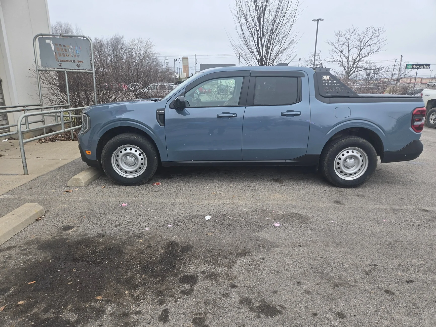

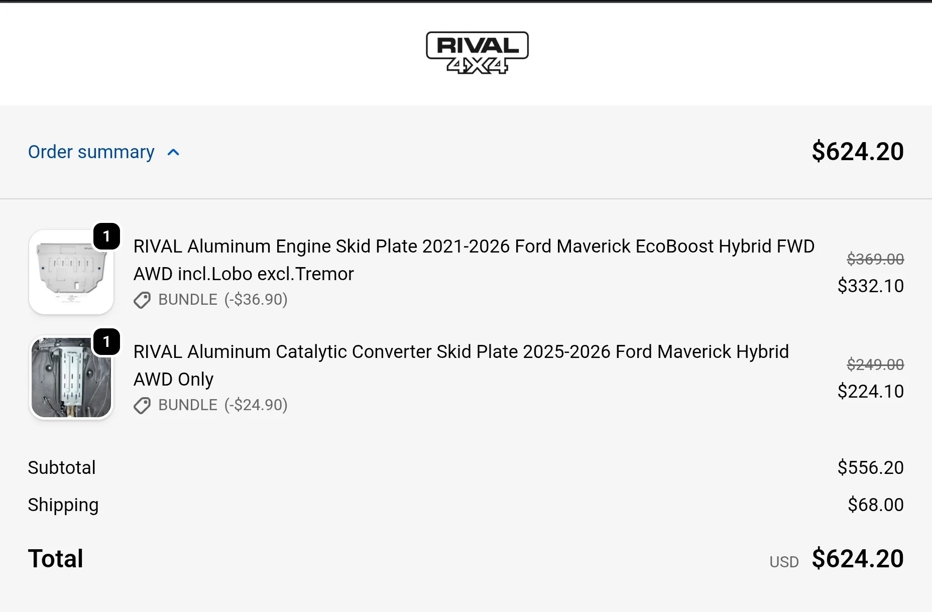

Rival skid plates ordered today! I pre-ordered the front skid and CAT cover bundle. The AT tires on steel wheels were installed last week. Hopefully some warm weather is coming so that I can finish the Rough Country Lift, Steeda front strut tower brace and rear say bar and Air Lift bags. Heck, I might finally get that Steelcraft Grille Guard installed too though I suspect it is going to make the front sensors get very upset.

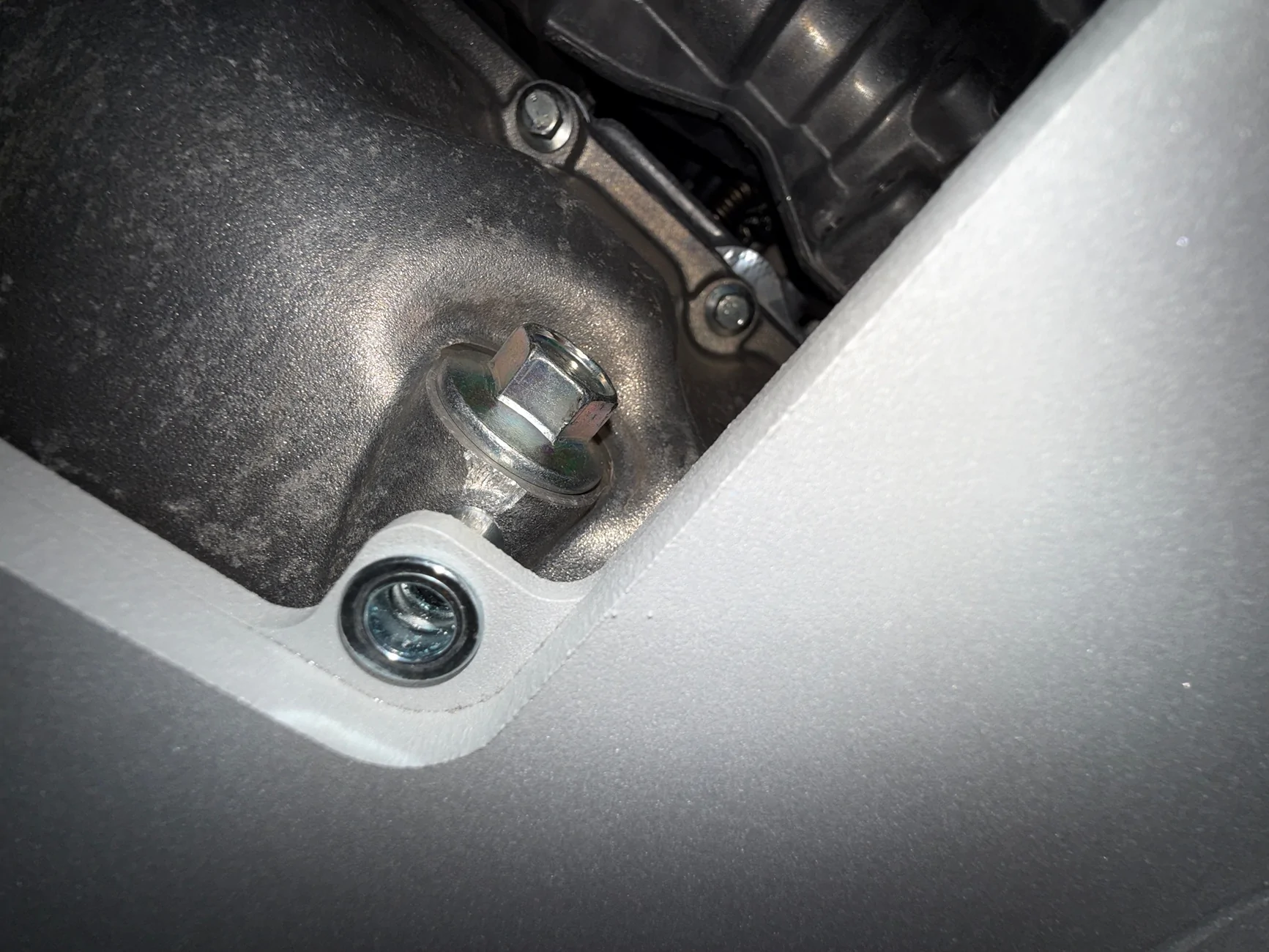

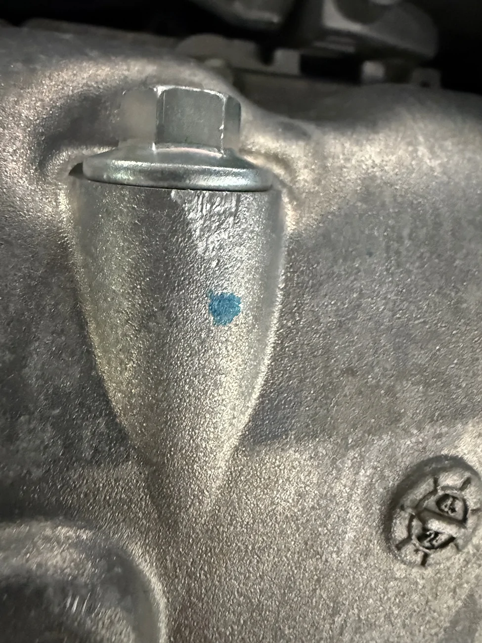

I would caution 2025 and 2026 Ecoboost owners from purchasing the Rival skid plate. I had one. It was incredible quality but it rubbed on the oil pan (see pics.) I sold it to a hybrid owner who did not have an issue. In addition, you would still need a funnel to do oil changes due to the location of the drain hole. It is right on the edge.

Did you let them know of the rubbing issue?
Yes, their customer service was very responsive. Their advice was to file rivet down, which I did. (Not something you expect to do with a brand new skid plate.)
I had gotten the skid plate to make oil changes easier. But it actually made them harder. Due to the location of the drain hatch, right where the oil drains, you would have to sit under the car with a funnel to keep half the oil from draining onto the skid plate. What an incredibly poor design flaw (at least with a 2025 ecoboost.)
If Rival moved the oil drain hatch one inch right and one inch back, I would buy another one tomorrow. That would also correct the rubbing issue.

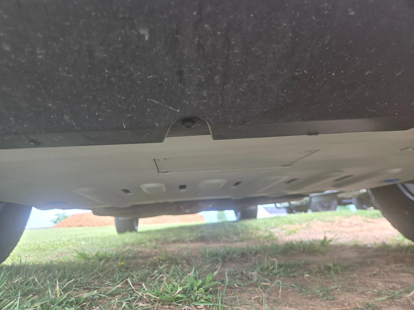

Update: The backordered skid plate arrived this week and I installed it yesterday.

First oil change with the Rival pan in place went without a hitch on my '25 hybrid AWD.

The skid plate went together fine and I had no issues with the nuts. They don't look like much, but they did work. I use my Maverick on my land where I'm building a new home. I crawl up and down steep mounds of dirt and I noticed some evidence that the skid plate is doing its job. Dirt and rock rubs tell the tale. I'll get the cat cover installed soon. My home construction is my priority at present.
