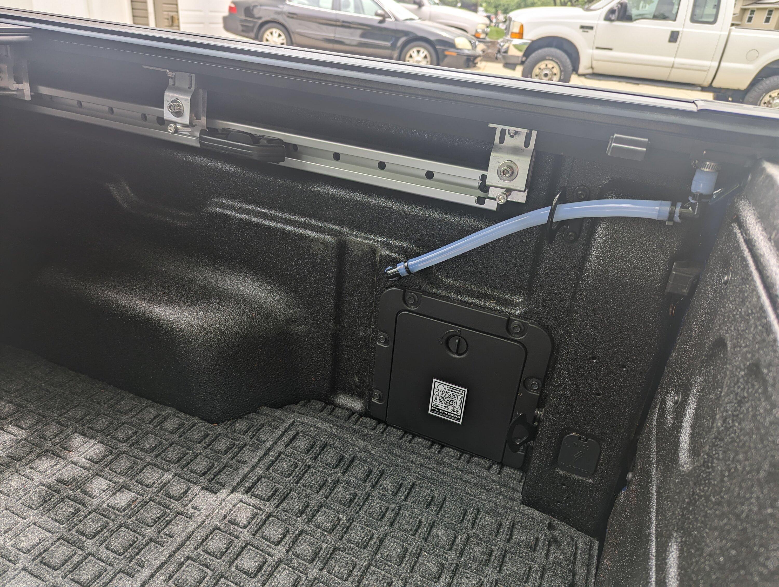

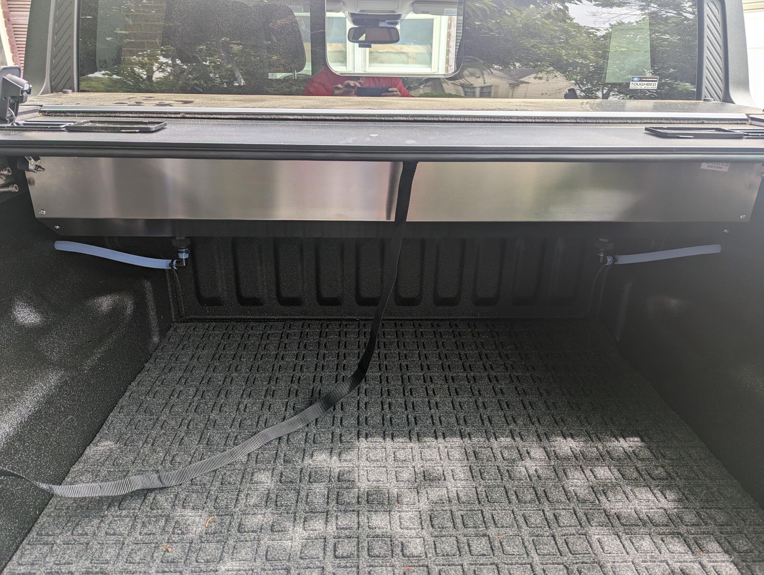

Not linking how most of the Tonneau covers with drain tubs simply bend the tubing, which may kink, resulting in water leaking into the bed, I went to Lowes and bought some Pex-A Expansion Elbows, and the drains look so much better, and no longer hang down in the way of loading/unloading items into the bed.
Ford Maverick Simple Tonneau Drain Tube Modification Elbows on Tonneau
Ford Maverick Simple Tonneau Drain Tube Modification Elbows on Rail
I used black zip-ties to hold them on, which works perfect, given the expansion barbs.

I was wondering if I could drain the tonneau into some of the bed side holes that have grommets which it looks like that is what you did.

That's exactly what I did, popped out the grommets, and inserted the tubing. Up front they're a slightly snug fit, in the back a bit looser, as those holes are oval, as opposed to round.

Mine had drain tube connectors on each side of the canister, as well as one on each side-rail near the tailgate.

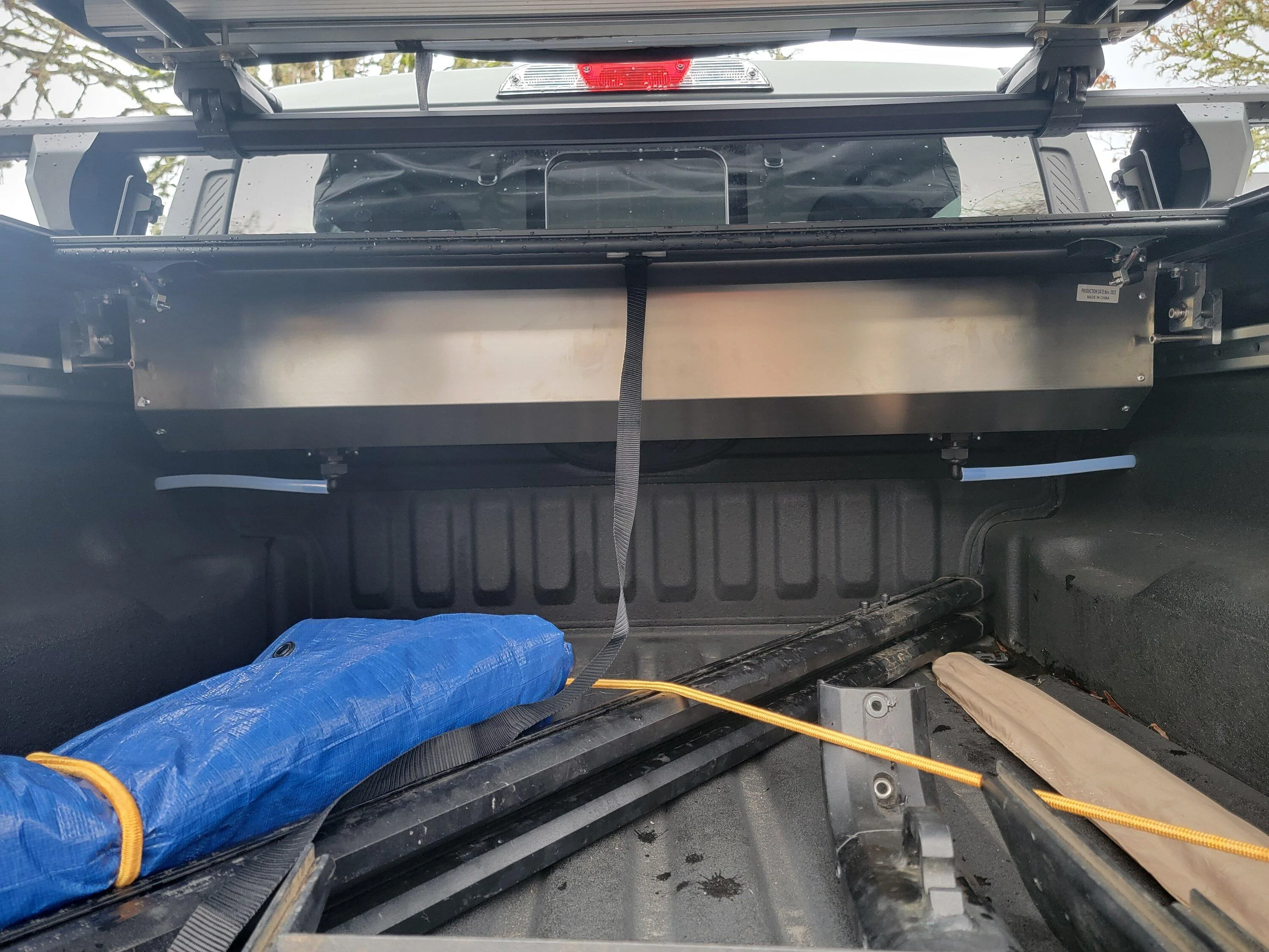

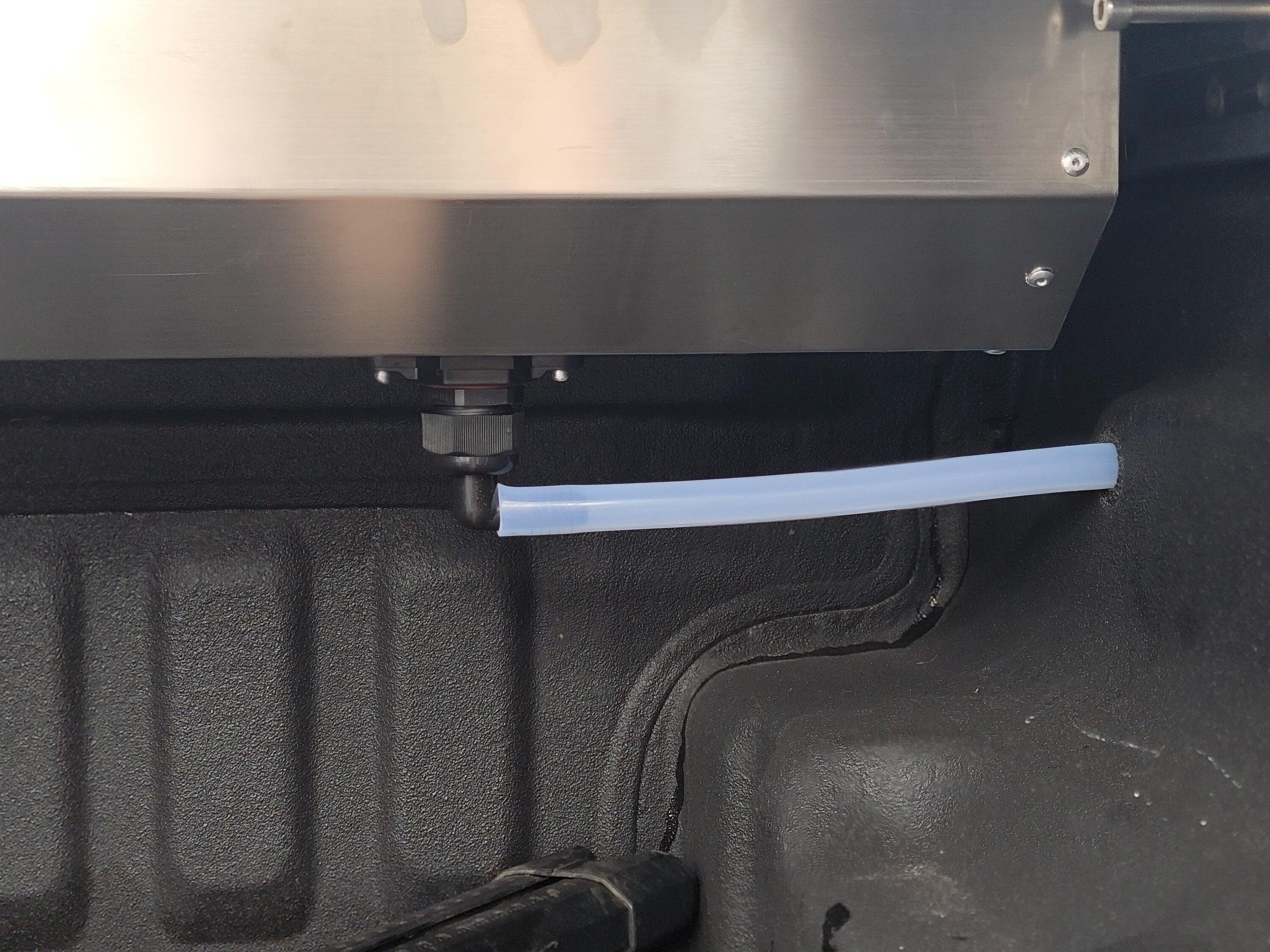

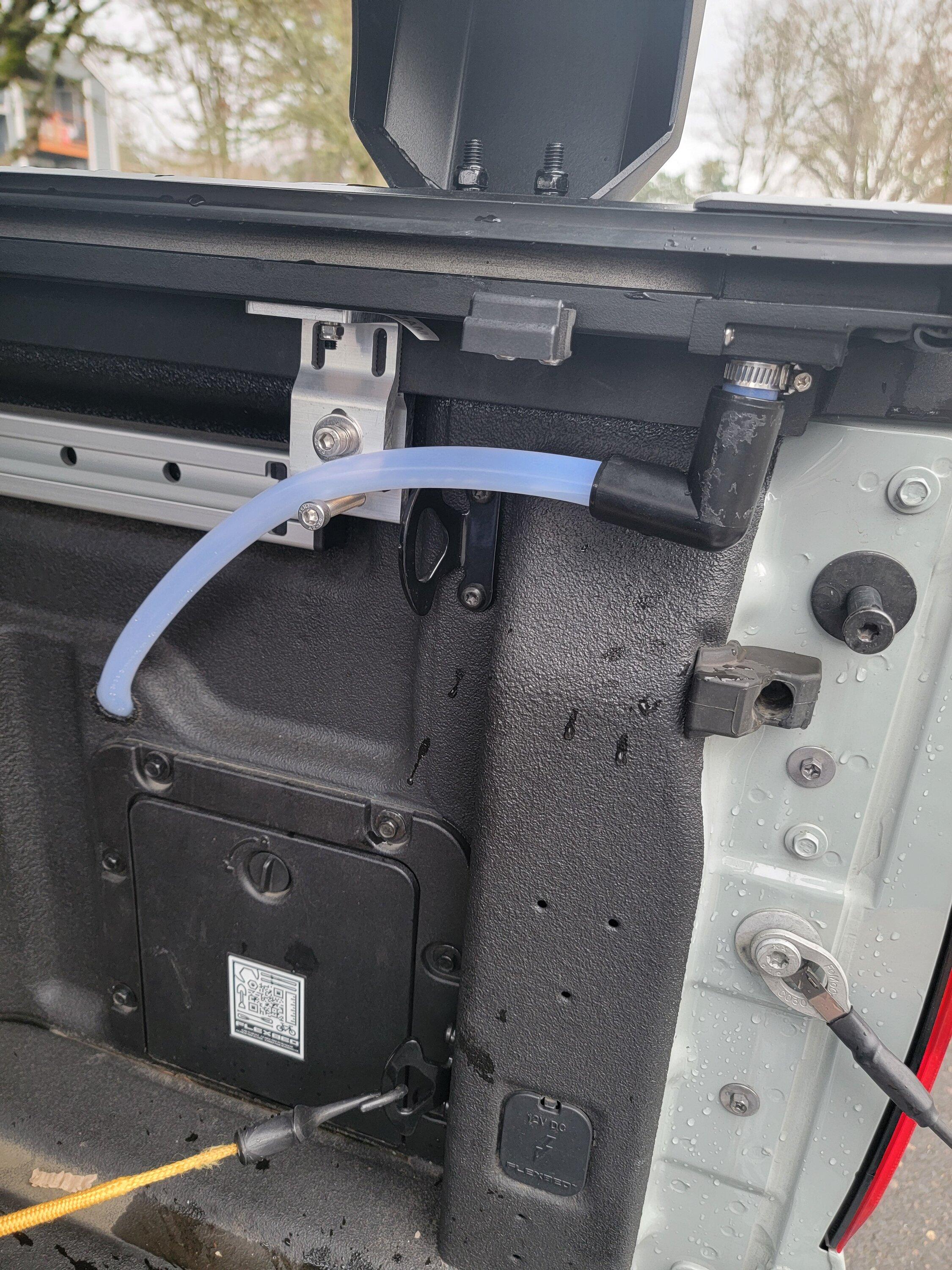

Dude thanks for this idea! I did something very similar with mine. But I put a 5/8" thread to 1/2" plug 90° right out of the cannister so the drain tubes a nearly level there (best match I could find at hardware store). Then I used a 5/8" 90° compression on the back corners.
