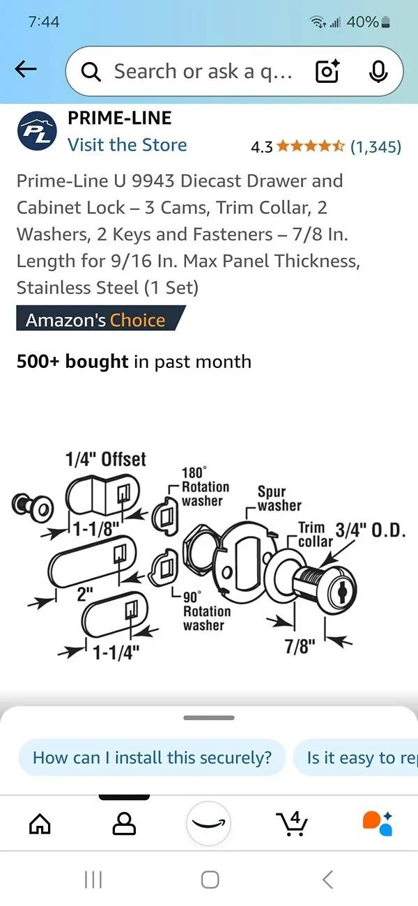

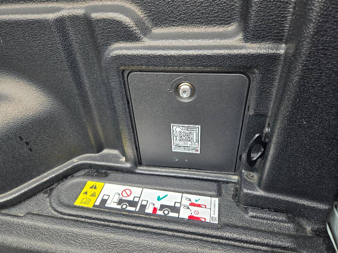

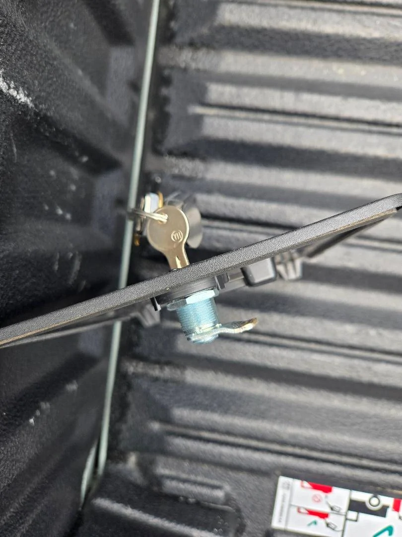

I installed this lock just to make sure the door won't get removed, not for security. It fits as if it was made for the door. I modified the 2" latch with a bend and cut short. Found it on Amazon for, I think, 7 bucks.
