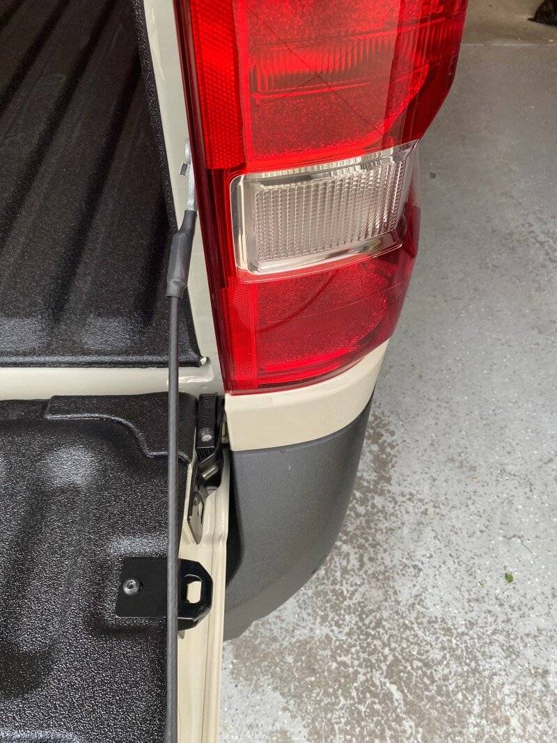

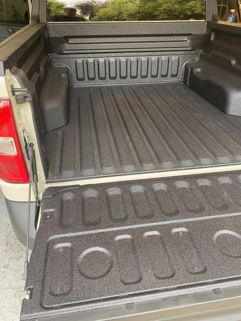

Addons to the truck bed.
Bed liner locally through the dealer. Nice job. Mabett tailgate strut.
Mabett hitch cover. Maxzina receiver cover.
Tailgate lock installed.
More to follow as $$$ becomes available.
From a fellow XL owner, looks good! (y)
Something is now missing there! Adding the strut shouldn't mean losing a tie-down point. I made a replacement tie-down for mine.
Works well and clears the new strut and no issues with the cable. Enjoyed making it enough that I keep making more. I have a thread here in the For Sale forum if anyone would like one. Don't lose a tie-down point!
I really like this. You did a great job. I need one for this side since I had to remove the factory one as you did for the soft close strut.

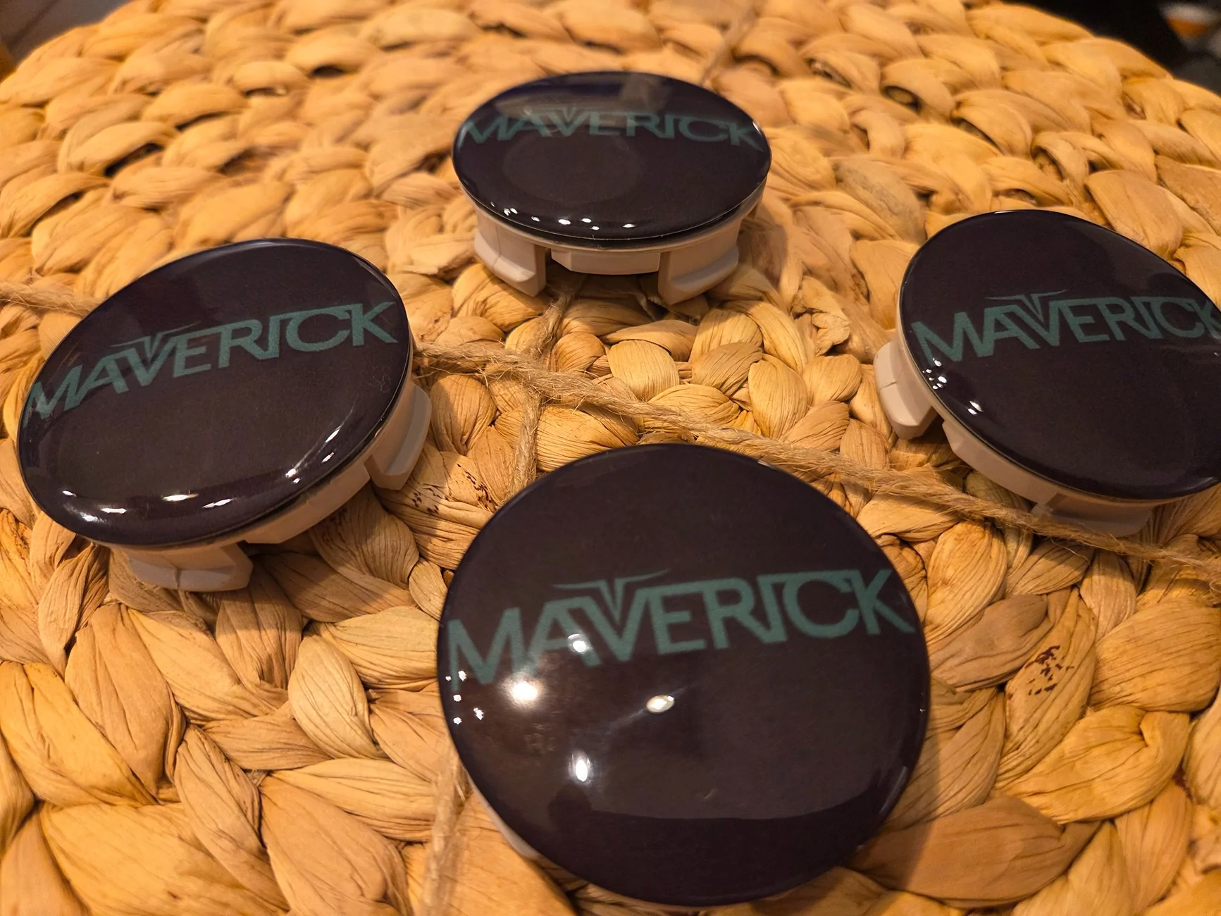

I think I have used and bought almost every mod out there for my 25 Lariat. Latest things came in today. Hub wheel center covers... Just slapped over the Ford label.
Where did those come from? I might end up with some pretty random rims for winters, Volvo, Land Rover or something, so those might go over their centers rather than having to buy Ford caps.

I had them made on Etsy. They had the right measurements for this and many others.. I just showed them a Google image and told them the colors I wanted and it was like 20 bucks.
Cool, thanks, I might get the oldschool Maverick roundel then or something if I need them.

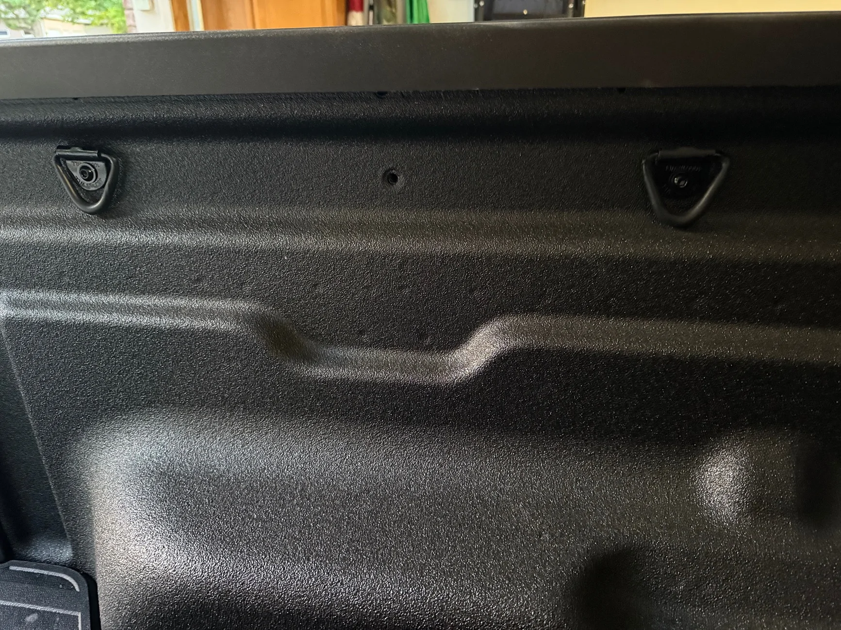

- Re-positioned D-rings on side wall of the bed.

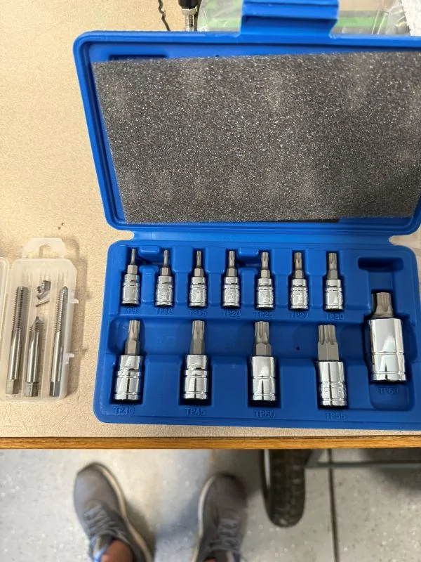

What should have been a 10 minute job took 6 hours due to a junk tap. I was chasing threads due to the spray in bed liner. Finally got it out but banged up some of the threads. Luckily I was able to thread in a bolt and tighten it down. Since I had lots of M8 1.25x25 bolts I went ahead and filled the remaining points to protect the threads etc.
- Tools of the week.
Ford Maverick Simple 2025 XL AWD Hybrid 4K mods tools
Taps on left :thumbsdown:. You can see the one that failed.
Torx plus :thumbsup:. So nice that the fastener doesn't get wallowed out. Apparently I can't take a set of photos with out including one or more of my feet. Sorry.

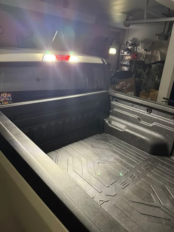

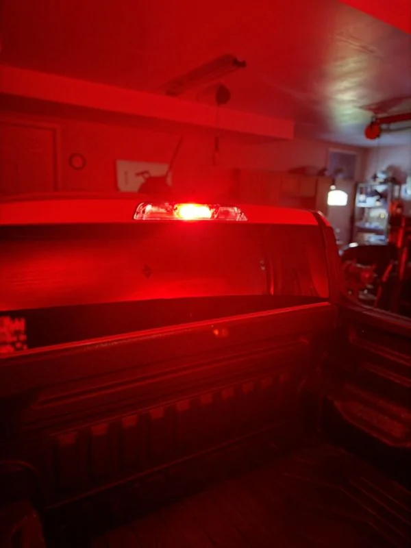

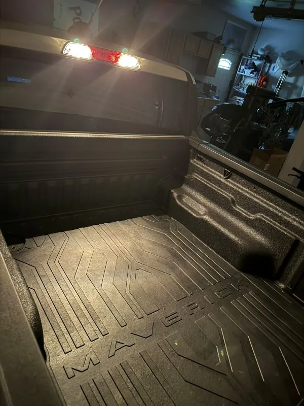

- Added LED for cargo and upper stop lights.
Ford Maverick Simple 2025 XL AWD Hybrid 4K mods LED bulbs
Top are flash stop Amz Flashing Stop
Bottom are cargo Amz Cargo Bulb
old
Ford Maverick Simple 2025 XL AWD Hybrid 4K mods old cargo
New
Ford Maverick Simple 2025 XL AWD Hybrid 4K mods new cargo
Old stop
Ford Maverick Simple 2025 XL AWD Hybrid 4K mods old center sto
New stop
Ford Maverick Simple 2025 XL AWD Hybrid 4K mods new center sto

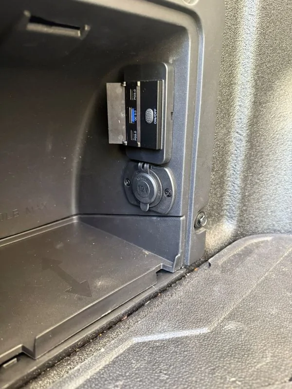

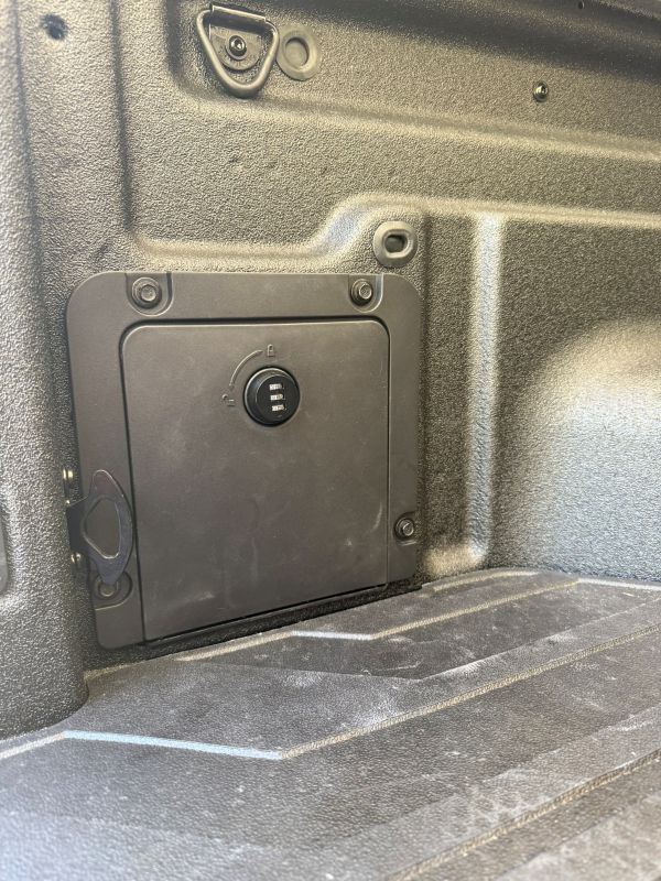

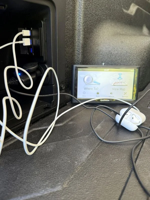

Decided it was time to use the 12 volt pigtail that came with the truck so I added an Amazon bed cubby with USB and accessory power on the driver side. The storage bin is cheaper alternative and only uses the original 4 bolts. Seems decent only time will tell, but I chose it because it was cheaper in case I didn't get the rest of the project correct. AMZ Storage Bin This one had a lock built in, not that it matters too much since it all made of plastic. Install was no big deal, though it is sensitive to alignment/spacing and needs to be installed with the door in place to ensure that it door doesn't bind on the edges.
Ford Maverick Simple 2025 XL AWD Hybrid 4K mods Cubby
I had seen a couple of folks that added accessory and USB ports that had deep cylinder profiles with a large diameter lock nut. I also read that it was kind of a pain to secure them to the storage box because of the depth. I used a flatter USB port with a normal accessory port. This way I only had to use a screwdriver to tighten the one port instead of both. The surrounds are bolted to the sides with 3mm machine screws, washers, and nuts. Side note these should have probably been 4mm instead. (Either way I have stoopidly bought a box of assorted 3mm and have a gazillion extra itty bitty pieces). AMZ USB Port The USB port has 2 type C and 1 type A with port lights as well as a switch to power off. Granted the circuit is already fused I just wanted the power capability. It also has a door to cover the ports. AMZ Accessory Port Accessory port was simple generic item.
Ford Maverick Simple 2025 XL AWD Hybrid 4K mods Cubby Power door
Installed and all powered up. Getting the accessory port in was the difficult part of this project. I also wrapped the wires and connectors with cloth tape and head shrink on the ends to help protect it all. AMZ Wire Tape Since I have the body shield splash back should be minimal. Running the GPS off the accessory port, iPhone and AirPods on the USB ports.
Ford Maverick Simple 2025 XL AWD Hybrid 4K mods Cubby Power USB and Accessory

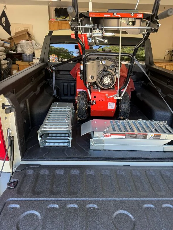

Picked up some tri-fold aluminum ramps from Harbor Freight. Heavier than I thought they'd be but they work fine. Used them to do my first truck thing (woo hoo) when I had to take the snow blower in.
Ford Maverick Simple 2025 XL AWD Hybrid 4K mods Ramp sm

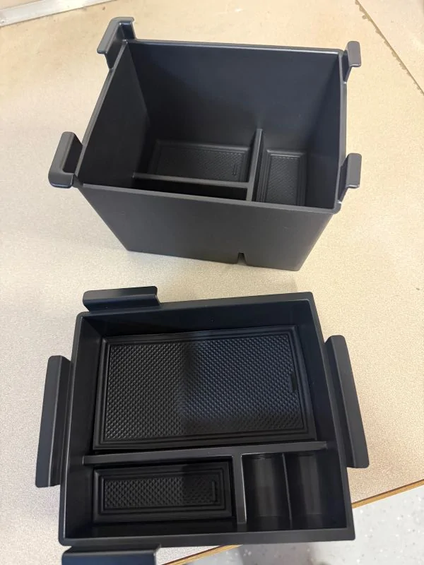

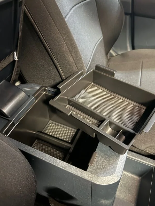

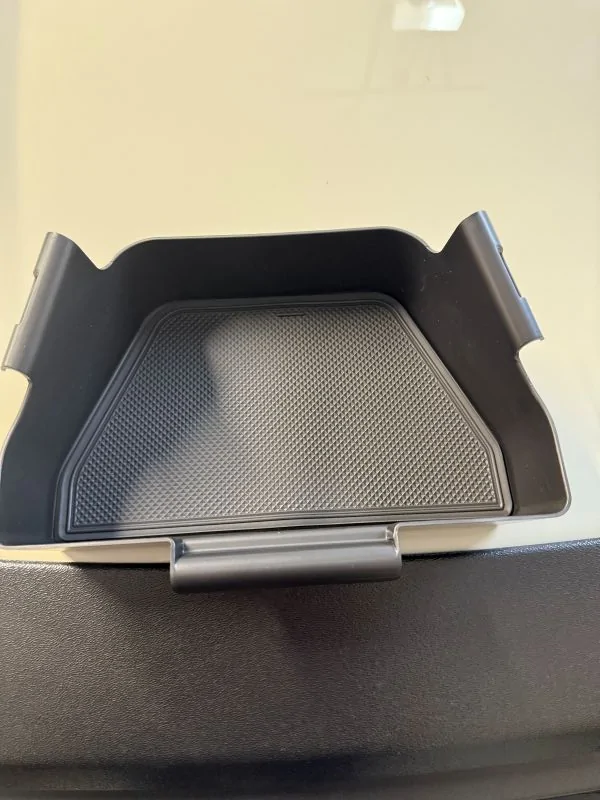

Been a while since I sent an update. Bought a no name console divider AMZ Console Divider. For a off-brand item it works just fine. I was kind of unaware just how deep the console was! The divider creates 3 separate storage areas.
Ford Maverick Simple 2025 XL AWD Hybrid 4K mods Console Tray 1 sm
Ford Maverick Simple 2025 XL AWD Hybrid 4K mods Console Tray 2 sm
