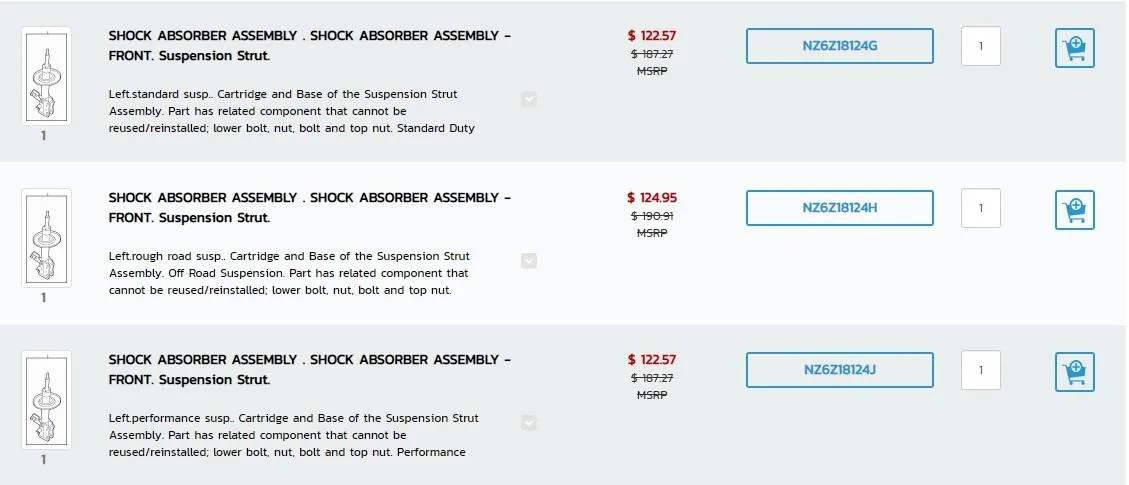

These are the struts shown on Ford parts. Three different flavors, standard, rough road and performance. Based on price I'm going to guess that "rough road" is Tremor and "performance" is FX4 but who knows. Not much price variation between the three and under "fits these vehicles' it only lists the Maverick for all three.
Ford Maverick Shocks and struts OEM Mav Struts
