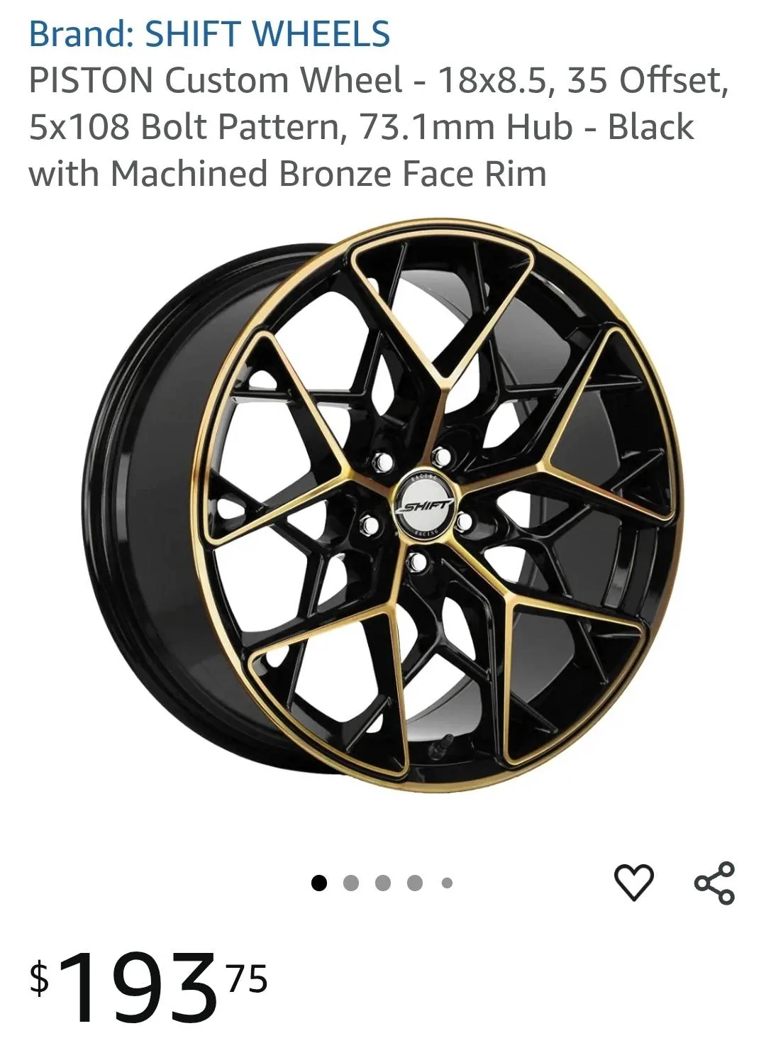

Has anyone used these wheels or specs?
Ford Maverick Shift 18x8.5" 35mm wheel fit? Screenshot_20250419_074638_Amazon Shopping

According to Tirerack, they show a 45MM offset, so with the wheels you're looking at, you would want a 10MM or 3/8" wheel spacer also.

That would be less offset with a spacer.
You are correct, next time I comment on a post, I will do my best to make sure I've had at least 2 cups of coffee.
Disclaimer: I'm not the smartest when it comes to wheel offset. 😜
That being said, it will bring the wheel out 10MM, the tire you decide, if going larger width or diameter might rub at full lock.
All the specs line up to fit a Maverick.
Offset is only 3mm from stock (poke out).
Just need a hub ring to adapt from 73.1 to 63.4.
I know from my days of searching tire/wheel threads,
quite a few folks used 18x8.5 to 20x8.5.
I'd love to see that wheel on a Maverick.

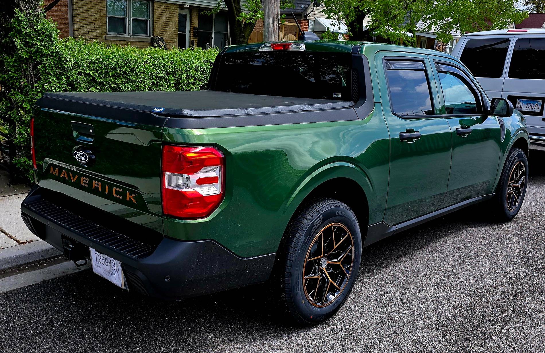

Are there any aftermarket wheels that essentially fit like stock without need for spacers or centering rings? Or will pretty much anything aftermarket need the extra do-dads to mount it? I'd like to get some 17" bronze wheels with snows mounted for my Eruption Green machine.

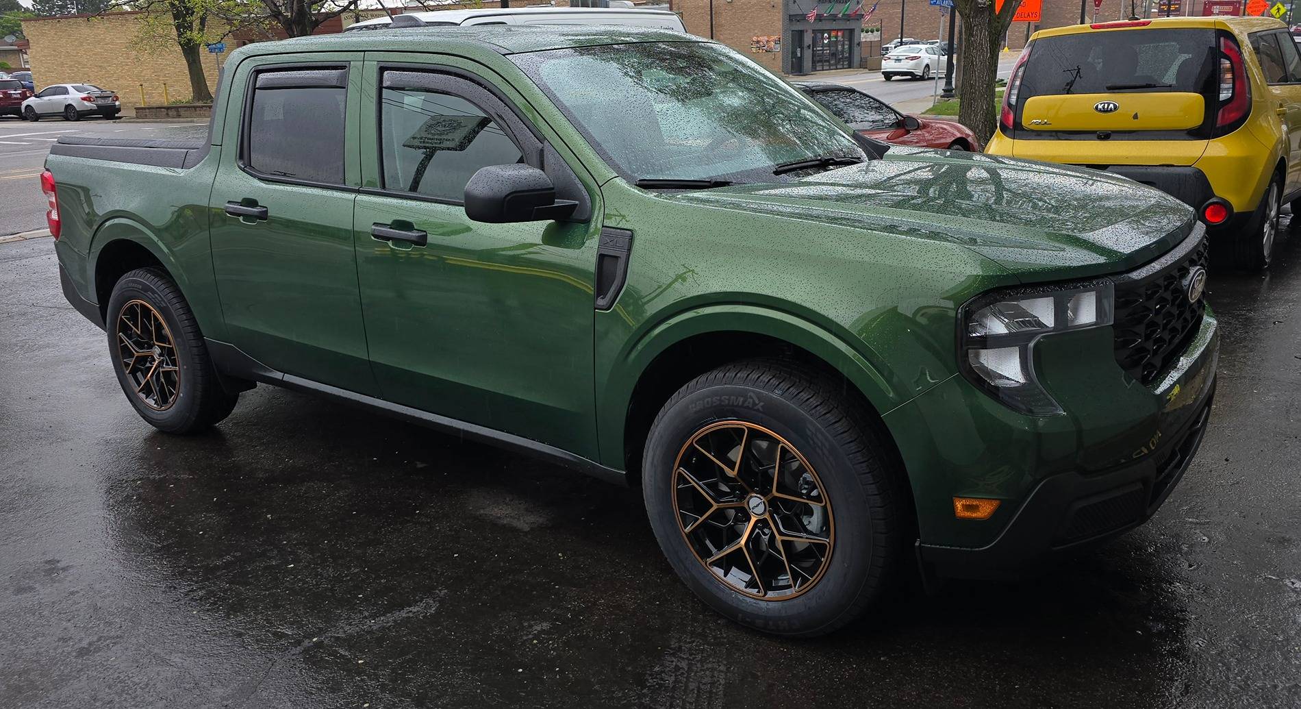

Ford Maverick Shift 18x8.5" 35mm wheel fit? IMG_1442
Touren TR79
Size: 17x8 or 18x8 or 19x8.5 or 20x9
Bolt Pattern: 5x108
Offset: 35mm
Hub Bore: 63.50
Ford Maverick Shift 18x8.5" 35mm wheel fit? IMG_0252
Other finishes available.

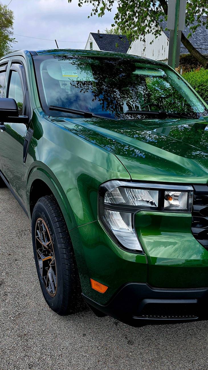

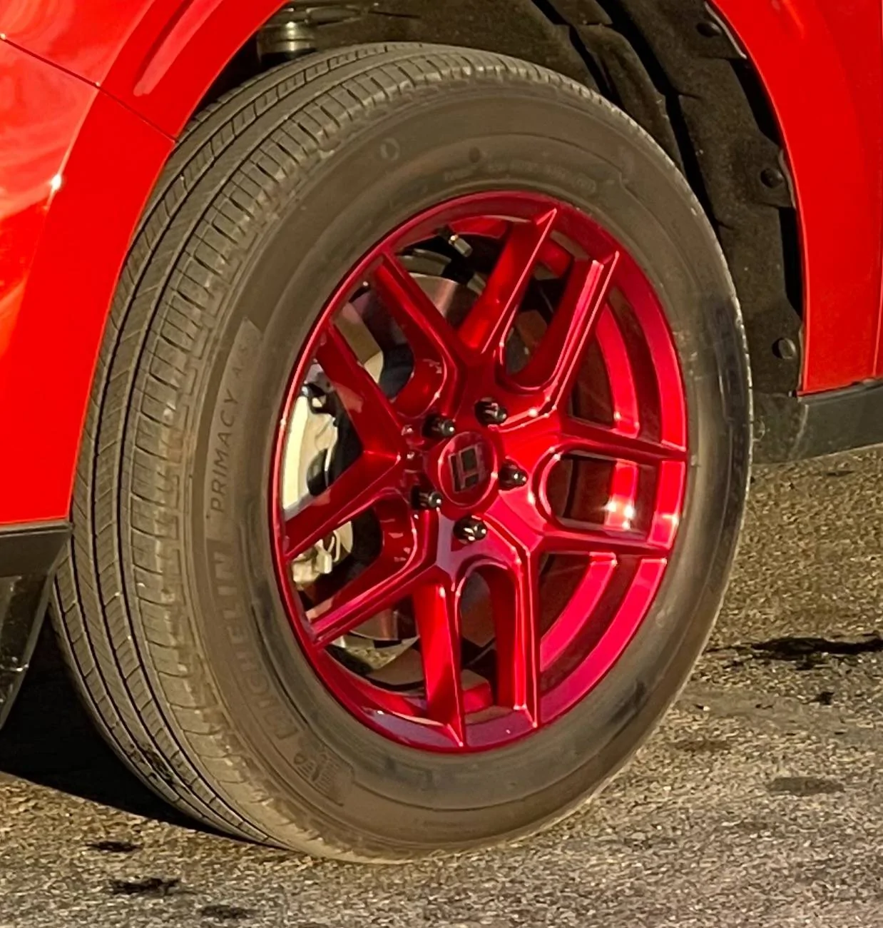

Rainy day today, but got some pics.
Ford Maverick Shift 18x8.5" 35mm wheel fit? 20250501_110434
Ford Maverick Shift 18x8.5" 35mm wheel fit? 20250501_114355

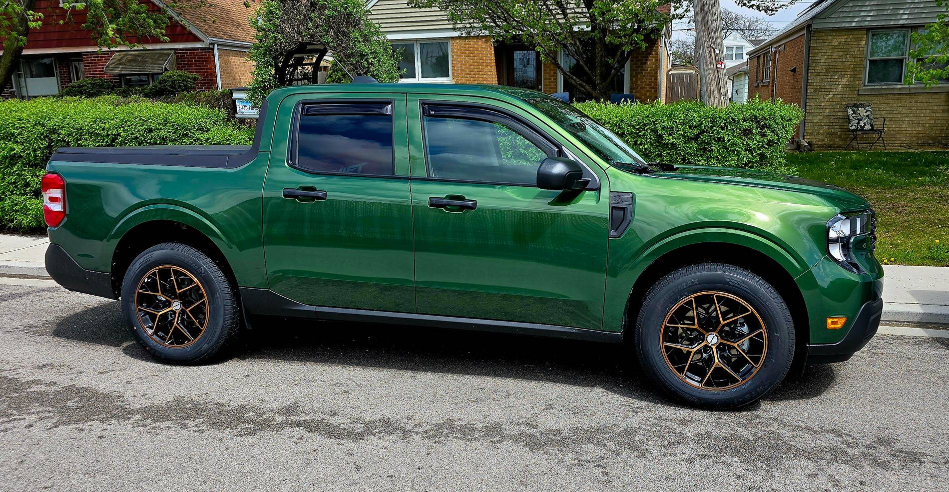

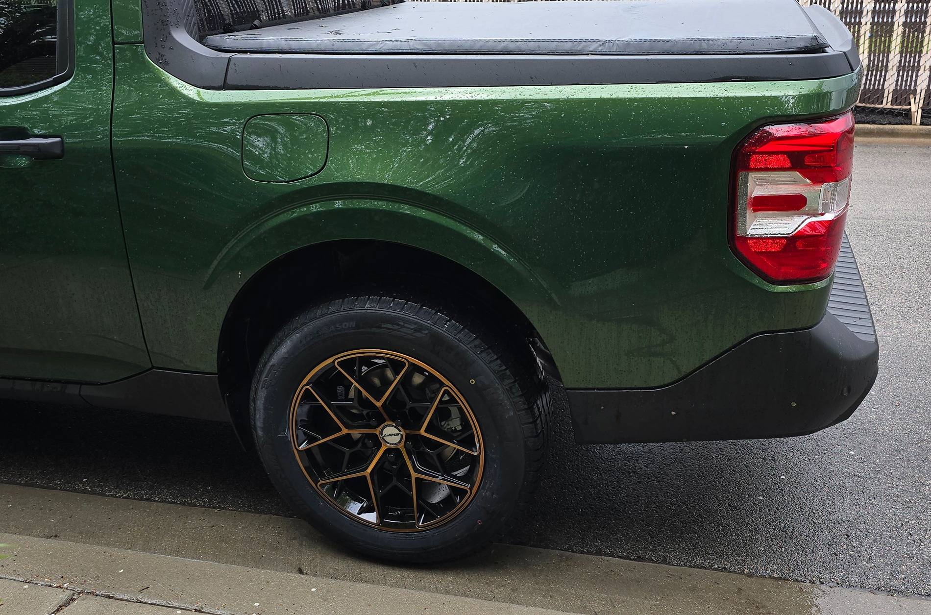

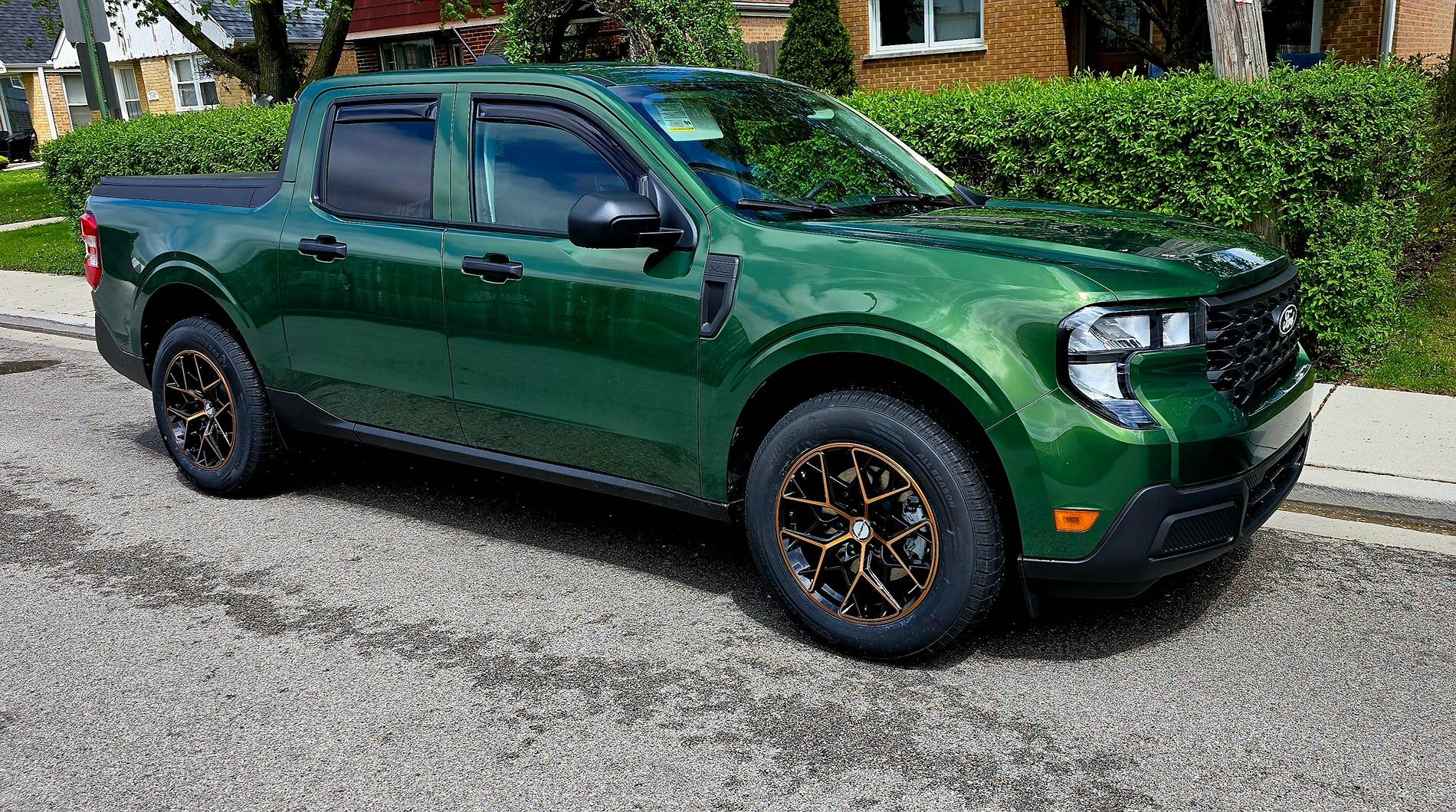

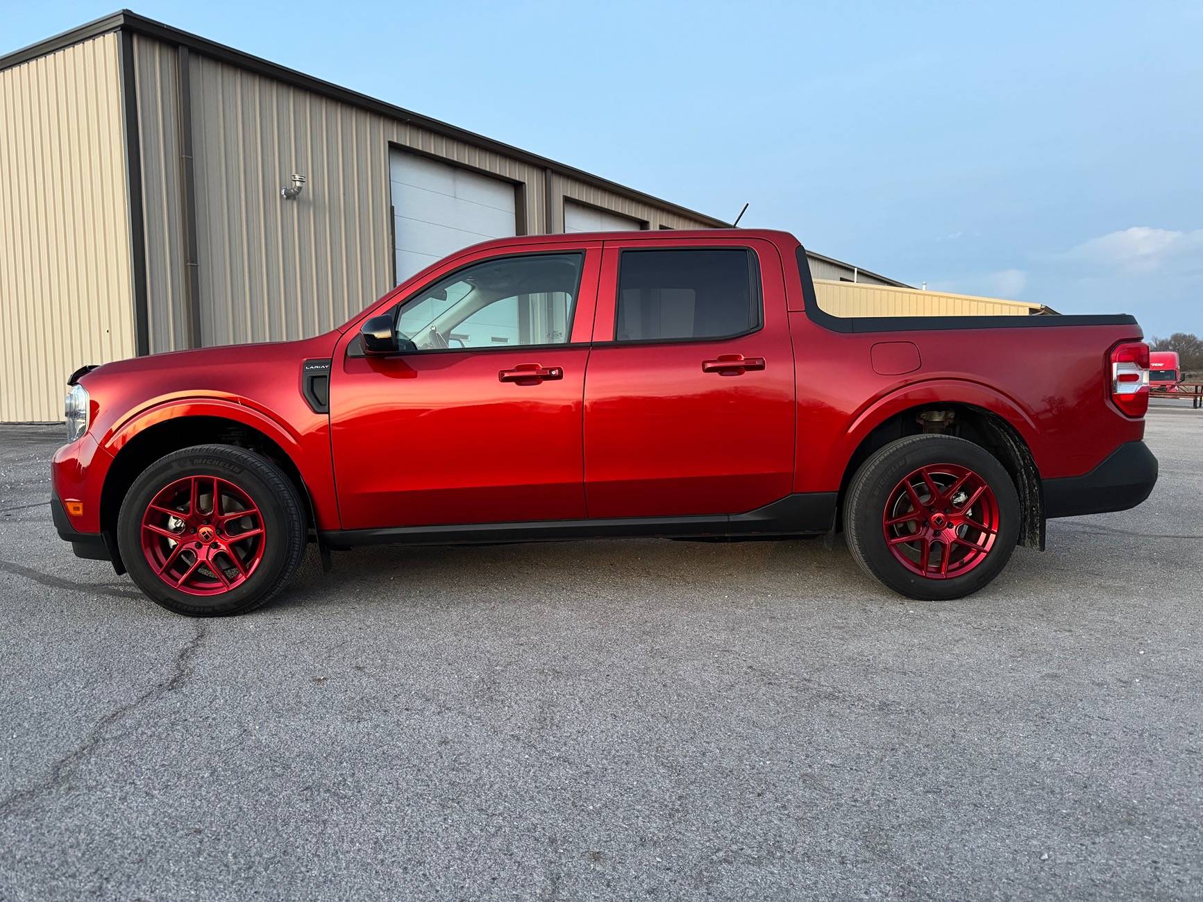

Sun popped out for a few.
Ford Maverick Shift 18x8.5" 35mm wheel fit? 20250501_140629
Ford Maverick Shift 18x8.5" 35mm wheel fit? 20250501_140646
Ford Maverick Shift 18x8.5" 35mm wheel fit? 20250501_140702
Ford Maverick Shift 18x8.5" 35mm wheel fit? 20250501_140817
