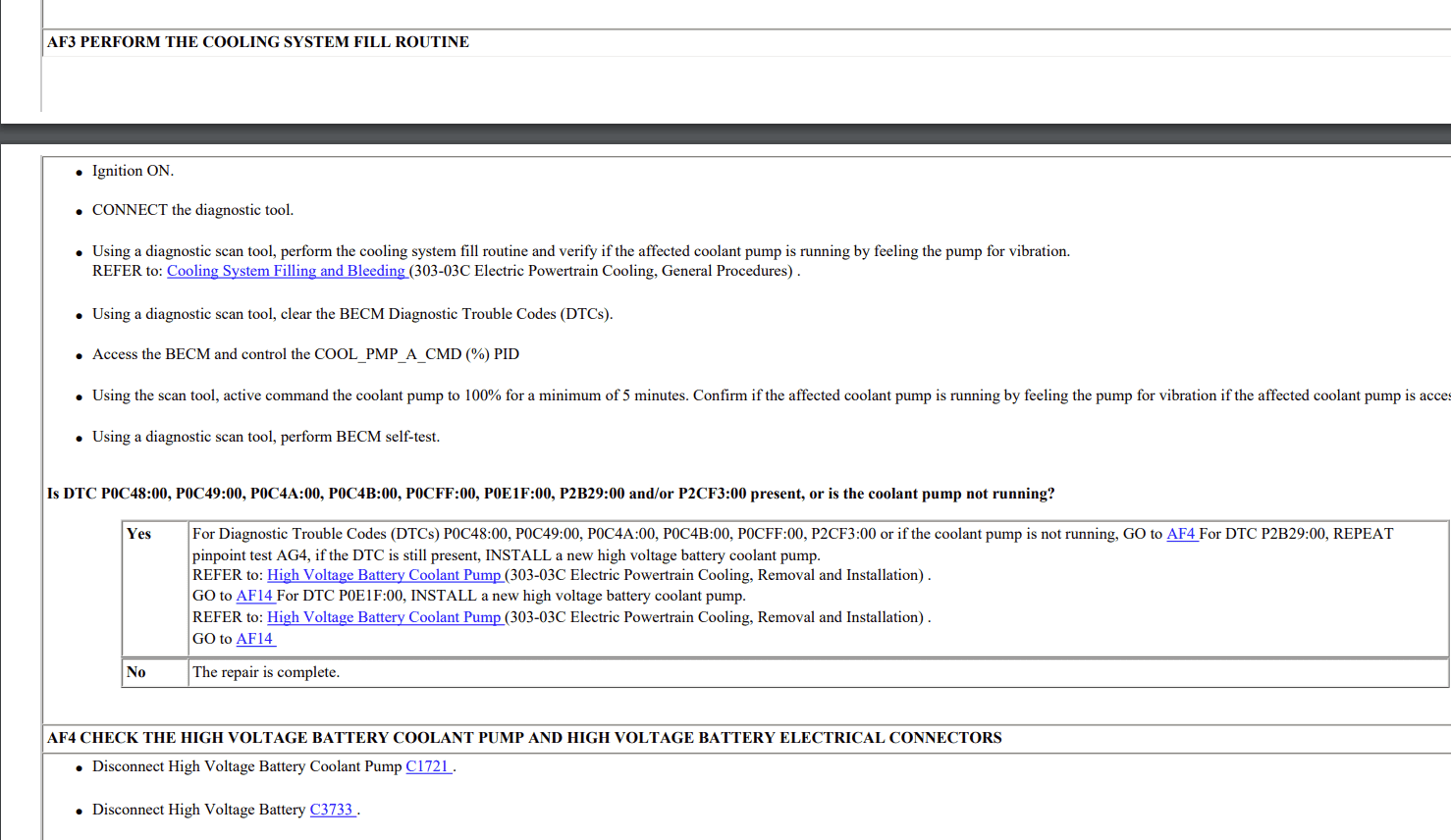

Both chambers are within acceptable level and the one closer to the firewall is the less hot one for the electrical system. Thank you for the idea
If you have already verified that the coolant level is correct the next step in the service manual is to verify the pump is working. This is the procedure to verify that it is.
After this the next step is to verify the electrical connectors.....not sure how far down the rabbit hole you want to go.
I am always down for a rabbit hole. I have the USB scanner and Forscan with a license. My two current problems with that is we have crazy thunderstorms going right now with 80 mph winds and I dont have a laptop to run forscan so I literally have to move my whole desktop and run an extension cord lol. Your screenshot tell how to diagnose though, where did you get that?
