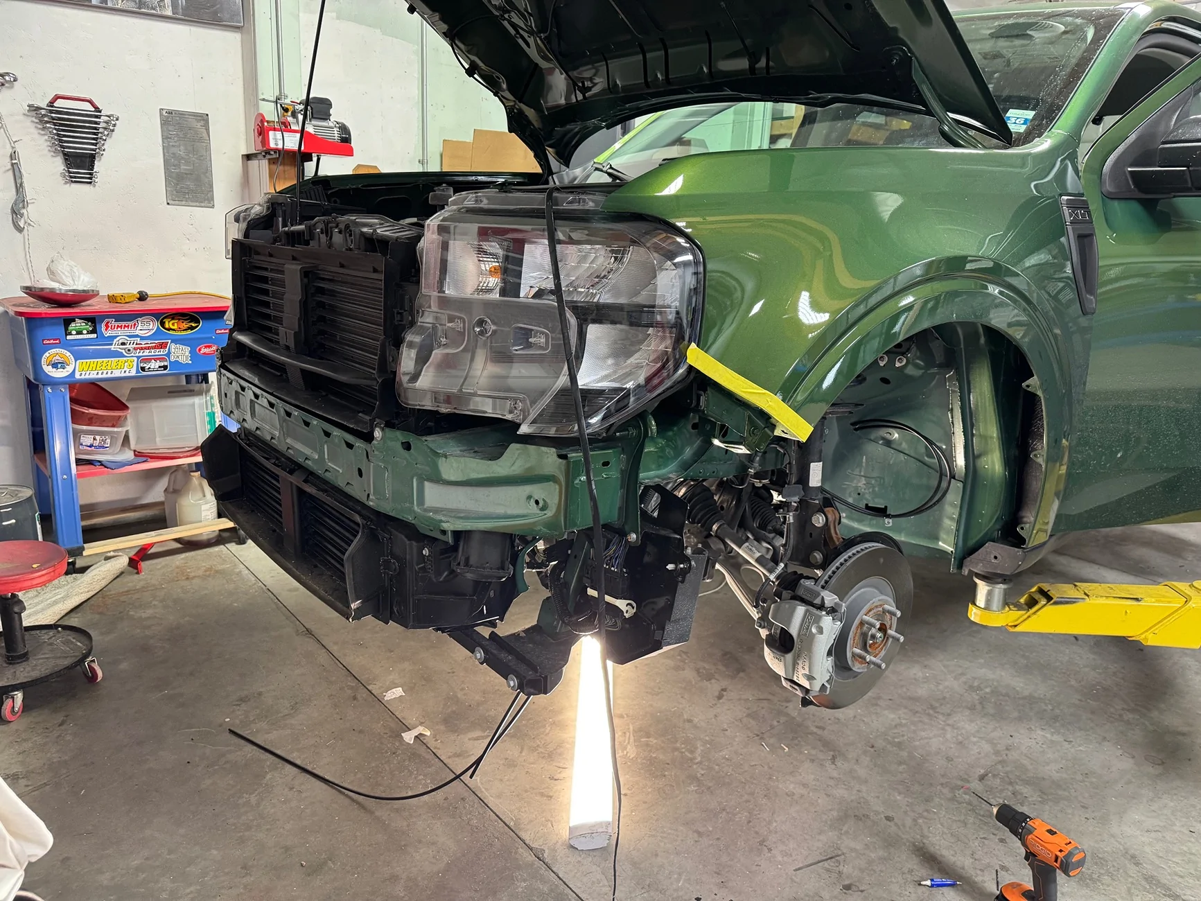

I managed to do exactly the same thing when installing my Demco base plate on my Maverick. I started the car and realized I hadn’t connected the plug for the lights and forward facing camera. I reached in through the wheel well opening and connected the plug, and a few starts later the code cleared and all good.
