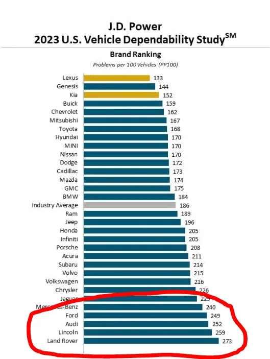

Check out which company occupies 2 of the bottom 4 in JD Power. This is what happens when companies make money in spite of themselves. Wonder if this ranking would be the same of Ford didn't have the F150 to rely on.

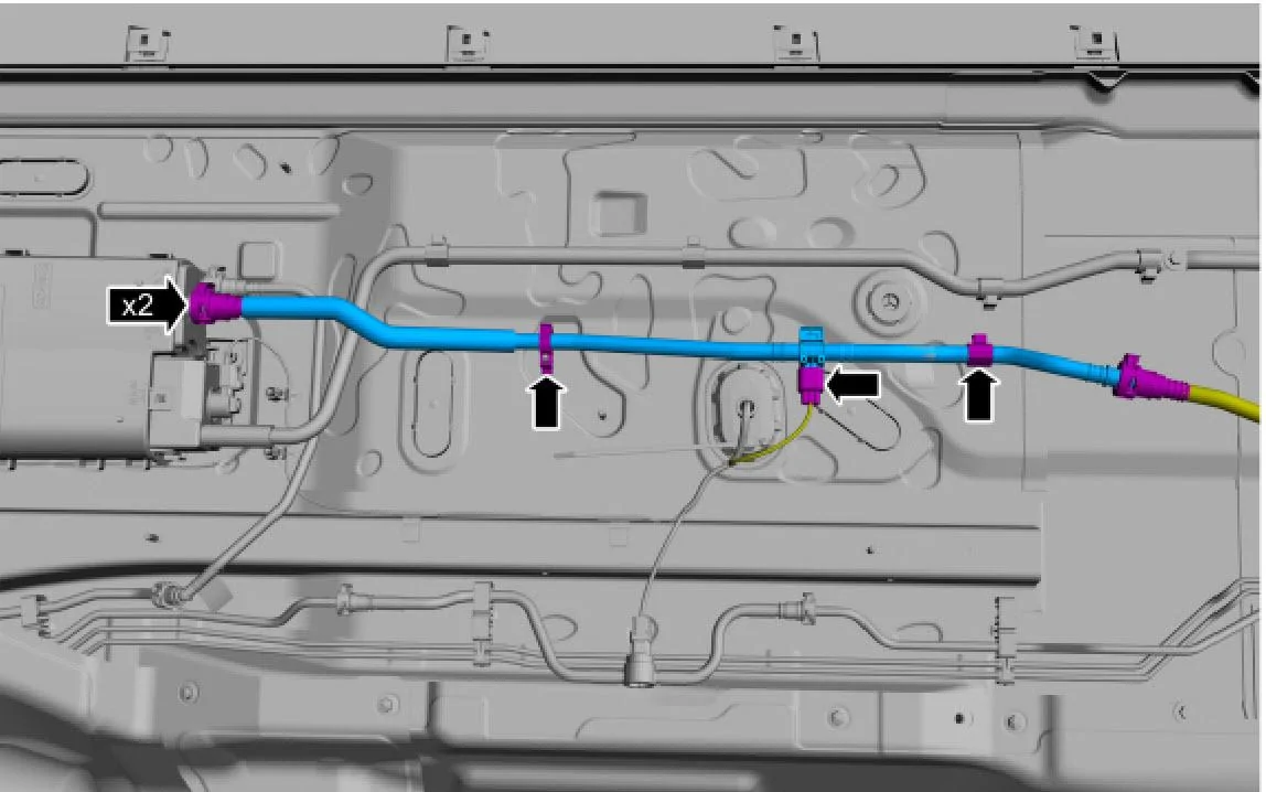

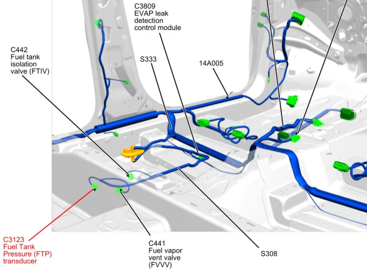

I had this same issue - P0451 and P0496. I also happened to have undercoated the Mav.
Dealer replaced part# NZ6Z-9D333H "Hose - Connecting 1" under warranty today. Notes say they "removed and replaced fuel tank pressure sensor" however. Where is this hose and/or pressure sensor located?
BlueSpec1
Gene
Jul 10, 2022
805
836
23 F150 XLT Powerboost, 22 Escape Plug-In, 23 Bolt EUV
There's a couple of electrical connectors between the EVAP cannister on the left hand side and the gas tank.
