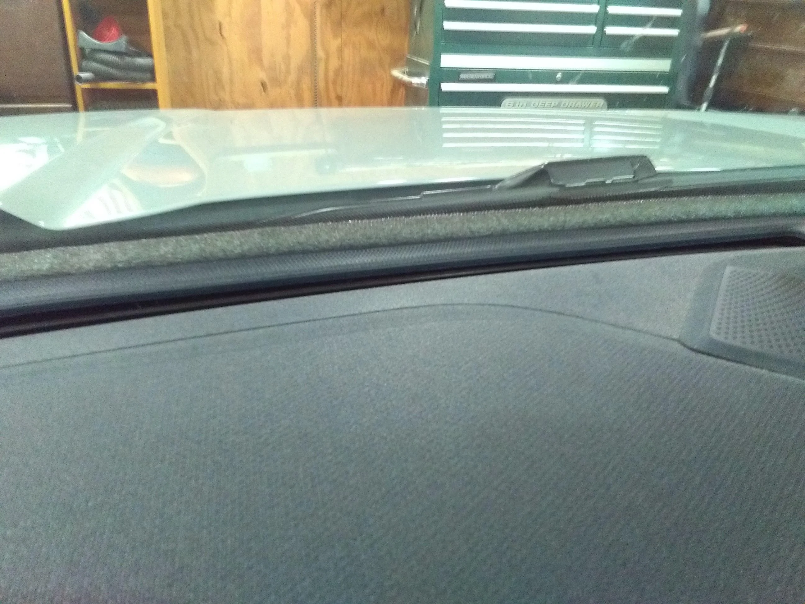

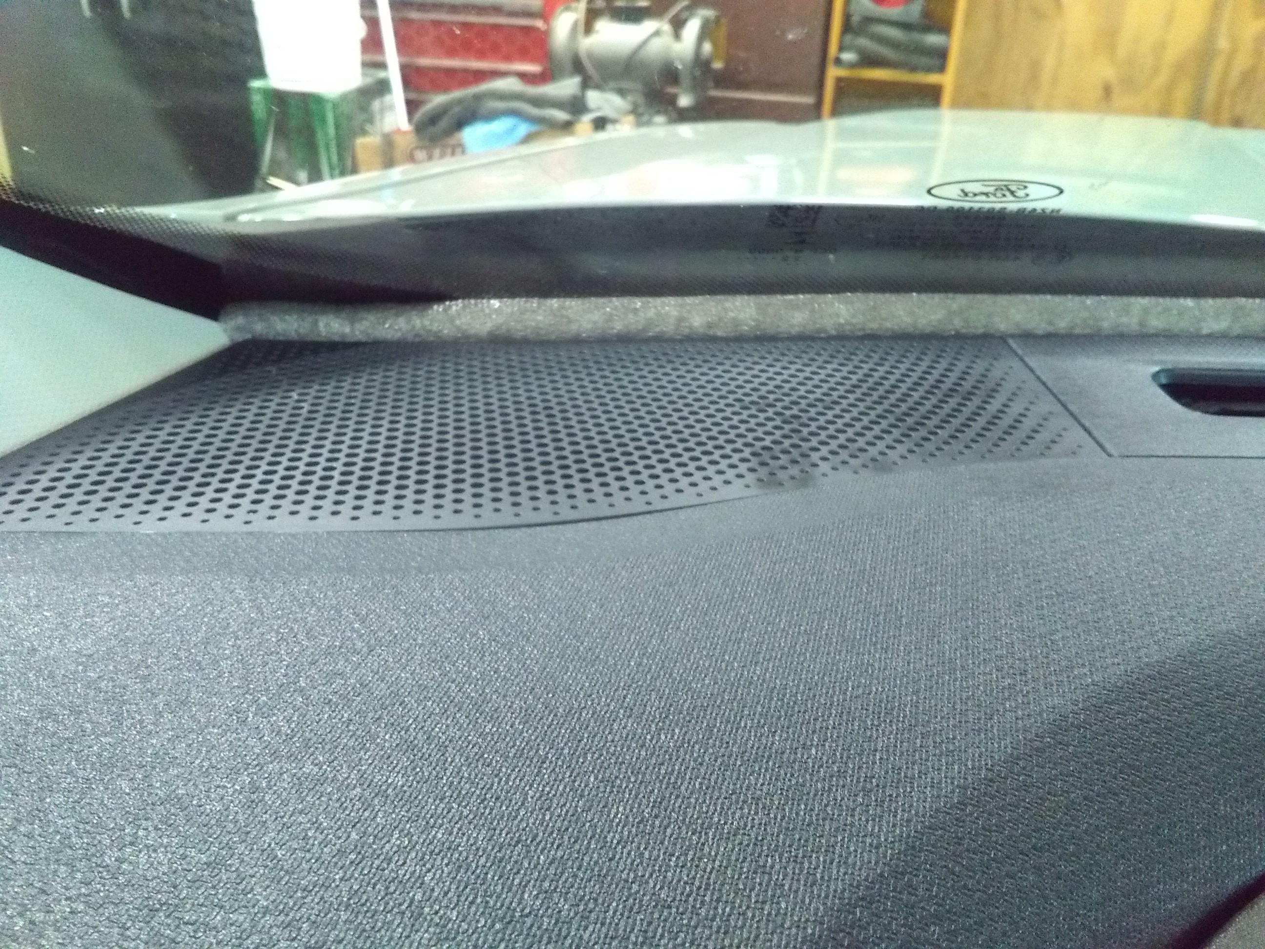

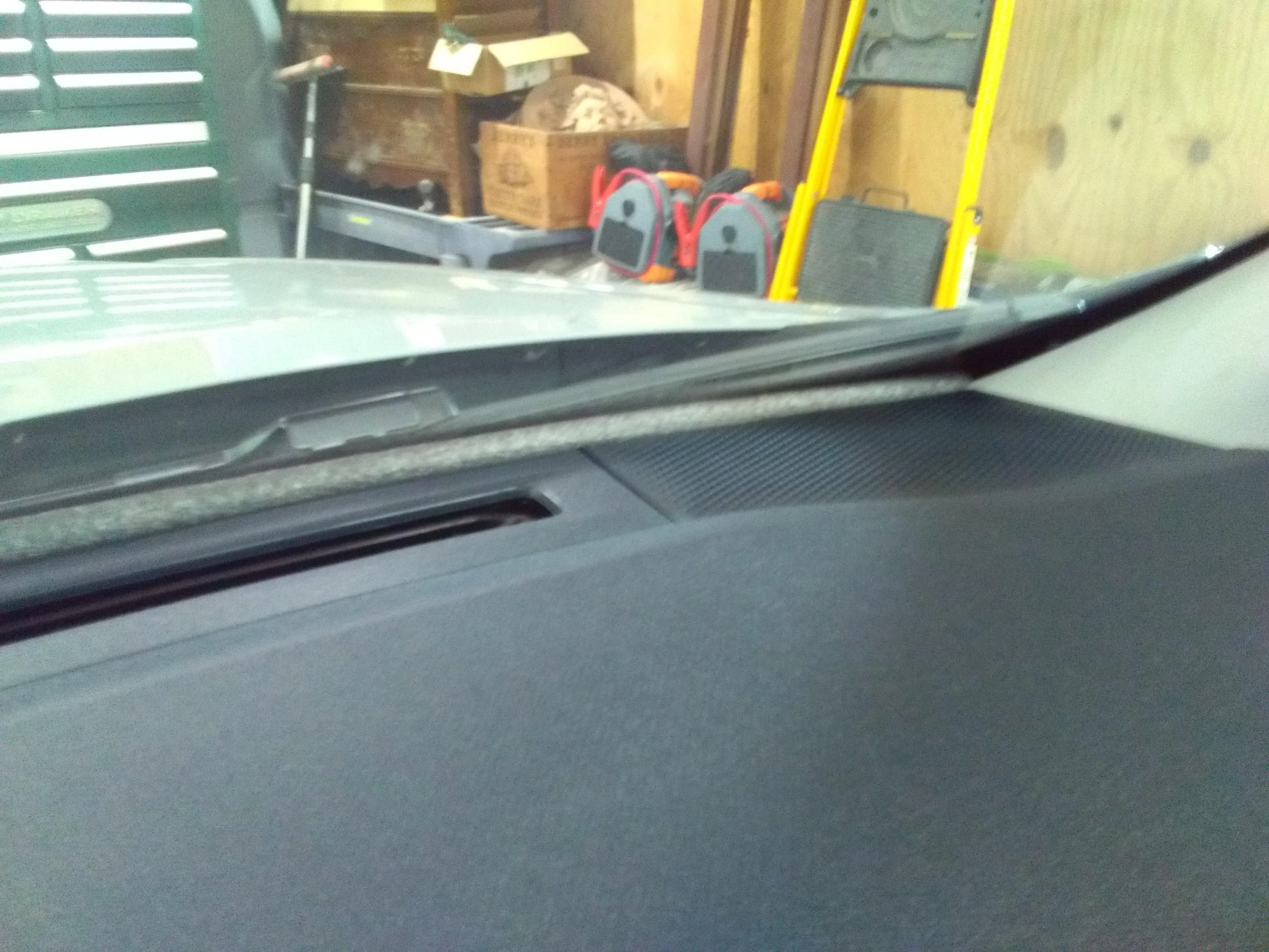

1. Check for items under the rear seat in the storage area. 2. Check the rear seat seatbelt metal buckles and retractor such that they aren't touching anything. 3. Check the jack and tools are tightly stowed. 4. Check that the seatback is properly and fully latched. 5. Look for for some stray or random object that fell behind the seat.
Yup. Also check this.
