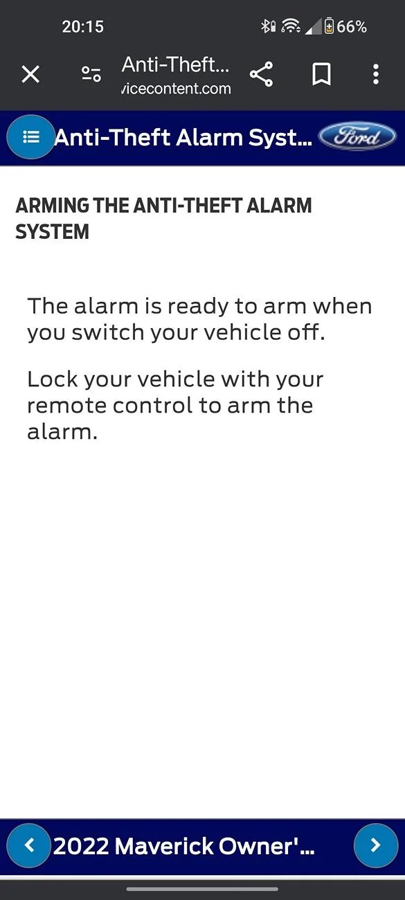

Maybe locking the door with the key after you get out? Not sure if it gets armed if you don't press the lock button inside or on the remote.
Ford Maverick Security alarm issues Screenshot_2024-07-03-20-15-18-71_40deb401b9ffe8e1df2f1cc5ba480b12
