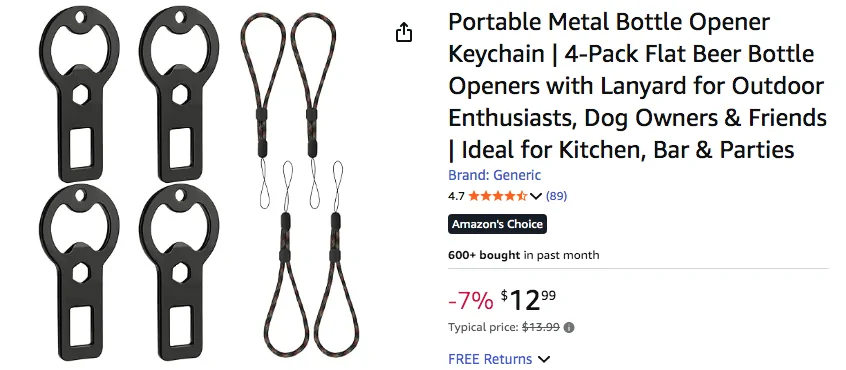

I tried and it works! The persist seat belt dialog box is only concerned with the back three seat belts. This is wonderful :) Where did you get those little dummy buckles?
I actually do have back seat passengers probably once a week - gotta remember to take them out, or they'll probably lose them. Or maybe keep them.
ETA - just noticed, only for opening flat beers...
https://a.co/d/2mGb5e7
Awesome thank you. It's worth the click and scroll down to the reviews to see the AI review summary. It says something along the lines of, 'Customers say this bottle opener works particularly well on Ford vehicles...' LOL
