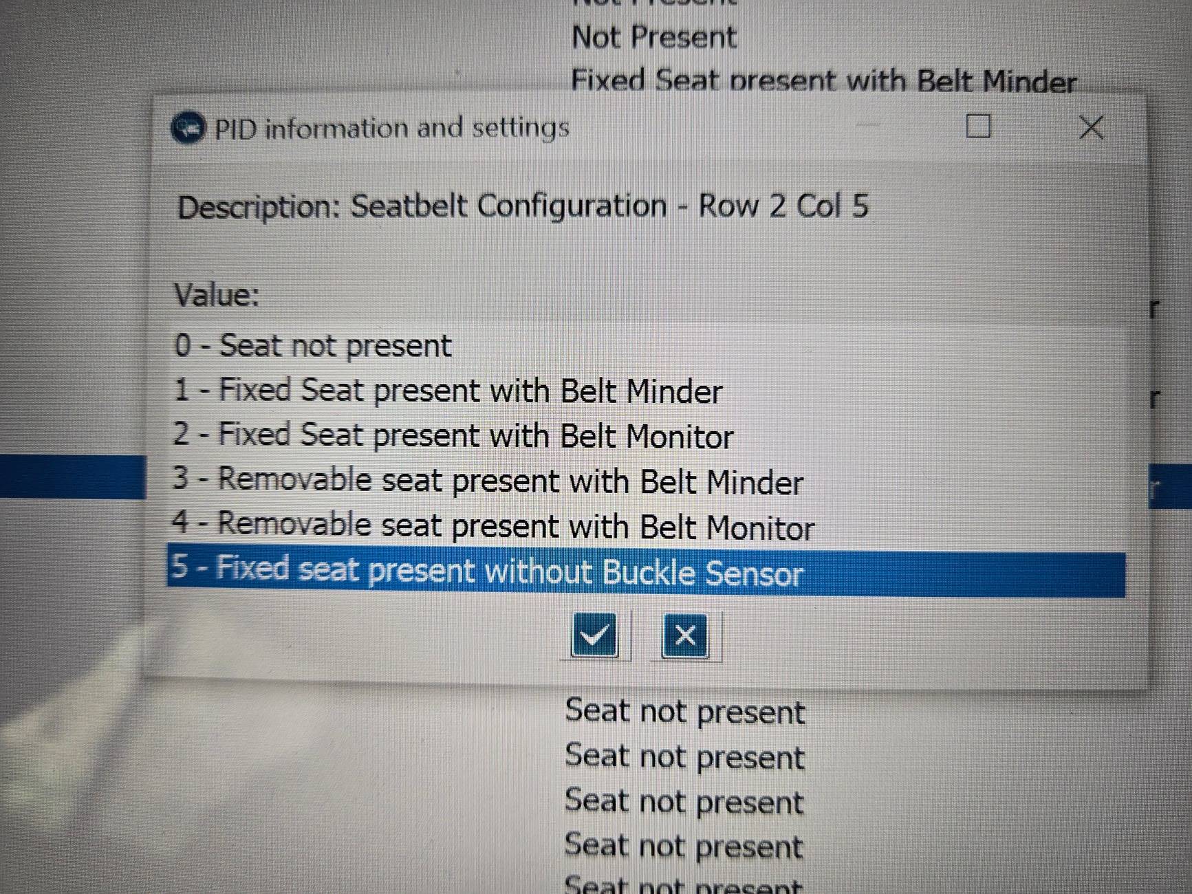

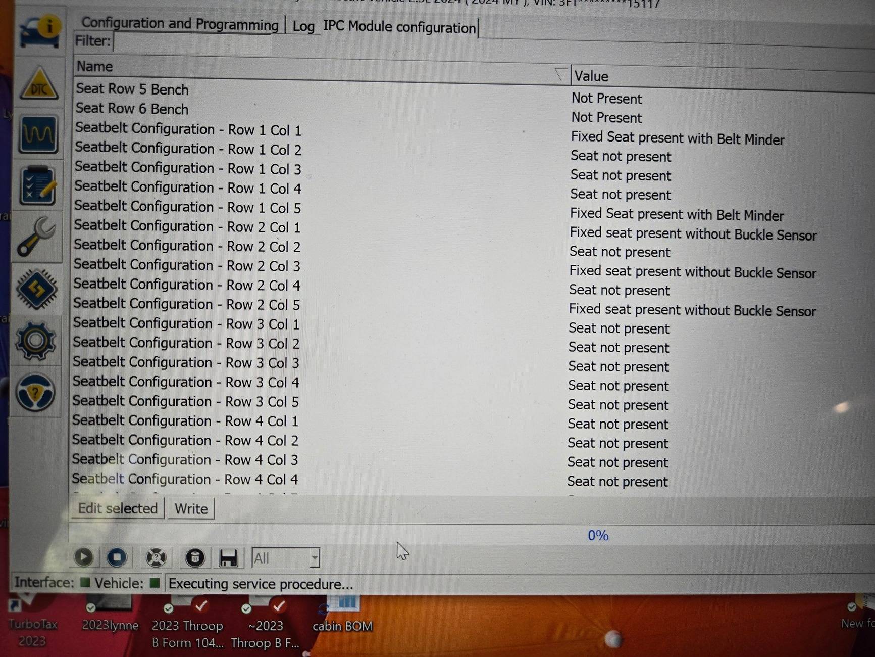

I found the Forscan method to prevent the long delay in the seat belt reminder. It is driven by the back seats so that is where the tweak needs to be made. If you use the back seat regularly especially for kids I would not disable it, but if you are like me and never use it you can remove the annoyance. The settings are in the IPC non as built. The rear seats are row 2, column 1, 3, and 5. By changing from " fixed seat present with belt minder" to " fixed seat present without buckle sensor" the reminder will only display if the front driver and passenger are present and unbuckled. When you buckle, it immediately goes away.
