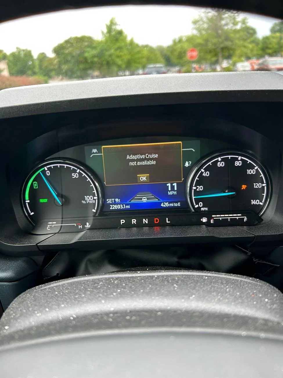

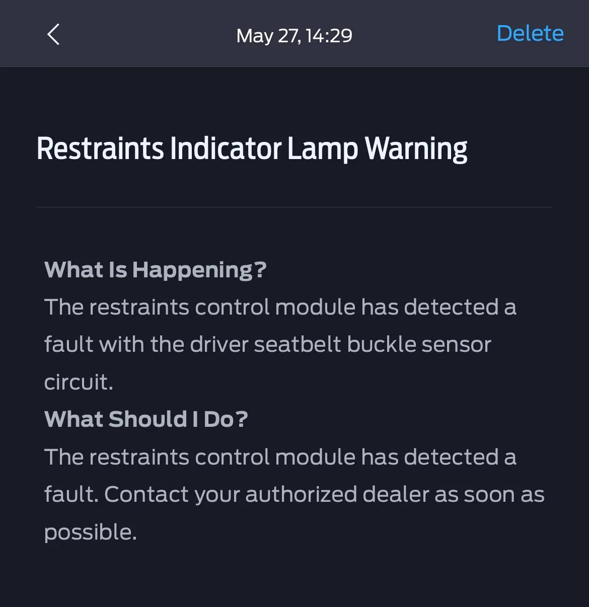

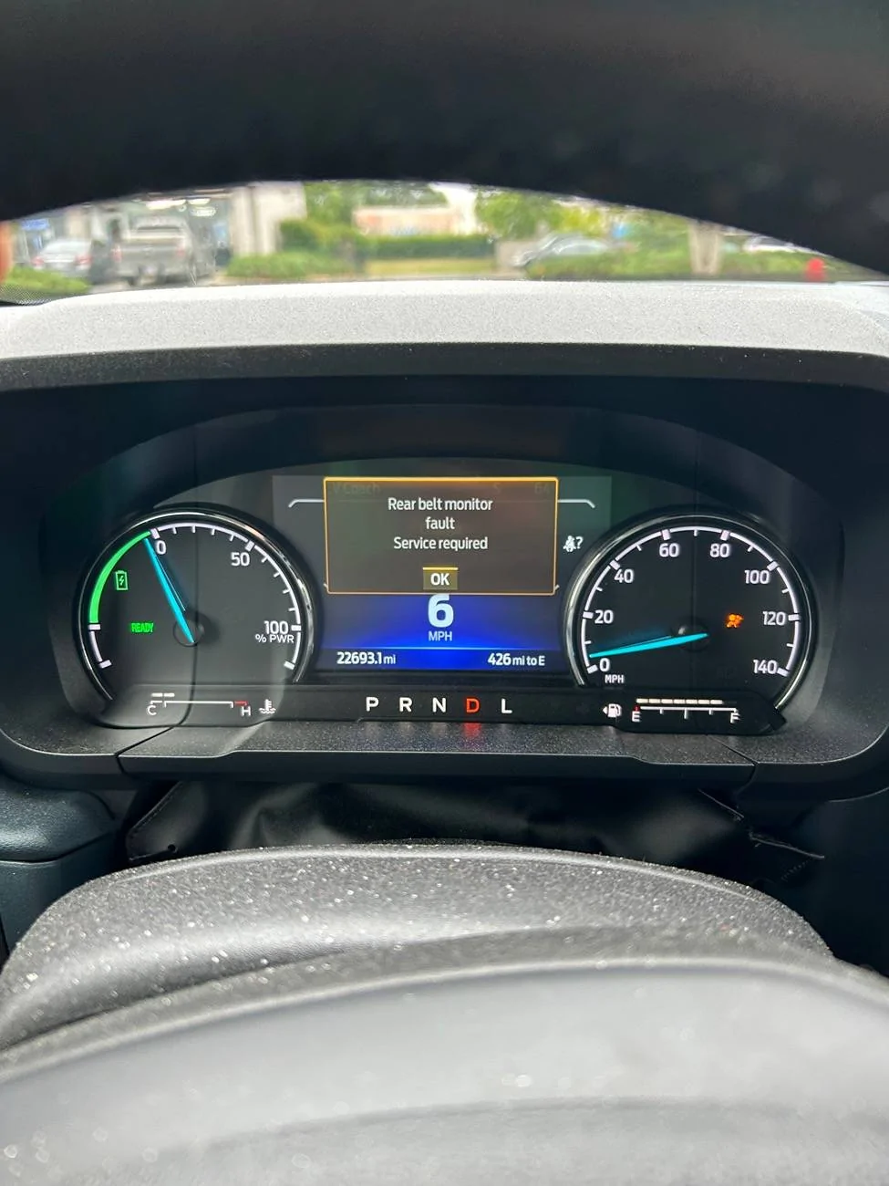

I have the seatbelt fault now, the dash error says rear seat belt but Ford app says driver belt. Adaptive Cruise Control wont work for me now. Off to the dealer I go!
