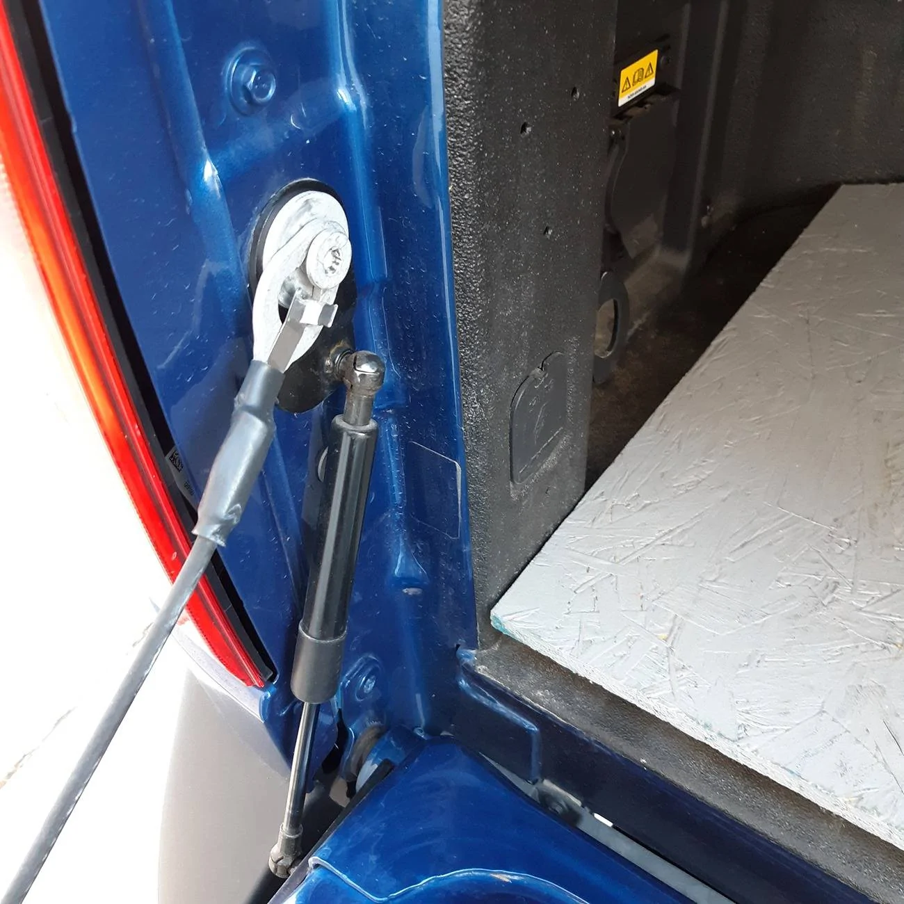

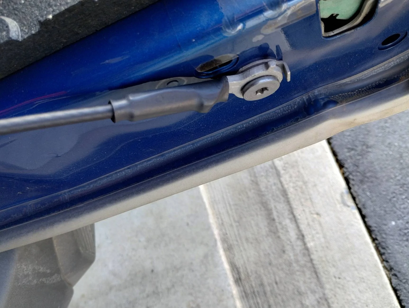

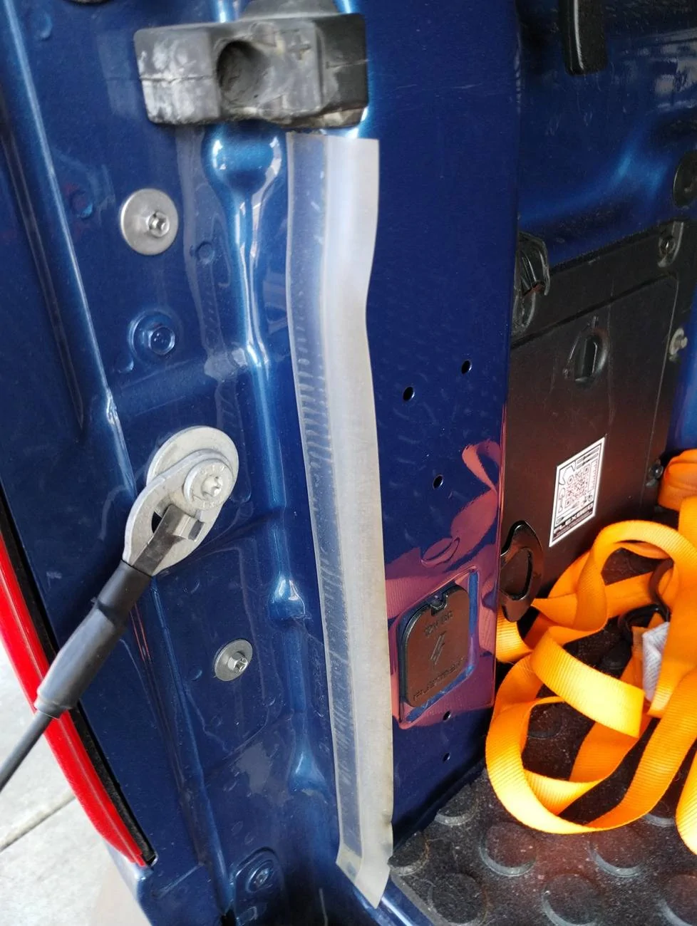

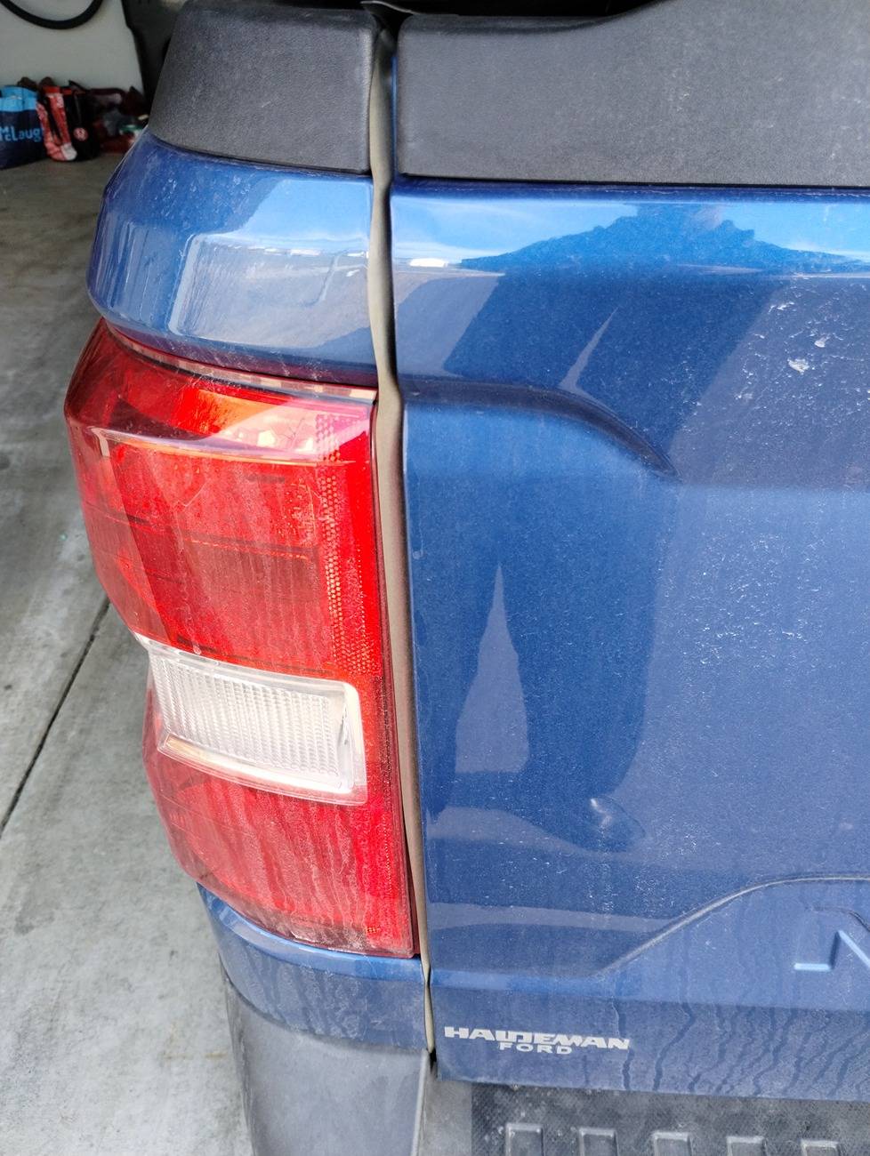

My tonneau seals out about 95%, I need to add some additional sealing to it.
The tail gate used to allow a good amount of water and dust in. I think a bit of a vacuum forms there when driving. I bought some 3M silicone flat weather stripping on Amazon for like $9. I didn't want to fork over $30+ for a specific tailgate kit (glorified weather stripping).
Ford Maverick Sealing water out of bed IMG_20250218_102512652
Ford Maverick Sealing water out of bed IMG_20250218_102523832_HDR
Ford Maverick Sealing water out of bed IMG_20250218_102532487
This worked very well. Placed on the tailgate and bed side for double seal.

Do you have any pictures of how you mounted your weather stripping on your tailgate.
I added the above. I had to save and then switch browsers, come back and edit the post. Upload wasn't behaving well with brave browser.
This was what I used. Tons of similar options out there.
https://www.amazon.com/gp/aw/d/B08BJFB2CD?psc=1&ref=ppx_pop_mob_b_asin_title
I think I may find an adhesive channel style weather strip and use that next to catch and drips my tonneau seal misses. Run the channels out to a drain like the more $$$ covers do.

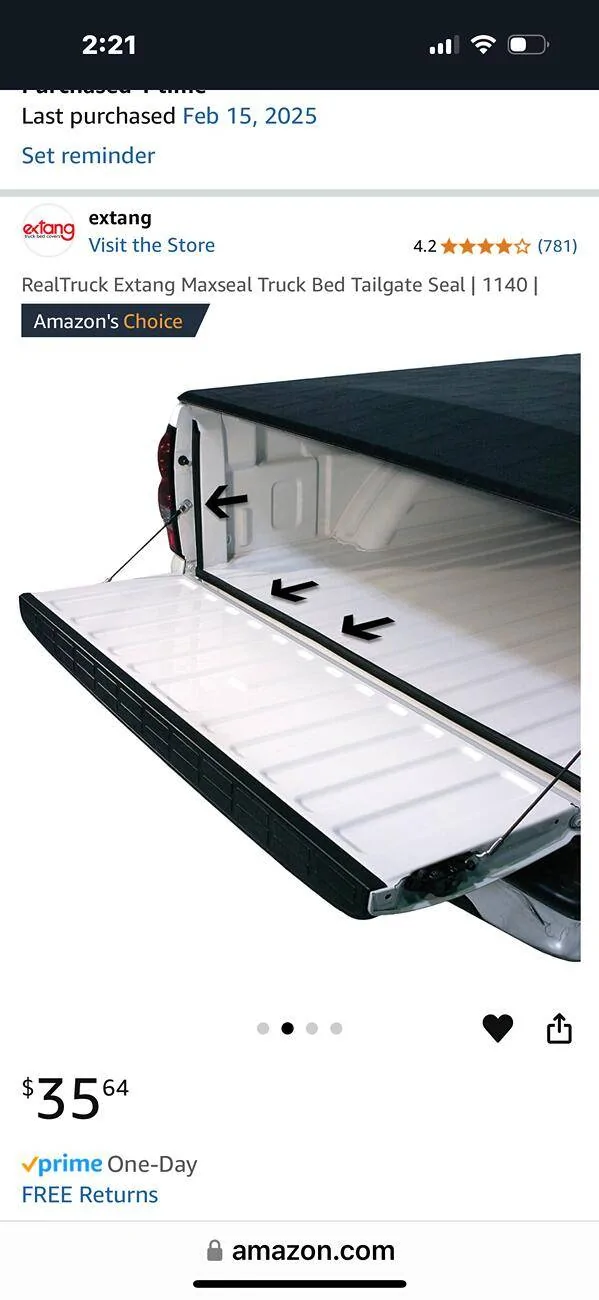

Thank you for the fast reply and the pictures. 👍
If you took the pictures with your phone you can instantly post them to this site.
Without having to download anything. It saved a whole lot of time.
I would have to shorten up the weather stripping a little bit to accommodate my slide-out tray

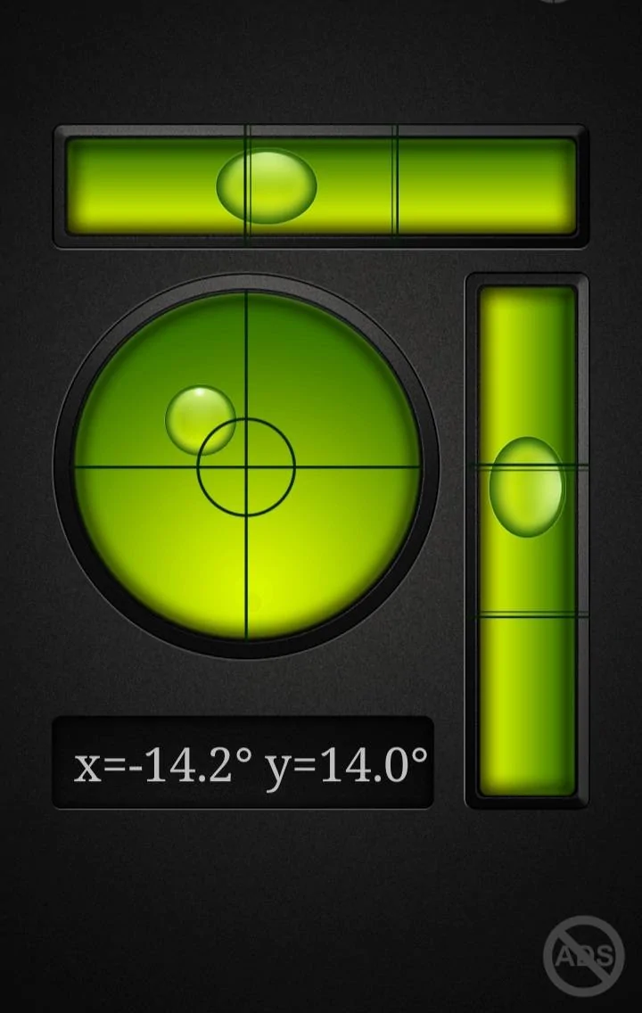

Took me 7 minutes to take the picture and make this post.
All done on my old phone, that has no phone service. I just use it as a handheld computer, camera, video, voice recorder, handy flashlight and even a quick convenient bubble level. All that fits in my shirt pocket.

I'm gonna give something like this a shot, the single bubble one I got with my rollup cover isn't large enough to seal up anything.........did this last night on just the tailgate and I'm happy with it, and got plenty of product to experiment with. Got the hose out and sprayed with a mist and it's doing what I want.
Yeah, the gap is quiet large between the gate and the bed. Applied right this does a decent job. One layer in the lip of the gate and one inside on the bed is pretty effective. I still get some ingress but that happens more at where the tonneau come into play. Highest level tonneau cover don't prevent water ingress, they mitigate it with a drip channel. I may eventually DIY that in combo with my cheap cover.
