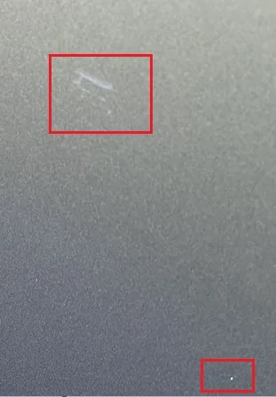

I've some minor scratches on my Maverick passenger door, no clue how it happened:
I haven't done any touch up on vehicles, although I've done some on walls, wood and appliance finishes.
Which touch up paint would work best for this minor, but annoying scratches?
Pen:
https://touchupdirect.com/touch-up-paint/ford/maverick/#pf-color=213821
Brush:
https://www.automotivetouchup.com/touch-up-paint/ford/2023/maverick/
Thx...
is the color coat scratched or just the clear coat? looks like you got a scratch and a chip.
anyway I'd try some polishing compound on the upper blemish and a paint pen on the bottom one.

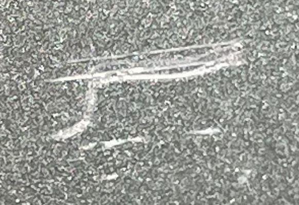

Correct me if I am wrong, but... AFAIK, the Maverick Lariat's paint does not have clear coat finish.
It seems on the enlarged image below, that the paint had been scratched and in addition, the primer coat is scratched as well:
Ford Maverick Scratch touchup paint... scratch2
The actual size of the scratch is smaller, roughly 0.50" long and 0.25" wide. There's a small level difference between the paint color and the line that I called primer. The chances are that this had been something bouncing on the road, maybe a rock, that hit the door.
I don't mind trying the polishing compound, but if does not work, will need to use touch up paint anyway. Wouldn't that require removing the compound first?

My incoming Tremor has a clear coat can't say if yours does
polishing compound usually doesn't have any wax and wipes clean. I'd clean the surface with alcohol regardless.

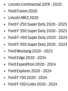

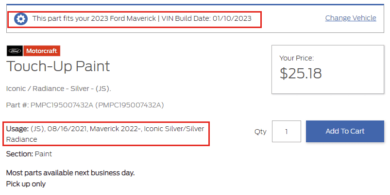

I tried from Motorcraft and the site has conflicting information, like this:
Ford Maverick Scratch touchup paint... 1697576630084
I didn't even know that the secondary name for the Iconic Silver is Radiance Silver. The list of "Fits these vehicles" does not have the Maverick listed in any years:
Ford Maverick Scratch touchup paint... 1697576808634
The text on the touch up paint picture has one color code of "JS", that's my Maverick's exterior color code. I'll probably call the local dealer, not part of the dealers at Ford Parts, and order one from them.
Ebay pretty much has the same listing at the same price and couldn't find it on Amazon. The latter one brought up all the different shades of silver, but not the Iconic Silver (JS).
