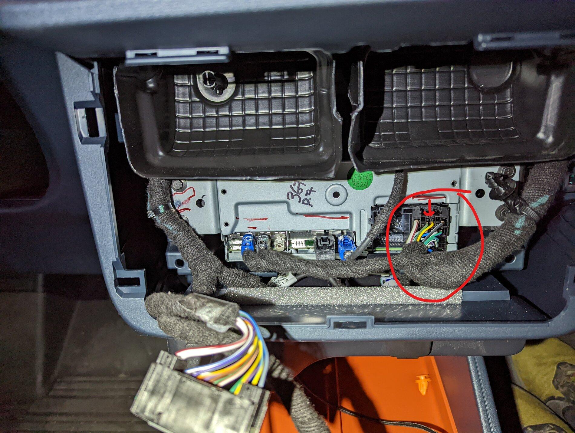

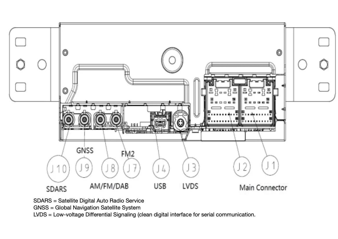

Good question. I've researched this question quite a bit and it is interesting, because the same ACM unit Harman makes for Europe and it has a Satellite Radio antenna input and SiriusXM can be enabled. But I've not found one that I can actually buy. I gave up when I got my XL and installed a SiriusXM Commander Touch Radio with separate display.
For comparison, this is a photo of the XL ACM connections. Please ignore the red circle, but notice the blank to the left of the blue GNSS connector. On the European Harman CTR, this empty spot is the SDARS which is Satellite Digital Audio Radio Service. See, the next diagram from the Harman CTR Manual.

I rented the Maverick shop manual from Helm for a few days to better understand the Maverick infotainment system and the difference between the standard radio and Sync 3. And I discovered some information that leads me to believe all Mavericks have a SiriusXM antenna factory installed. The shop manual says that the cellular signals for FordPass are received by a cellular antenna integral to the roof antenna. The shop manual also says that the radio gets its compass heading from a GPS antenna, also integral with the roof antenna. The wiring diagram shows an XM antenna integral with the AM, FM, cellular, and GPS antennae in the roof. The parts directory says that there is only one roof antenna that receives AM, FM, cellular, and GPS, and it receives satellite radio as well. All Mavericks can receive cellular through Ford Pass and have a compass display. Therefore, I am led to the conclusion that all antennae in all Mavericks can receive satellite radio as well as cellular and GPS.
The wiring diagram further goes on to show that there is one coaxial cable carrying both AM & FM signals that goes to the center input on the back of the radio head; and another coaxial cable carrying GPS and satellite radio goes to the outermost input. The third input, the innermost, is not used in North America, since it is for Digital Audio Broadcasting, only available in countries in Europe and elsewhere. Therefore, you should be able to use a male Fakra to male SMB adopter (available from Amazon) to connect that outer co-ax cable to an after-market SiriusXM radio - if you are willing to forfeit the compass display - and, if required, the Sirius antenna selector to the factory radio with a female DIN to female Fakra adopter.
Also, you might want to experiment with Ford’s GPS/XM splitter, Ford part No. 10E928, and see if you can use it to reconnect the GPS to the radio.
