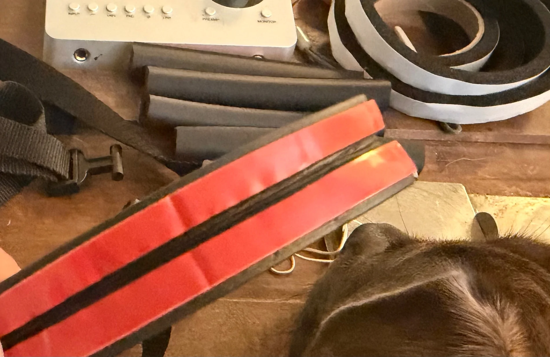

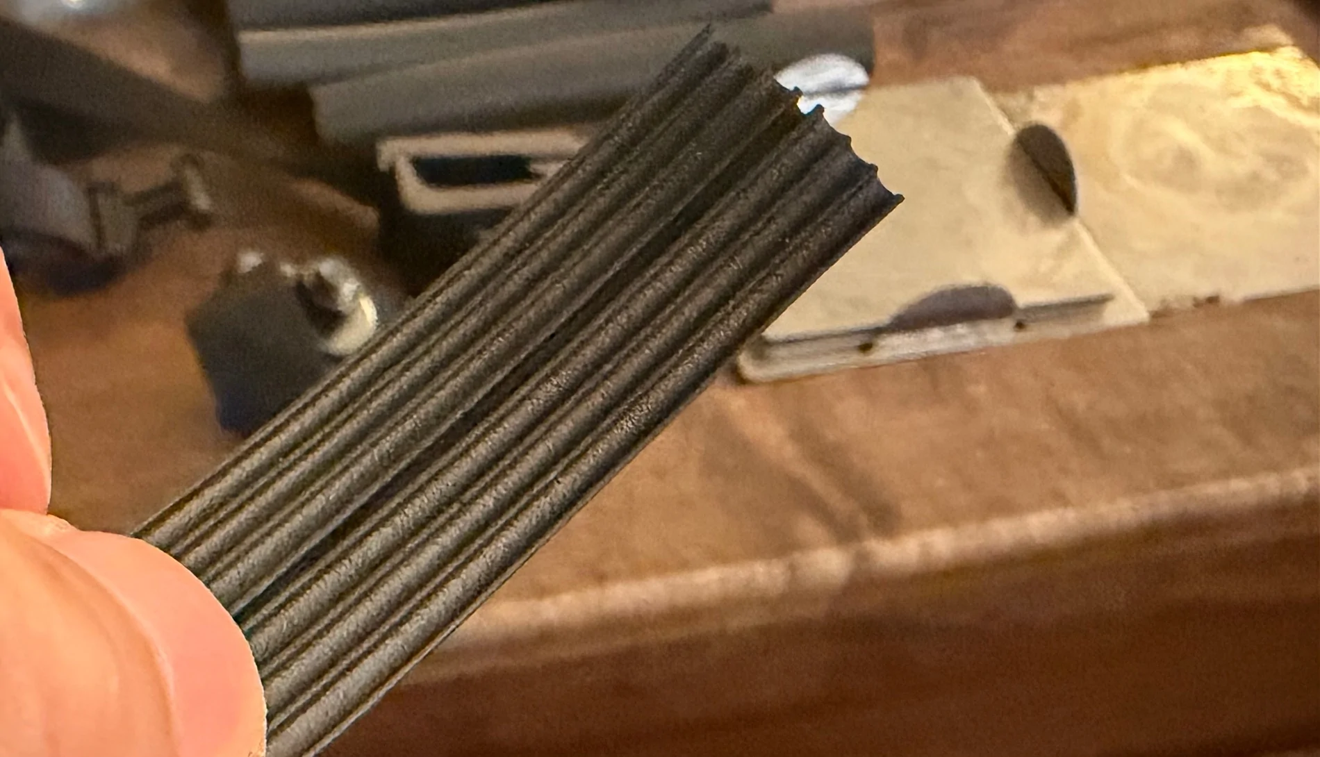

There's no printed instructions or parts list to consult, and the installation video doesn't show or make any mention of this.
It's a small roll of ribbed rubber with an adhesive backing. Roughly* the same length as the bulkhead seal, though much thinner.
So before I get going, I reckoned I better ask: where the fuck does this stuff go?
*-a few inches longer, but not enough to really matter.

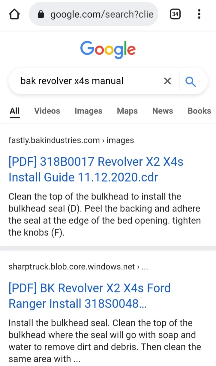

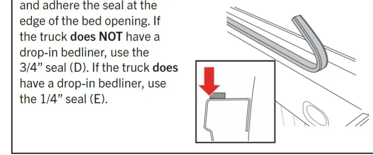

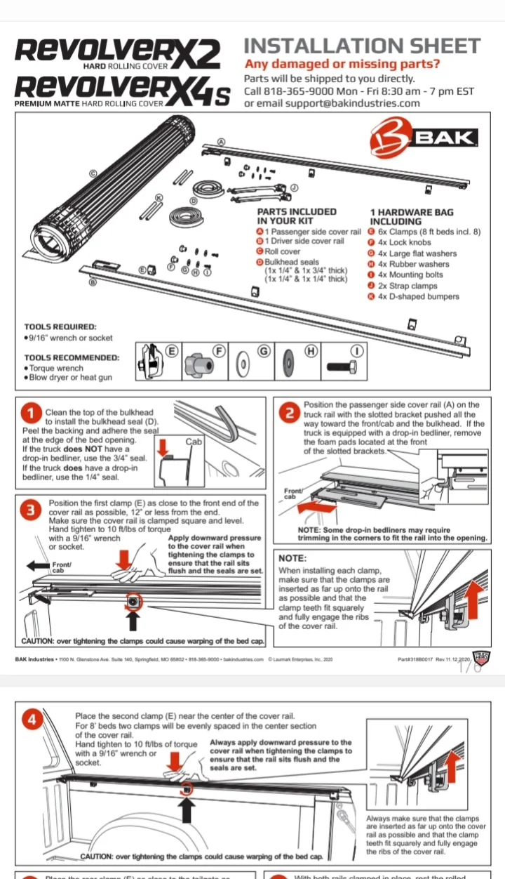

I don't know if it'll help. I found some instructions online and downloaded them. They are still pretty terrible though. Beats nothing at all.
I haven't looked for any YouTube videos.
A lot of times the boxes will have one of those Square scan areas that'll come up with your instructions and sometimes videos.

Ah. An alternate bulkhead seal. Got it.

It's an alternate bulkhead seal pal
