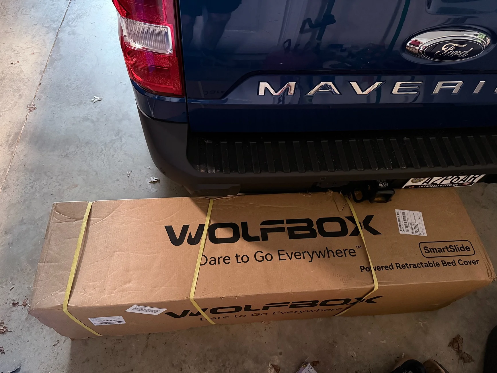

The package from Wolfbox came very quickly. So quickly, in fact, I was not even expecting it and was out of town when it was delivered. Thankfully, a neighbor moved it out of a rain-exposed location until I could return home the next day. The box itself was massive. Due to the rain mentioned above, I had to install it in the garage. Given that the garage is a little tight, I had to be a little creative with the instructions and use my recent high school grad to help.

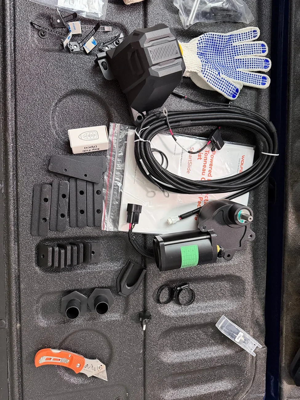

Sampling of parts (the knife is mine)
The actual assembly was fairly straightforward. Every part lined up exactly where it needed to be, and I had zero issues putting it together. The instructions include graphics that have indicators for the exact parts you need. The drilling I needed to do for the drain holes was easily accomplished with the included drill bit. In a few cases, I preferred to use my impact drill rather than the included Torx wrench.

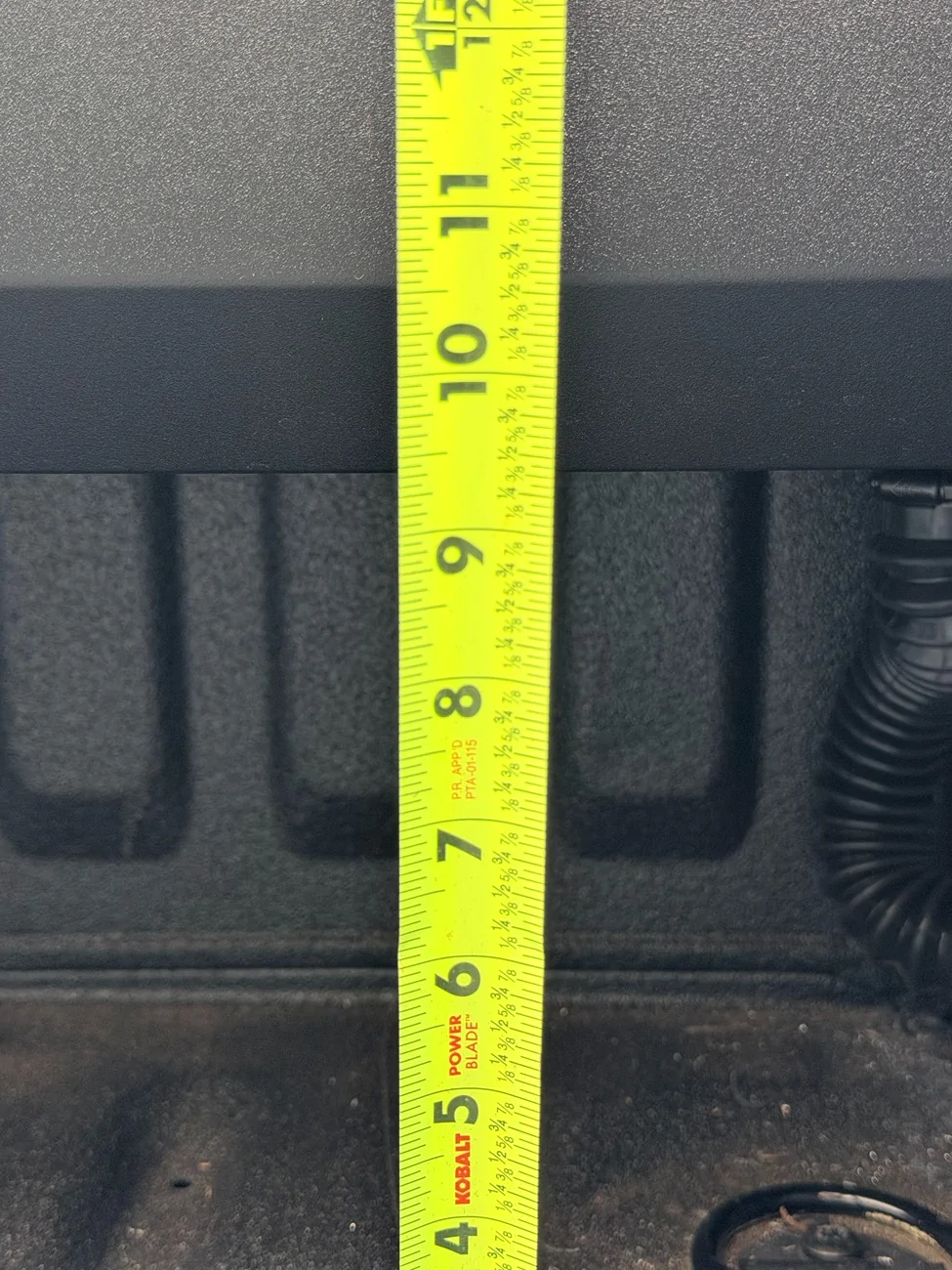

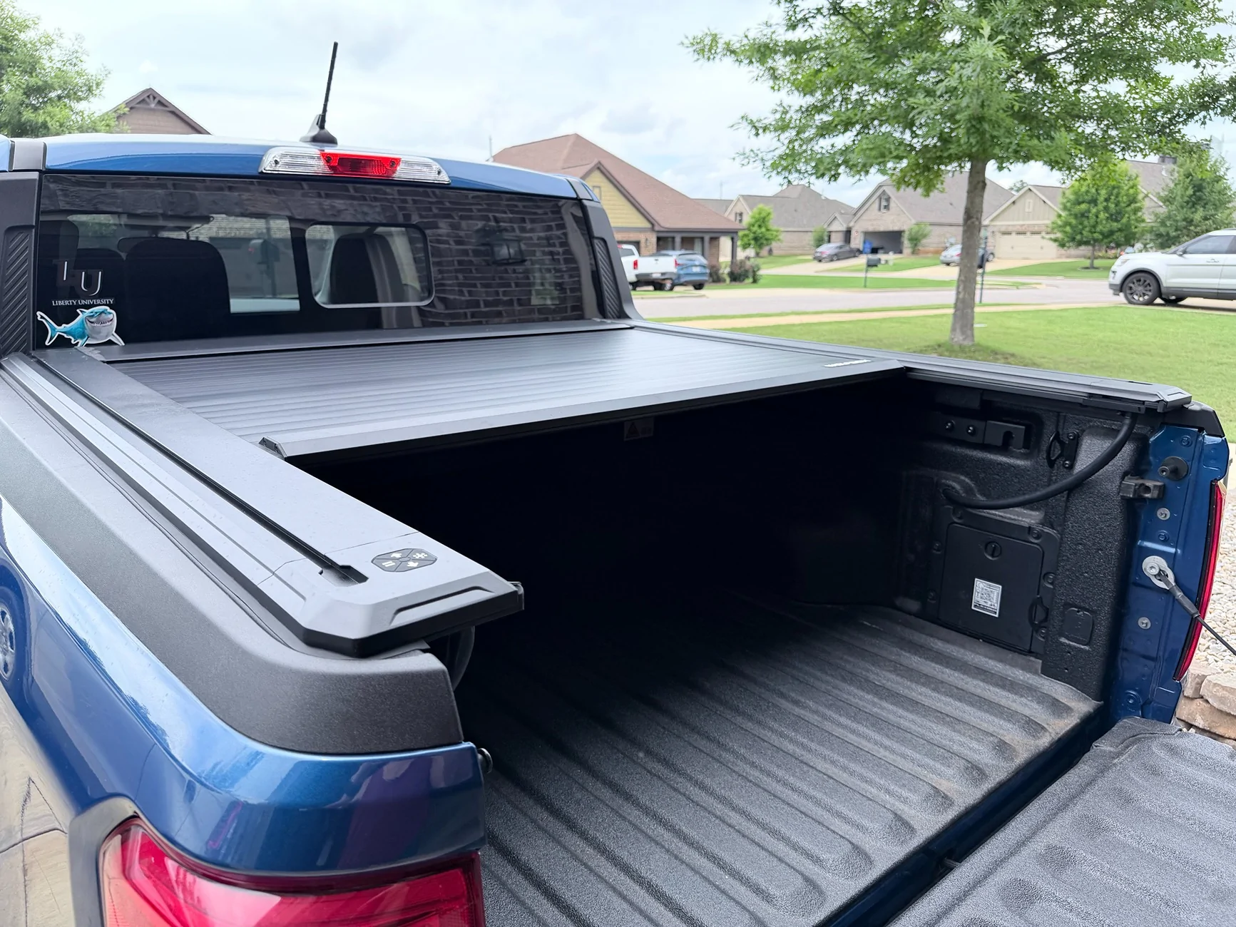

As for my feelings on the bed cover itself, it is an amazing addition to the truck. I do not feel it takes up too much usable space, given my usual use. The construction appears to be solid and durable. Compared to my previous cover, this one appears to be a bit more water-resistant. However, I have not had it sit out in the rain yet.
Ford Maverick Review - Wolfbox SmartSlide Electric Retractable Bed Cover IMG_2133
Depth

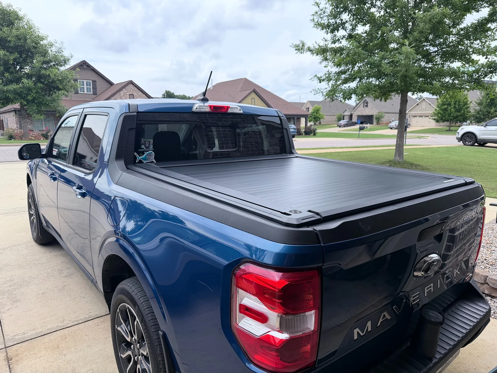

Installed and Closed

You can pause opening and closing at any point
I will be driving it to a Boy Scout camp next weekend, so I will be able to really test it in a real-world setting. However, my hopes remain high that I will continue to like it. I have been eyeballing something like this ever since I got my truck, and at the moment, I could not be happier with it. We will see if that opinion remains over time.

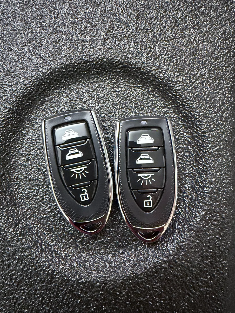

Comes with two keyfobs
