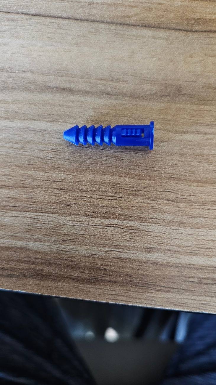

Go to Homedepot and get those screws that come with the wall mounting assembly. The ones that you drill a hole in a wall then tap the assembly in the hole.
They come in all different sizes and colors. If it's too long, you can just cut it to the depth you need. You'll be able to screw in the original screw or another spare one. Cheap but strong and reliable fix. I used these when I drilled holes too large when I was hanging a door. Worked like a charm.
I'm a pack rat. Got tons of various size wall anchors not used from projects to try. Great idea.

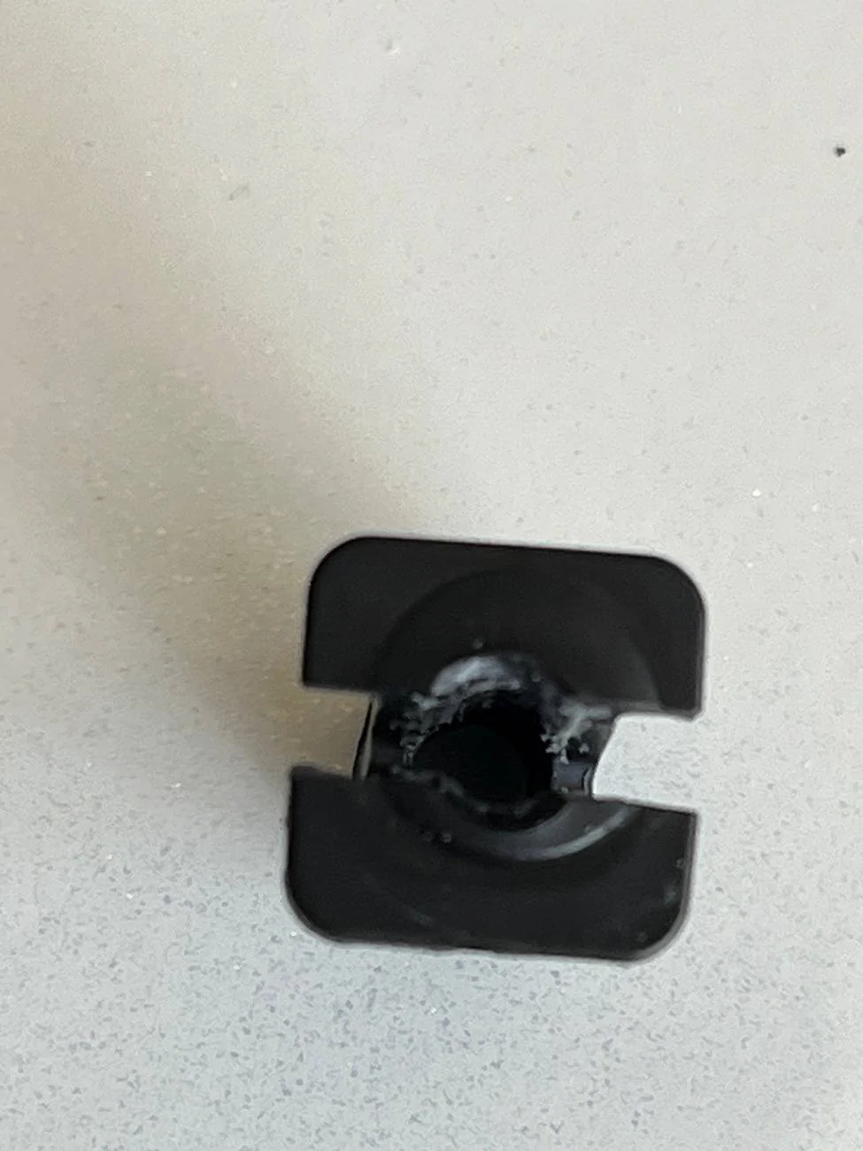

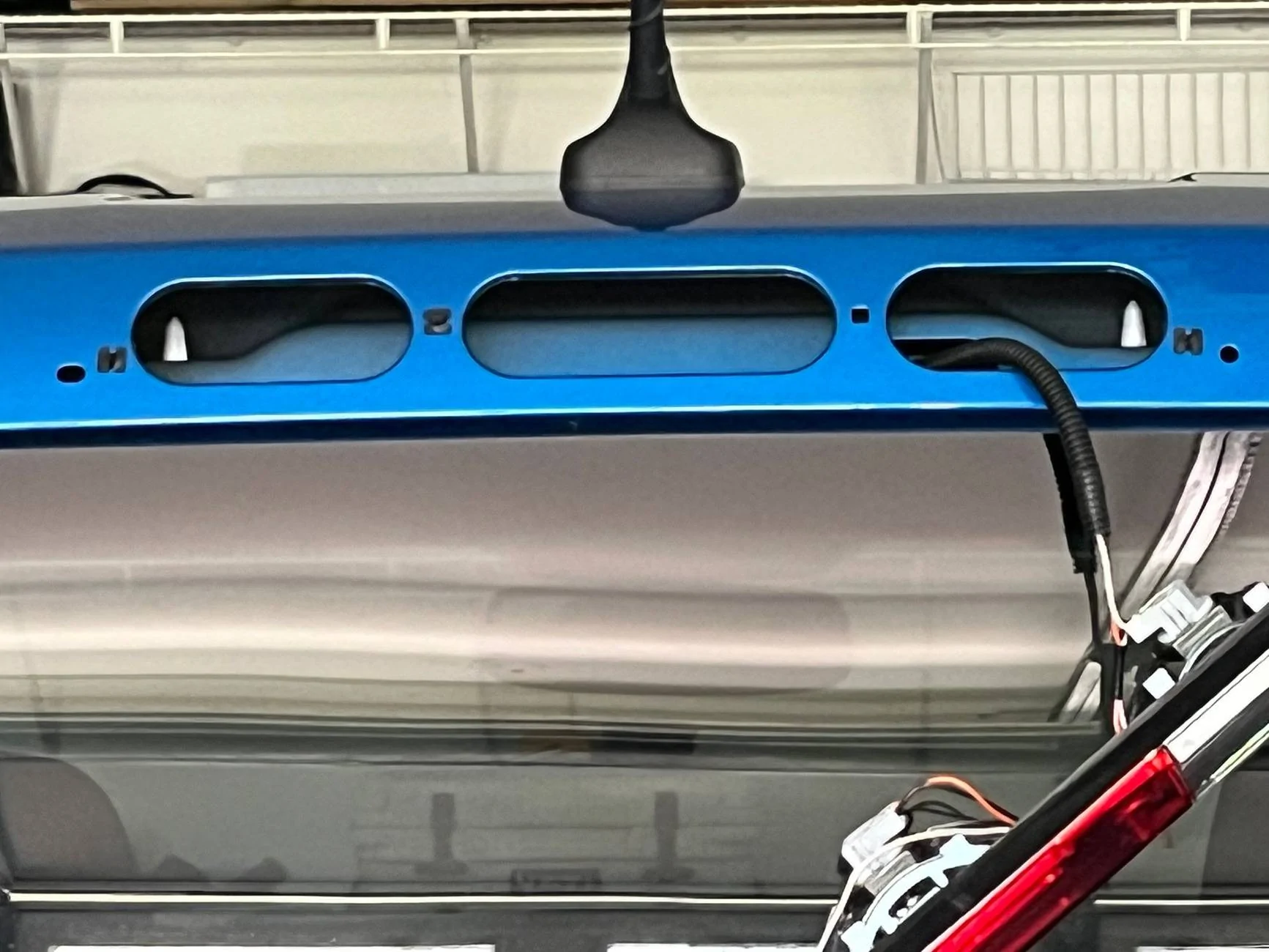

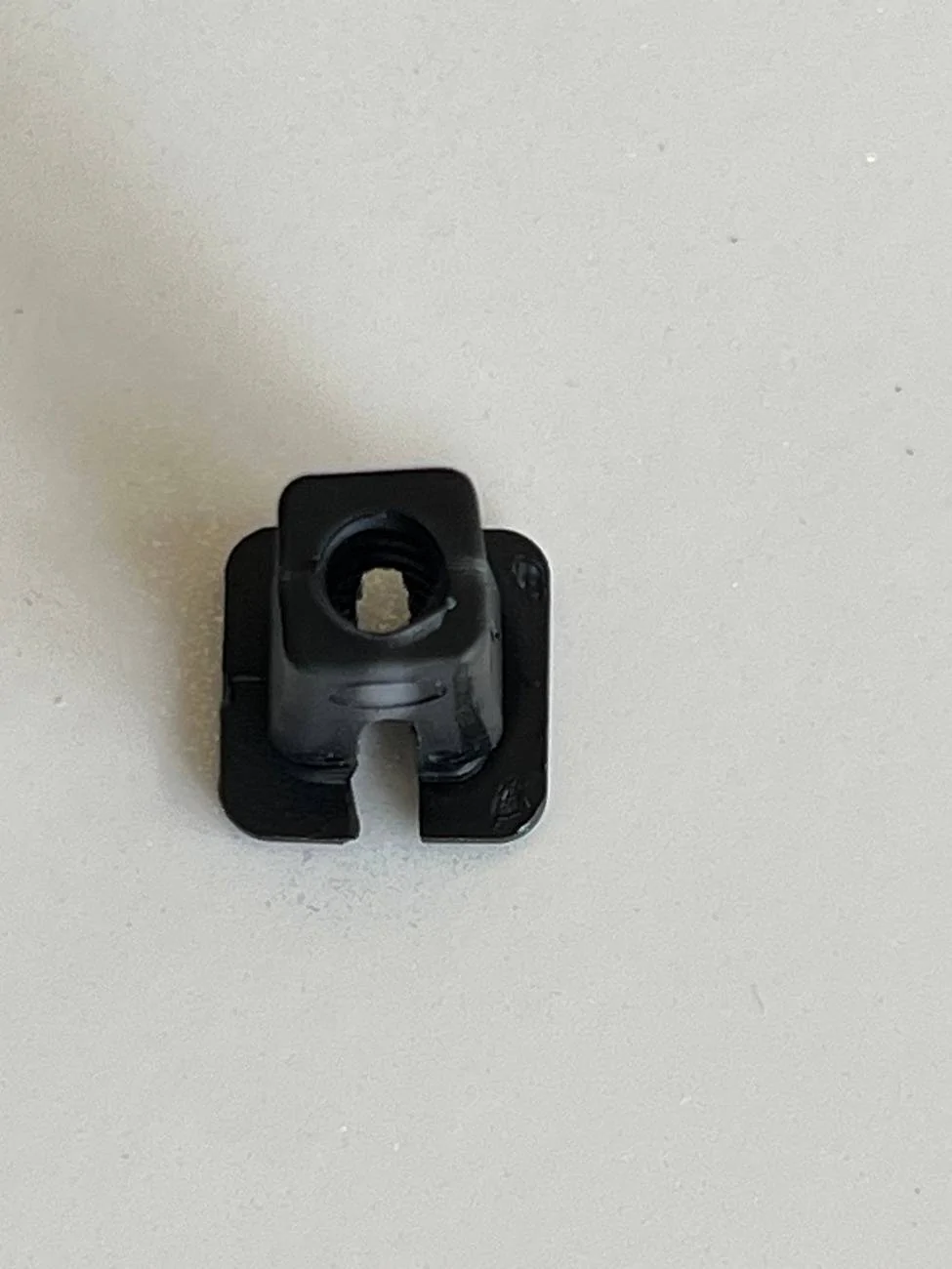

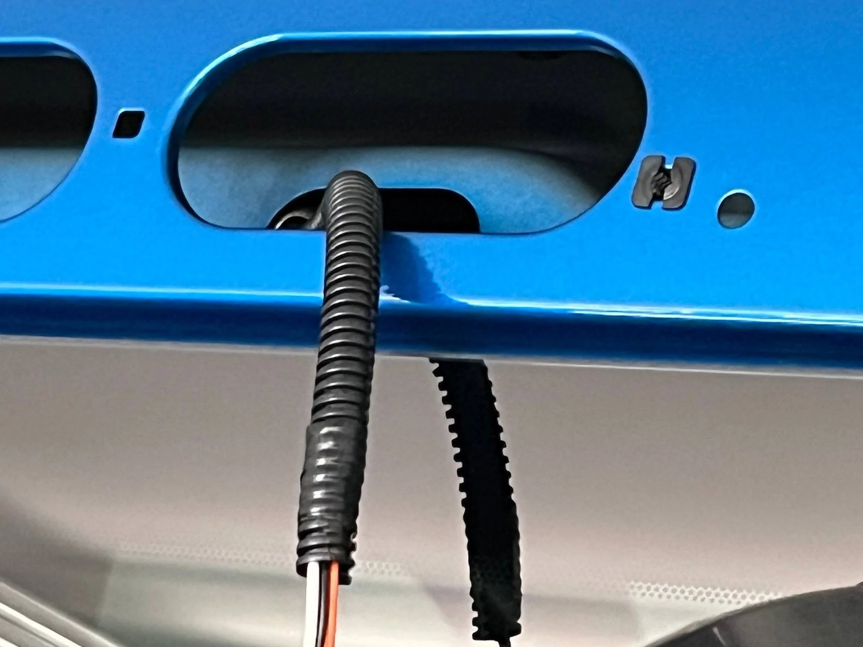

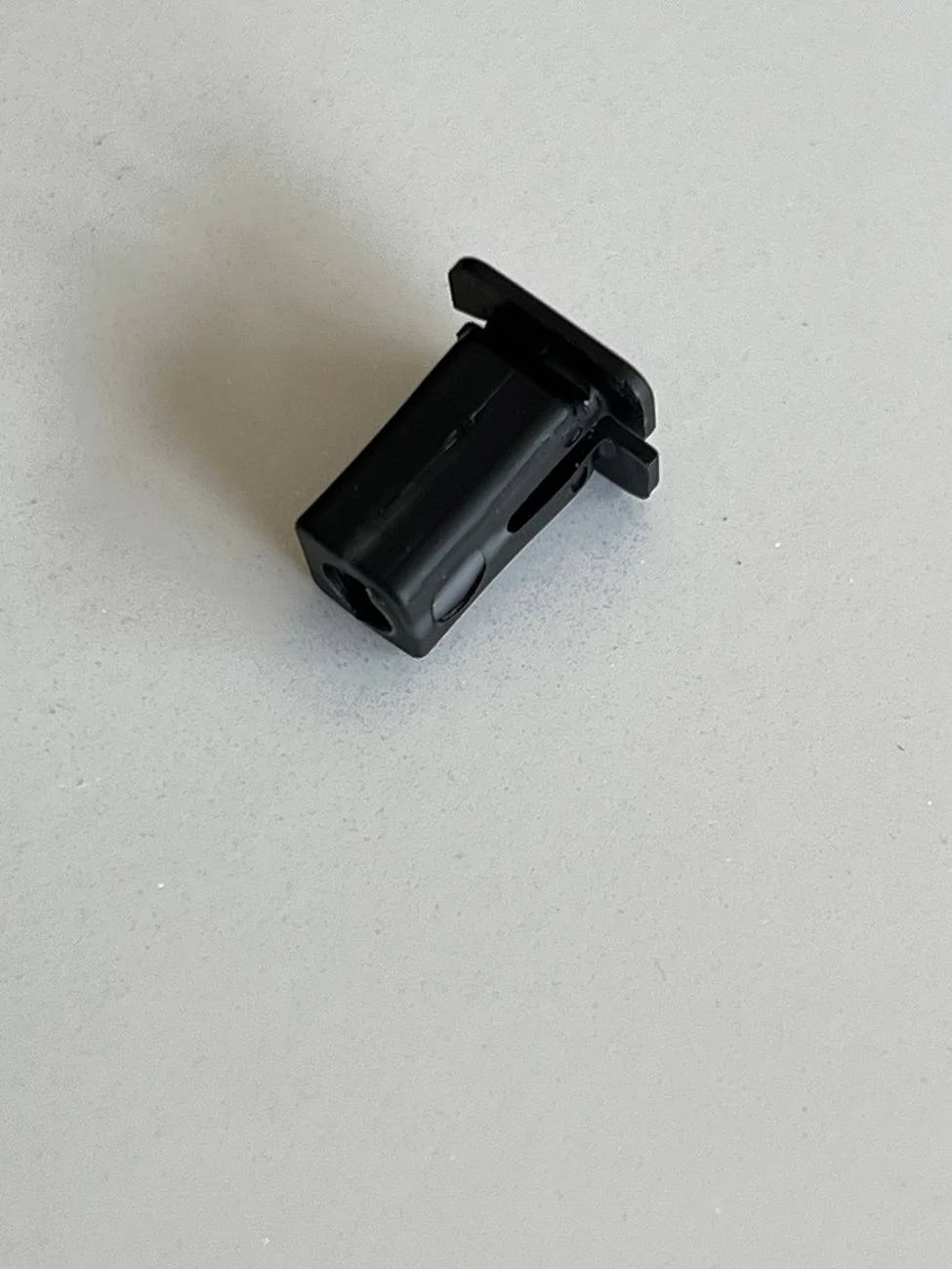

So here are some pics that show what your dealing with. They should not be installed or removed with a power tool. Its the black plastic grommets that are the problem, not the screws. I am convinced that some are stripped at the factory based upon my experience.

Thank you very much for the photos. I have a new 24 Lariat and both of the middle screws have this issue.
