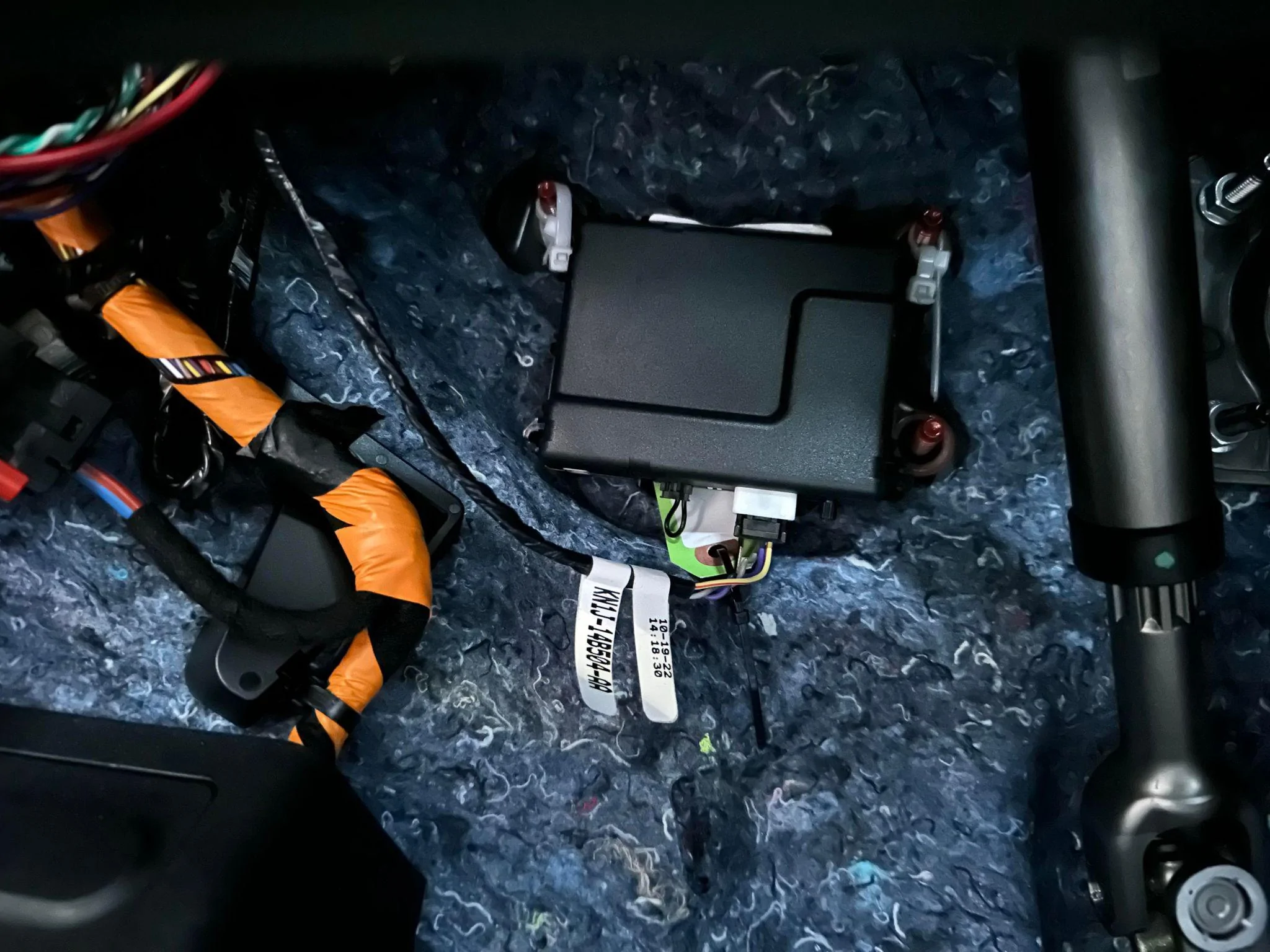

Can you take a picture of how you have the module mounted? I can't seem to figure it out. I can tell you one thing... laying upside down, folded into a pretzel in the driver's side footwell is not a pleasant experience. I can only stay down there a few minutes at a time.
these are to the left of the steering column and brake pedal you can feel them when you reach under there

Thank you! I saw those but no matter how I put the module up to them, I could not figure how to mount it without the plastic case rattling against them.

Thanks again for the picture! I had to put a 3rd ziptie around the remaining bolt to keep mine 100% solid. I must just be getting old because I could not do all of this in one go, I had to come out and allow blood flow back to my brain for a few minutes before getting back under there.
I have the sensitivity set to max, but when I kick my trailer hitch or a tire, I get no chirps. If I have the truck locked with the window down and give the steering wheel a slight hammer fist, it chirps. I'd really like it to make a chirping noise if my truck gets backed into or if someone is trying to steal my wheels. Have you had similar experiences with your vehicle? Can you test this on your vehicle and let me know? I'm thinking the vibrations are simply not making it to the module meaning I might need to find a different location to mount it.
I had mine go off when a cat visited my truck the other night, I set it using the roll down the window method and stiking the steering wheel from instructions I found on the web. Seems to believe as taught as I have the ties it gets the inputs it needs to pick up vibrations.
I don't have this specific unit (yet), but for the years when I installed other security system shock sensors, the best way to mount them was to zip tie them to a large harness (typically the ignition harness). That allowed the best transfer of vibration.
Based on the picture posted, I would zip tie it to the harness with the orange tape and give that a try. The way it is mounted now, the padding and firewall will absorb almost everything.
She is pretty sensitive there, it has gone off twice since being mounted there once a loud stereo going down the street set it off so I had to adjust the sensitivity and the other time someone flicked my door handle. I am happy with it there.
That's fair and I'm glad it's working as intended on your build. I was merely suggesting a possible solution to what the other poster was dealing with.
