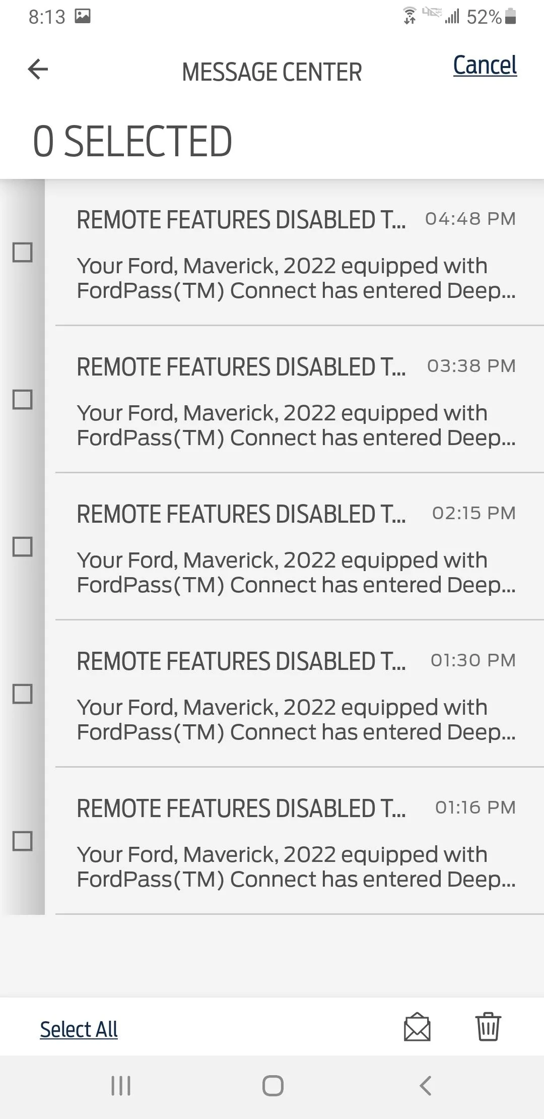

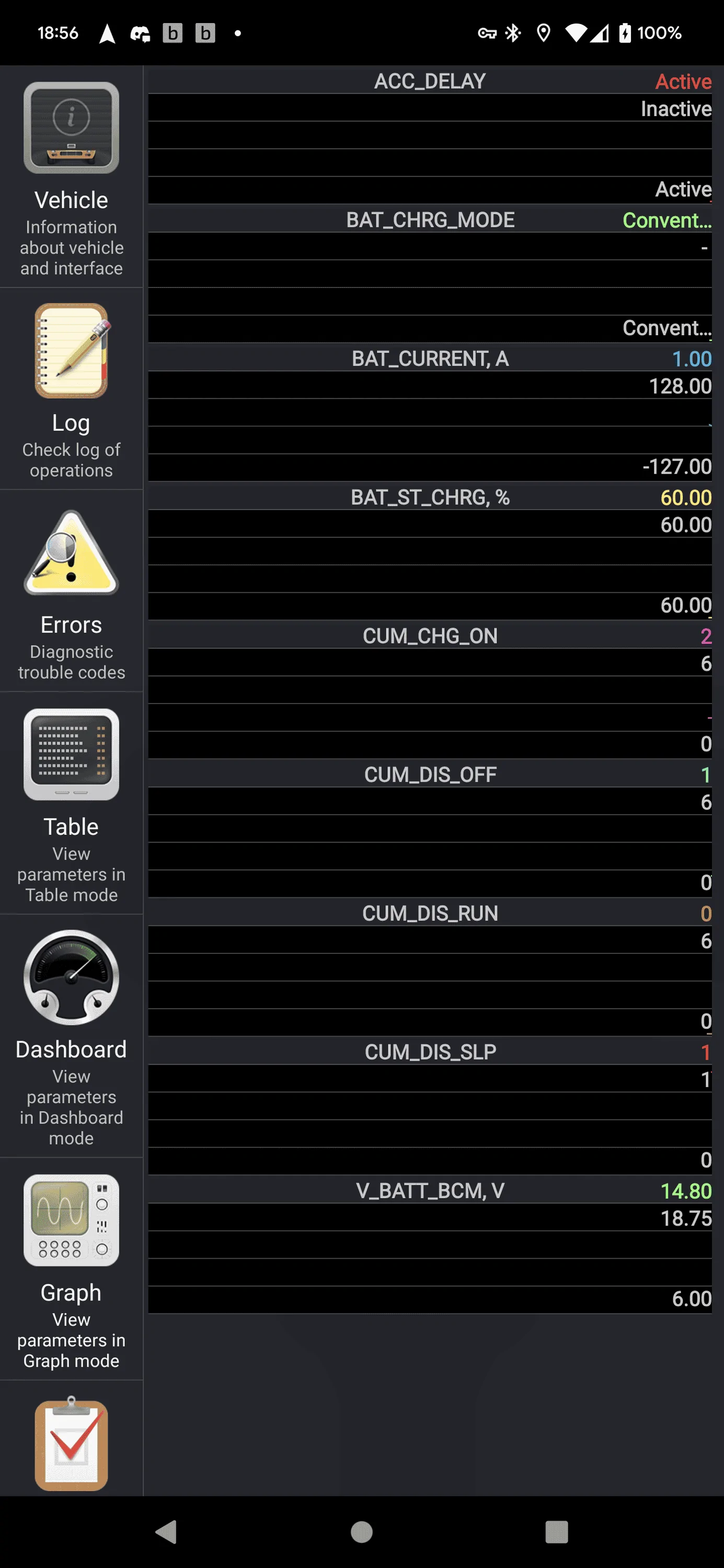

Example of a 5 min drive. However, I did have the vehicle on the trickle charger in the afternoon (shows full) and went for 5 short trips around the city, this is roughly 24h later. My NOCO G7200 was attached to the battery and after the BMS sensor. Could be failing and thinks the battery is full, need to check.
Note the SoC is at 60%, it was 59% when I first started the truck.
Tested the battery at 700CCA (not sure if it's correct), aftermarket batteries are 760CCA. Tester showed 625CCA and to recharge the battery.
I asked if remote features disabled is common and they said it's due to the cold weather. We've had a few patches of -39C/-38.2F to now - 19C/-2.2F. While it's understandable, I laughed and asked if charging the battery to 80% is normal too, which was yes.
They also added you're lucky you don't have a Mach-E as if the 12V battery dies your shit out of luck shifting out of park. Dealers solution is owners need to carry a jump/booster pack.

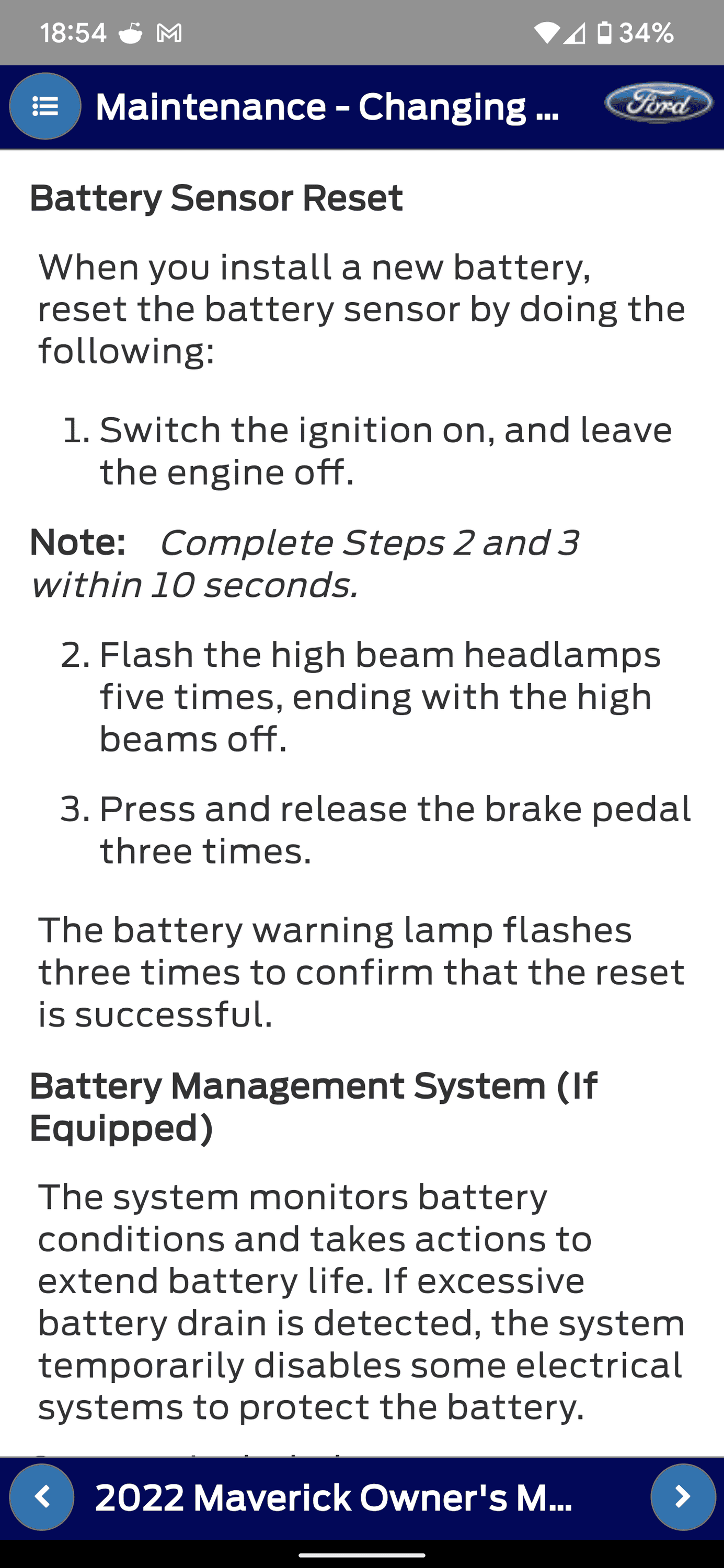

Have you tried resetting the BMS?
I reset mine on 1/16/2023 and haven't gotten the Deep Sleep message since.
