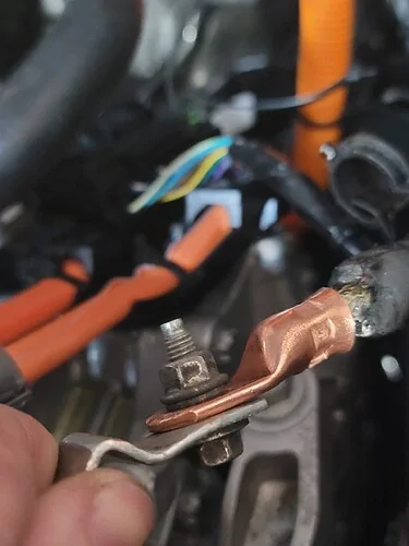

Thanks Samuel. Could you advise, do the techs get in there with a crimping tool to attach the lug? Doesn't look like a lot of space or extra cable to work with.
Cheers.
They use a pretty big crimping tool. There is enough room to move the cable around to attach it with the tool.

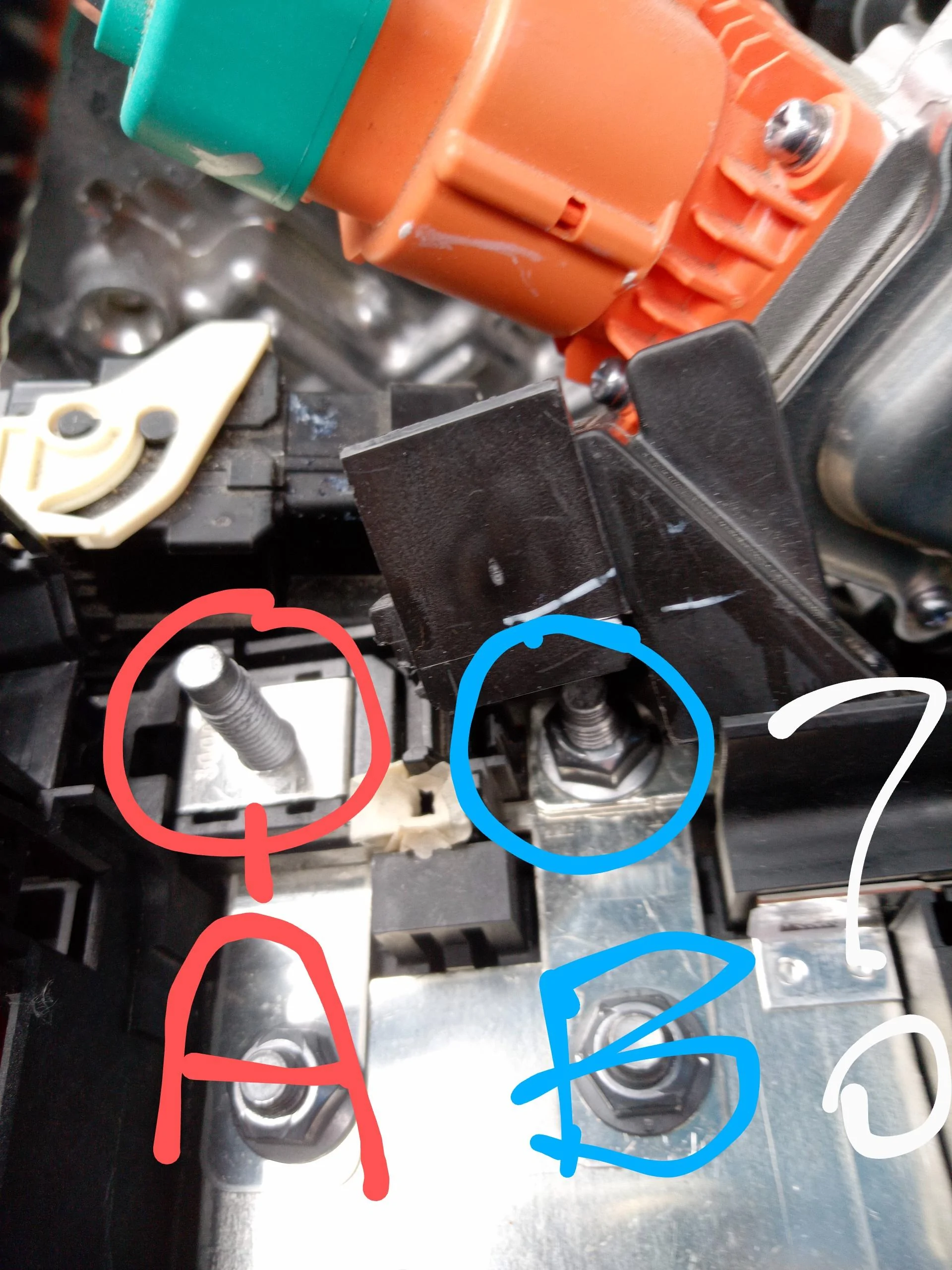

What would be great is if someone could provide step-by-step illustrated directions on how to at least INSPECT the cable end that is in question (disconnect 12v battery? Remove fusebox? etc.).
I'm still not sure if it has been 100% verified that the bad cable is the one closest to the windshield, the one with the black cover that is opened by sliding sideways (as opposed to the front one in which the cover swivels straight up.

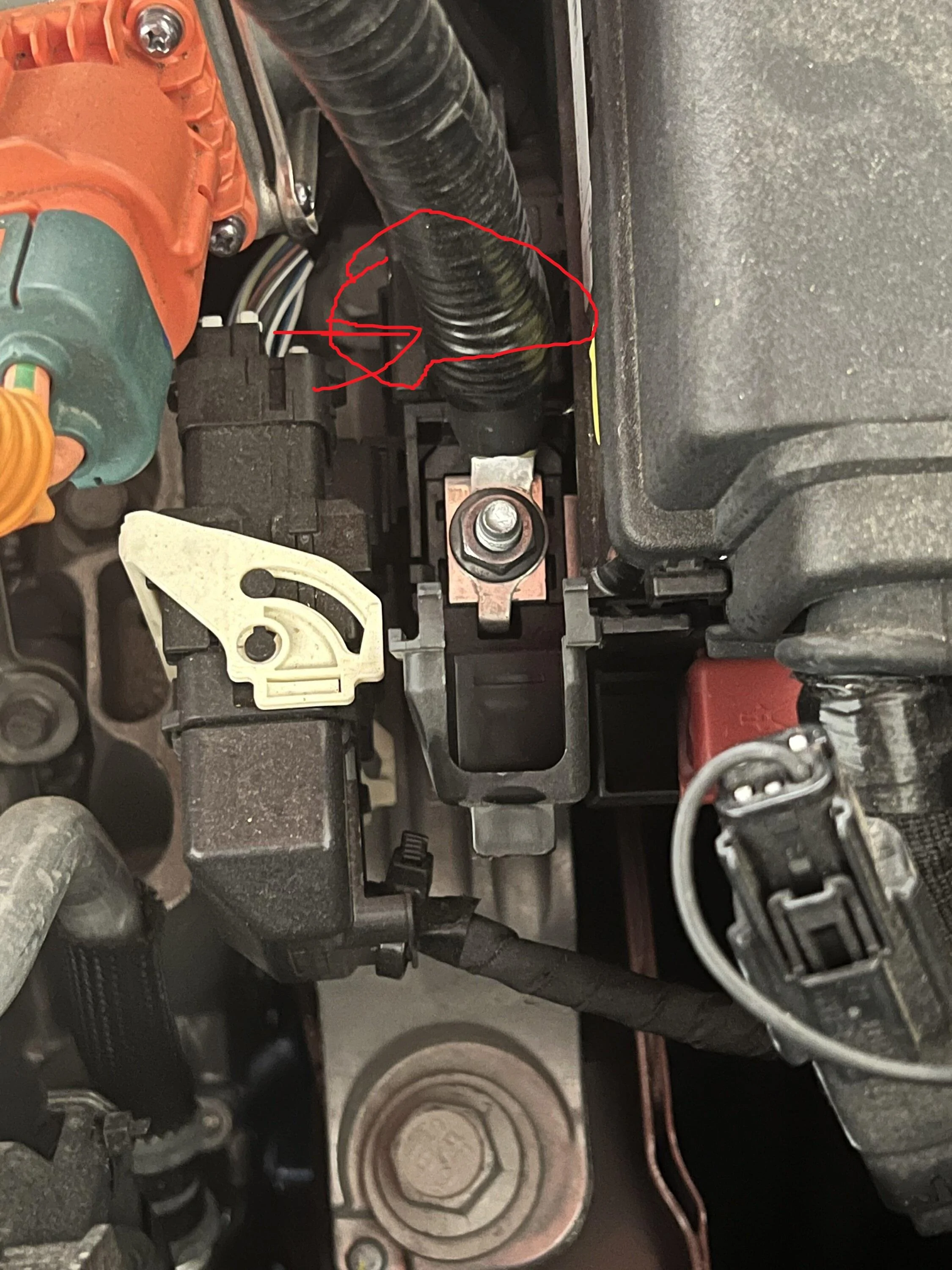

If anybody is looking for the cable lug in question, the very first post on this thread, guy has a good pic of the connection in question.
This is just one place that members are reporting as a bad connection. Theres also underneath this cable where another cable attached to the bus bar, then i have heard others talking about bad connection at the HVB relays. So the only sure way is to troubleshoot with a DVM to know which connection is defective.
Its the connection under the black plastic cover becomes disconnected/bad connection.
The cable comes from back of engine compartment/firewall and LOOPS up and forward then down to this location. Thats why i was offering if you have a dead battery you could possibly grab and wiggle this cable for a better connection. Theres tons of pictures in the first post.

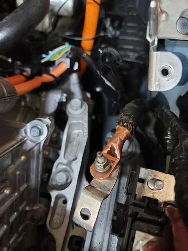

Under the black plastic cover is the battery cable with the battery cable lug that has the bad solder connection. As you can see from the pics you can grab the cable and bend it up to reveal all kinds of room to get the huge crimpers in there to crimp it.
Before you perform any work on this connection, go to the battery and disconnect negative battery cable FIRST. As the cables are hot with 12vdc.
I wouldn't crimp one myself, i would solder it and cover with heatshrink. Its not a bad job at all, i have the crimpers and have performed hundreds of cable lugs.
In the old days gone by, you could have got away with crimping, but in this high tech world, with tons of computers and voltage variations critical to digital operation, theres no way i would recomend a mechanical crimp. You might be able to get away with it as a temporary repair, however long run reliability is very questionable?

A little clarification please, reading conflicting info. Is the connection under that black plastic tab to the left of the red positve jumper cap or somewhere else?

Thanks, do you happen to know what connector we are talking about?
Check out
Gullzway response up a few

this is for sure the one
