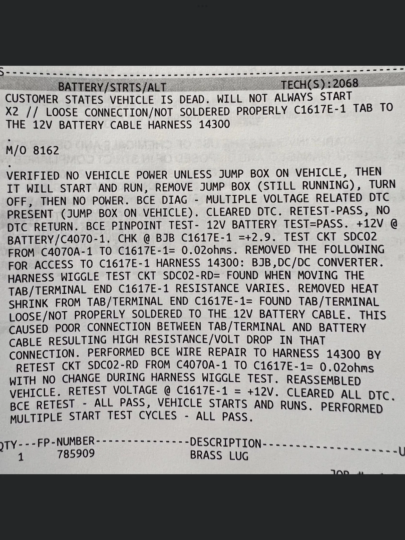

Right, I haven't seen where anyone thought it was the actual bolt.Again, there's some misunderstanding here. The "cable lug" that was installed here is not the bolt everyone is talking about. Every Maverick comes with that bolt and a factory cable lug for the positive terminal. The soldered connection that is failing is where the harness is connected to the factory cable lug. In this instance, they peeled back the "tape", saw the faulty solder, threw out the old cable lug, installed a new one, and resoldered the harness. The bolt everyone claims is the new fix literally just attaches the cable lug to the terminal. New or old.
