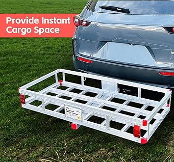

I didn't see anything in the search for receiver hitch carriers. Has anyone used one of these hitch carrying devises. I have some cargo I would like to haul that is about 270 lbs. worth. I would be getting one with a drop downside to load the item.
Just wondering about truck driving ability and such if I get one. Any advice will be appreciated.

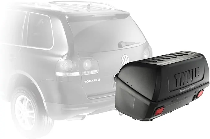

This is the only one I have experience with on the Maverick.
Ford Maverick Receiver Hitch Cargo Carrier Thule Transporter
It works great if you need some watertight storage but is only rated for 150lbs so I'm guessing it wouldn't work for what you need and probably isn't tall enough either.
I'm still trying to determine the "tongue weight " rating for Maverick XLT Hybrid for towing; once you know that, then i guess you can calculate the carrying capacity of the carrier. I have a carrier but haven't used it yet.
Does anyone know the tongue weight rating?

I have an XL AWD with 4K towing package. Besides all the other concerns like taillights, license plate, rear backup not working etc.. my concern would be if I can handle 265 lbs. of weight on one that it does not affect my steering or operation of the truck?
I think the numbers are 10% of weight can be on hitch. So, if 4000 lbs. towing capacity then 10% hitch weight I would be okay because that would figure out to 400 lbs. on hitch. I would be fine with 265 lbs. just on hitch.
The thing is I'm not sure if that is how it is figured for tongue/hitch weight though.
Any help to see if I would be okay to carry that weight for about 25 miles a couple time a year.
I assume it's the factory installed hitch mounted to the frame~~~if so, my guess is you should be ok, as long as the carrier itself doesn't add up to too much weight~~~~ nice aluminum carrier!
Mine is steel & heavy just by itself. You could take it for a test drive around your neighborhood to see if front wheels are affected by that weight not being centered in the bed of the truck
