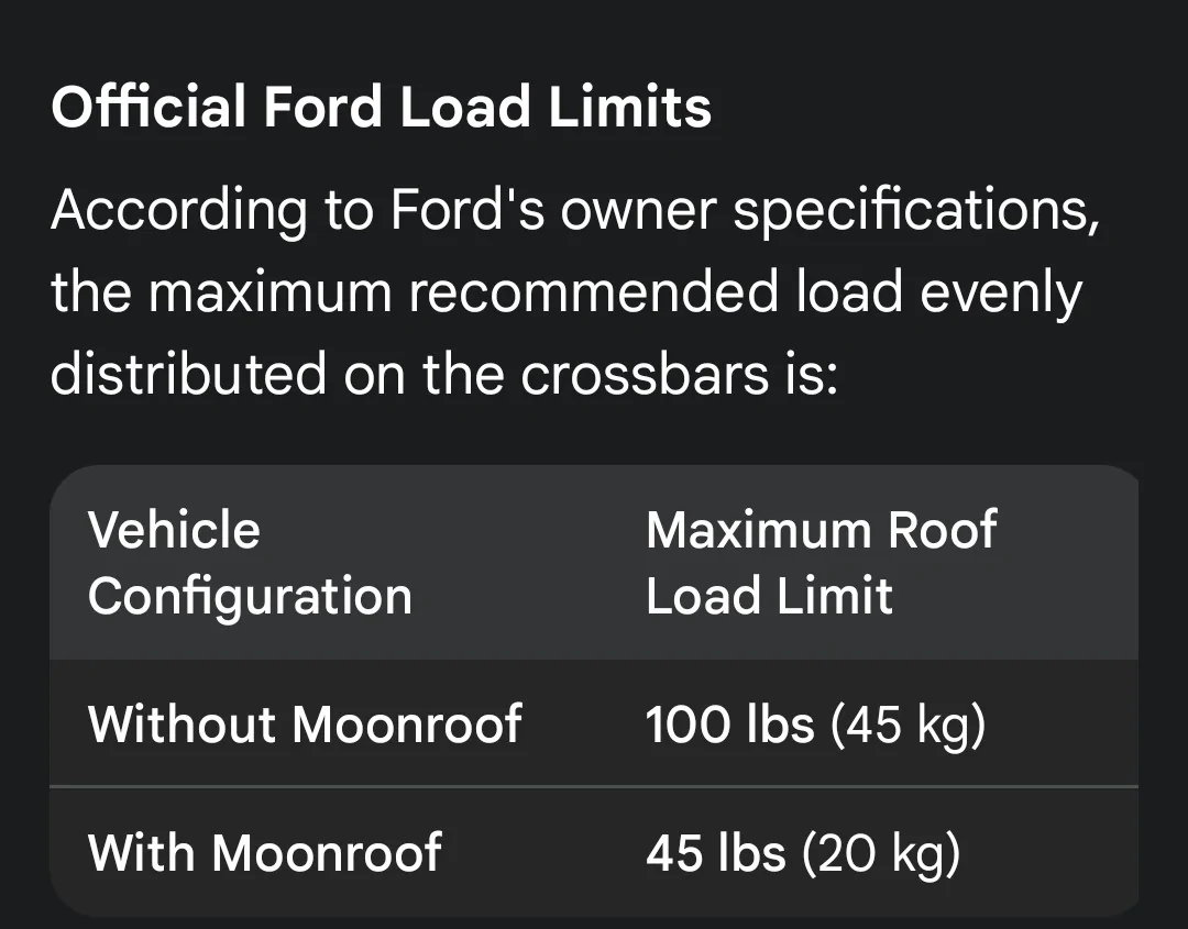

Be aware
Ford Maverick Biggest cargo carrier for roof. Screenshot_20260205_103001_Google~2

FYI- Ford roof top load limit is 100 pounds.
Dang!!!!!!! I was planning on less than 100 pounds. Now, I've got to keep it to under 50 including bars and carrier........ugh. I'll probably return the yakima now. Not worth spending so much to just carry 30 to 40 pounds worth of stuff and suffer a 5% mpg loss when it's empty.

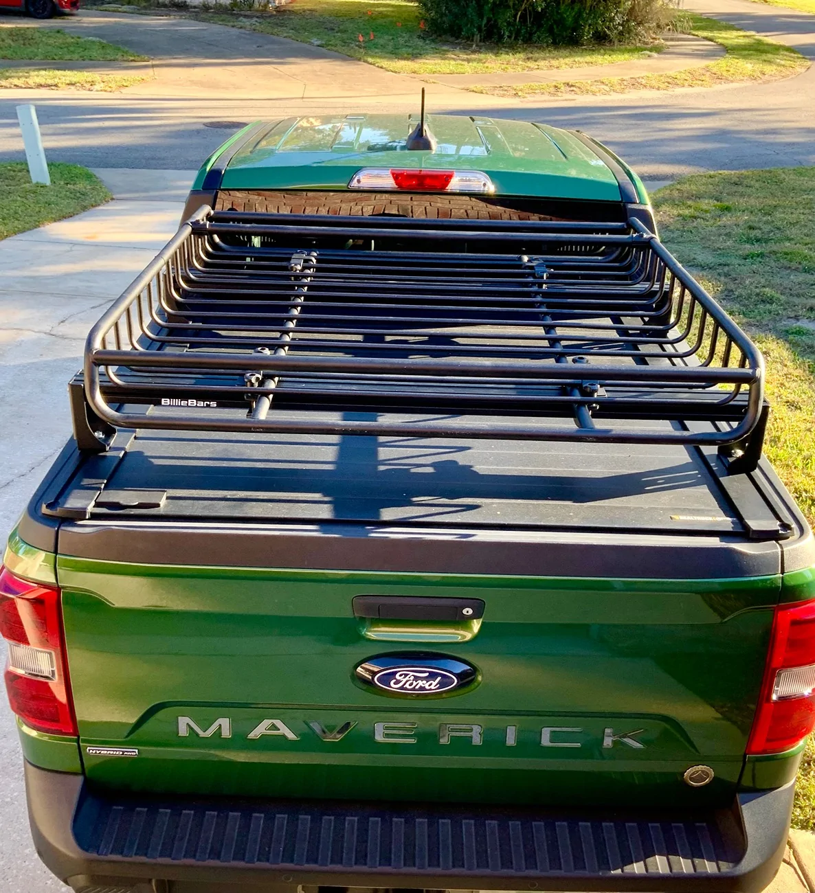

Dave O
Jan 25, 2025
1,741
2,362
New Smyrna Beach Florida
BillieBars and Yakima Load Warrior Basket
Ford Maverick Biggest cargo carrier for roof. IMG_6114
