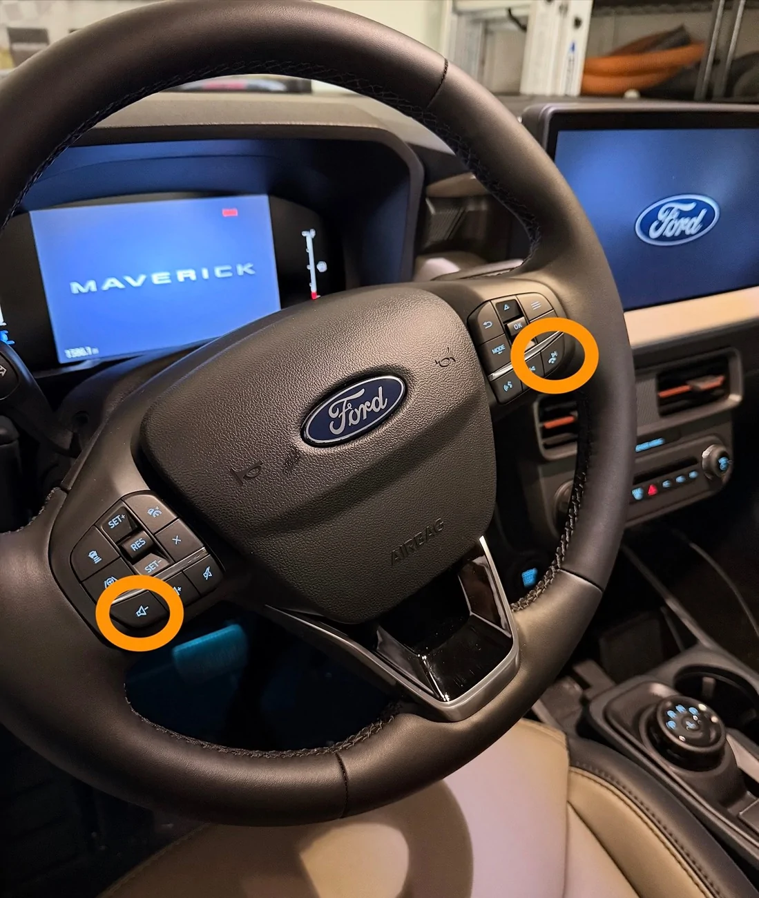

This almost never happens, but sometimes the screen can get stuck or my phone doesn't pair up with the infotainment. Unplugging/replugging it doesn't work.
The solution I've found is to restart the screen by pressing the steering wheel buttons:
Ford Maverick Rebooting a stuck screen (reset the A/V) mav-av-reset
  • Truck must be on or in accessory mode
  • Unplug your phone (if on cable)
  • Hold Volume Down and Next Track buttons for 10 seconds (or until the screen goes blank)
  • Wait
  • Replug the phone
