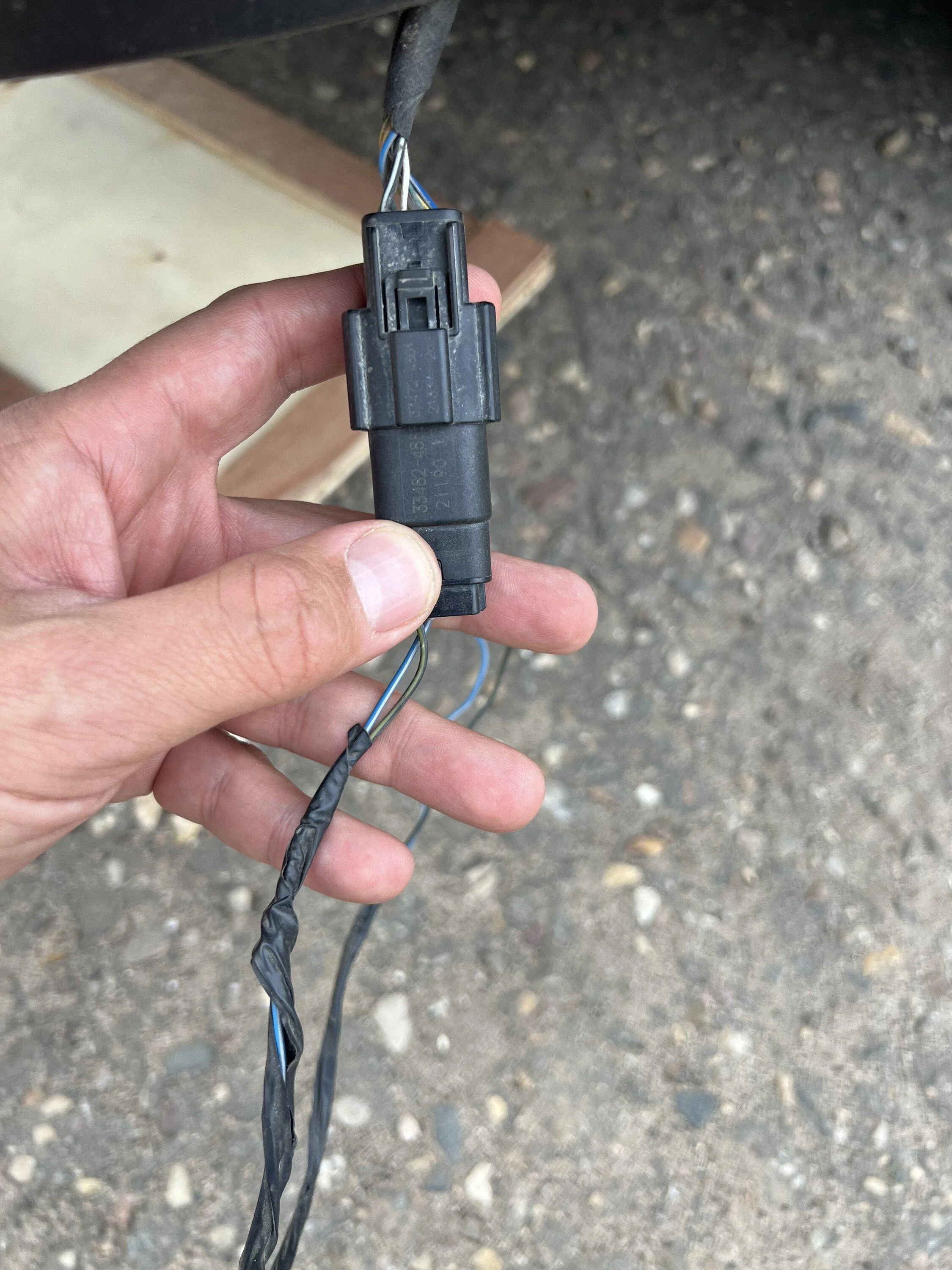

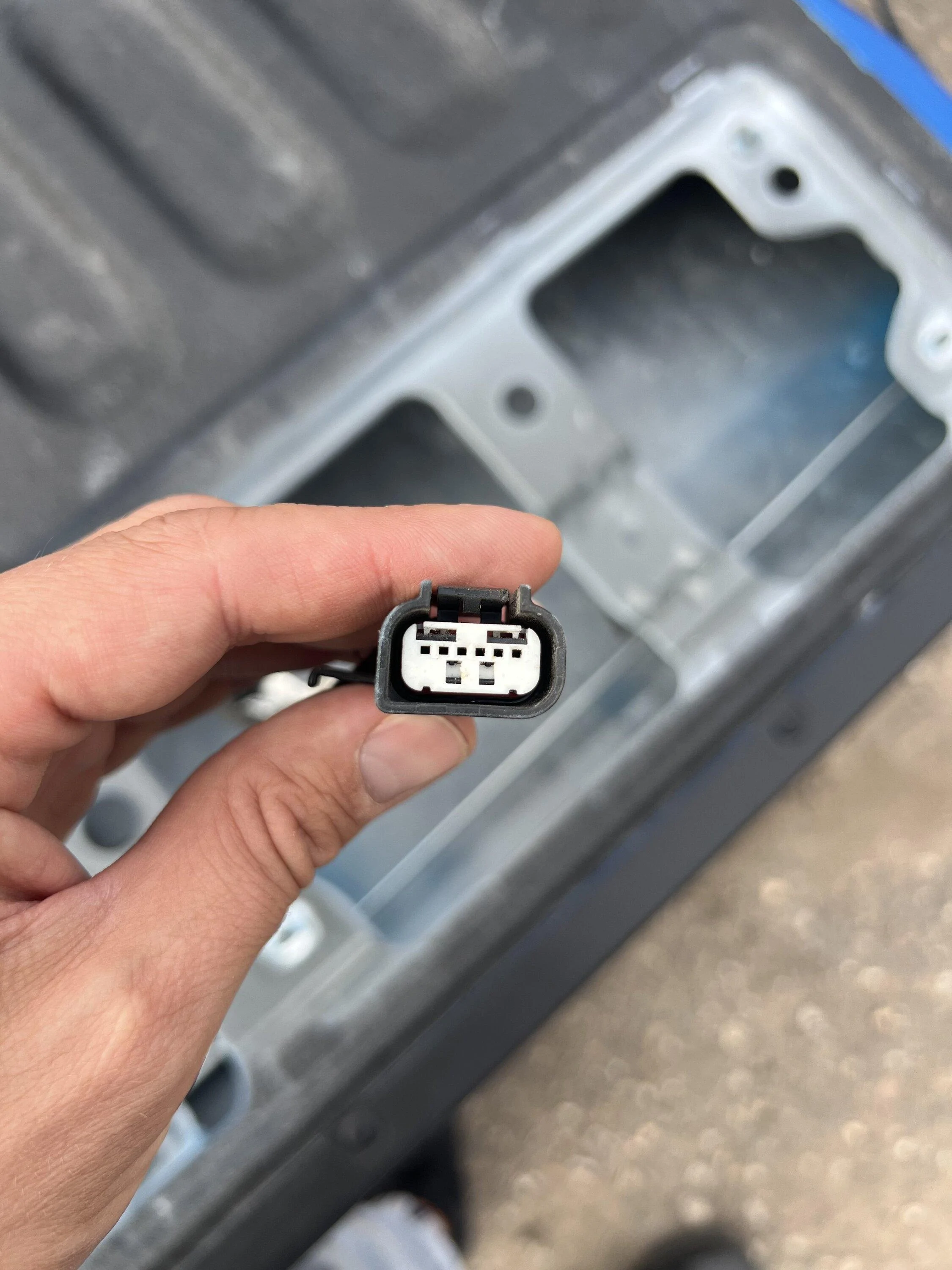

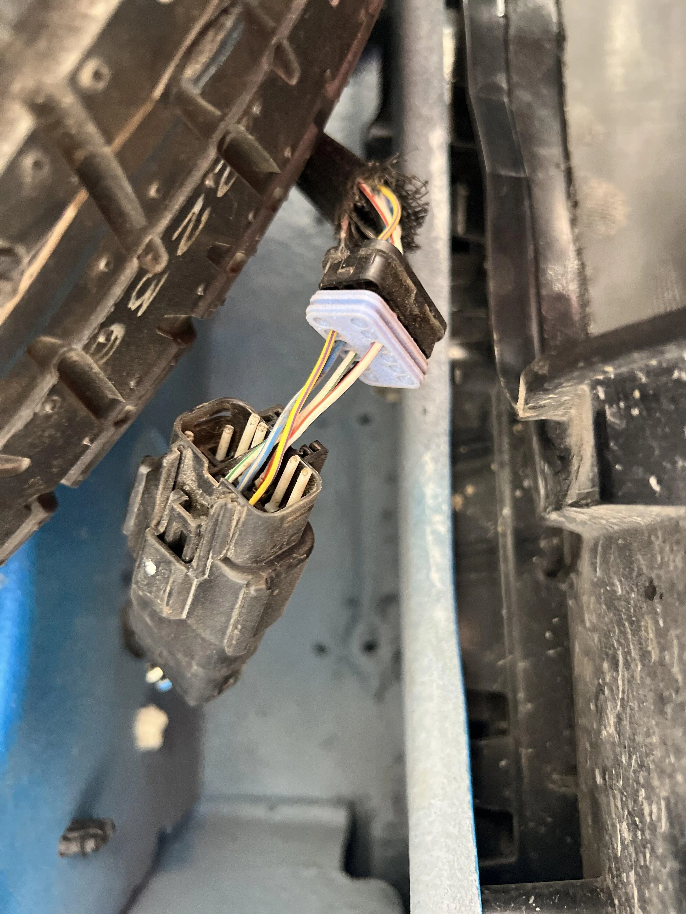

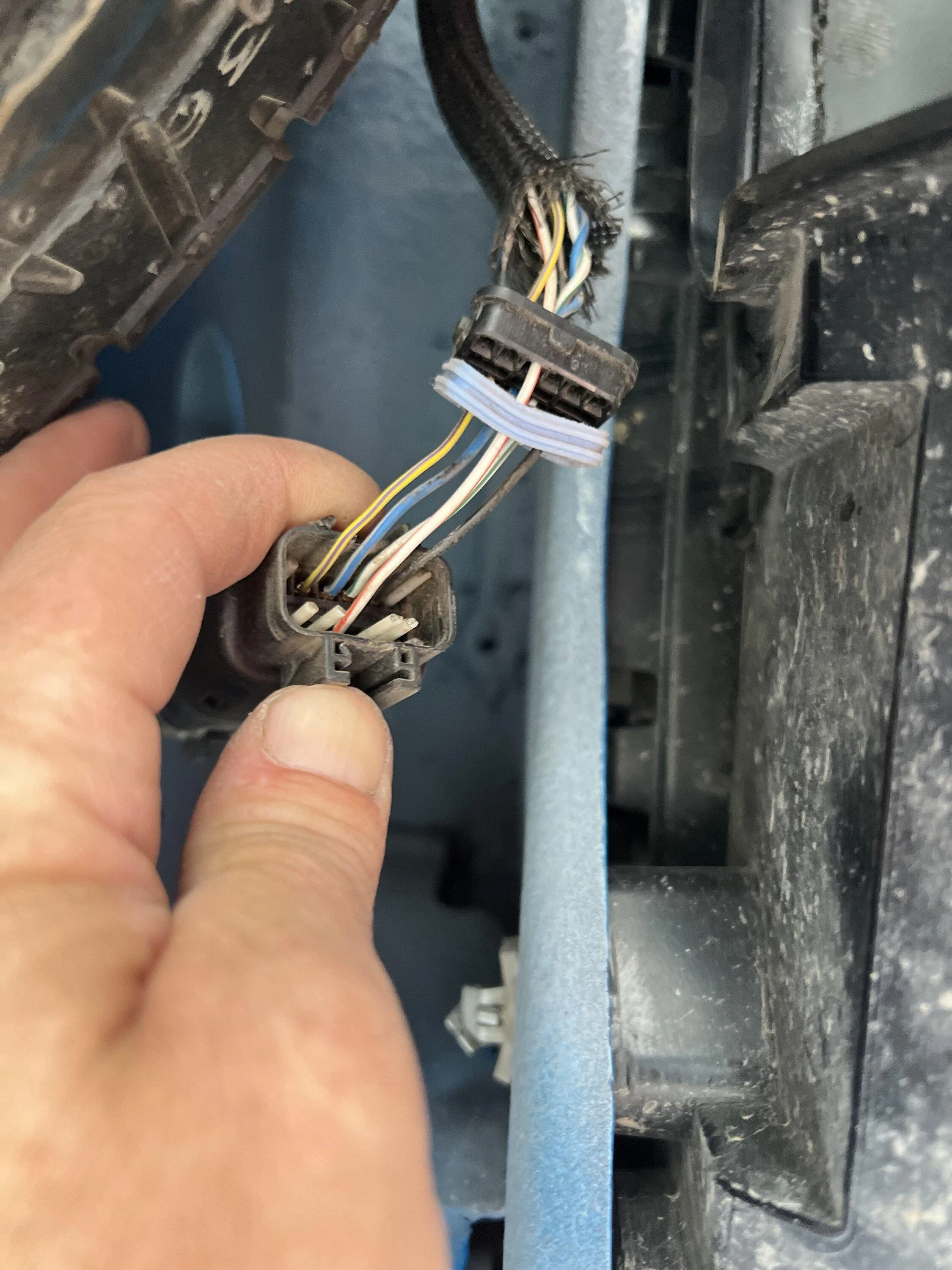

The wires from the rear view camera came off.
Please check. Did I connect everything correctly?
There are still 2 wires hanging, where should they be connected?

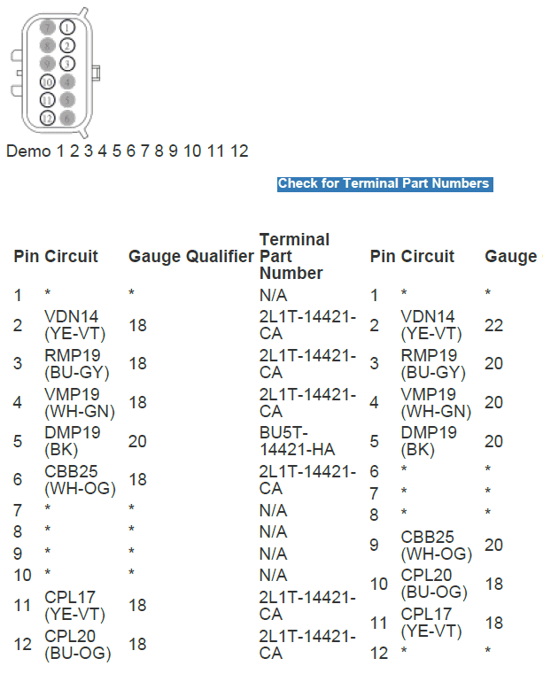

Those ones looks correct.
Ford Maverick rear view camera wiring 1695490636599
Strangely White w/ Orange and Blue w/ Orange don't appear to actually correspond on both halves of the connection? I suspect that may be an error in the diagram (not the first I've encountered in the version of the manual I have access to); Blue /w orange is part of the tailgate lock circuit and White w/ orange is a general power circuit for Cruise/CP360/obstacle detection stuff.

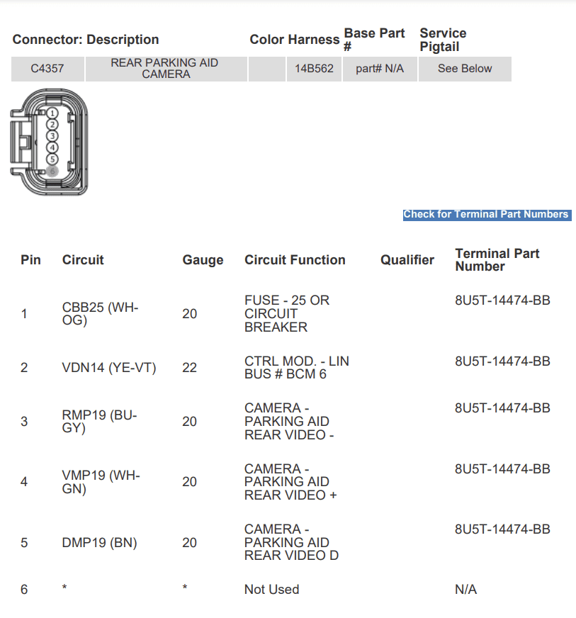

I was able to find this as well. Maybe it can help if you use it in conjunction with what @Darnon posted.
Ford Maverick rear view camera wiring rear parking aid camera

Ford Maverick rear view camera wiring image-21-09-23-09-50-3
Where does this wire go?
7 wires come, 2 go.
Blue and black.
