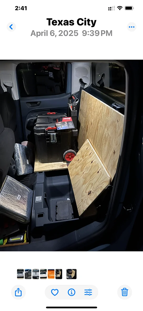

As long as the inspection computer doesn't throw a code, I'm good. I have some pics of the rear seat where I mounted plywood and attatched my tools, I'll post later.

I had disconnected the wiring to the rear seats and removed the lower buckles, but that still gave me warning notices. I now have the belts tucked under the boards replacing the seat cushions with these inserted. No warnings, no problems.
