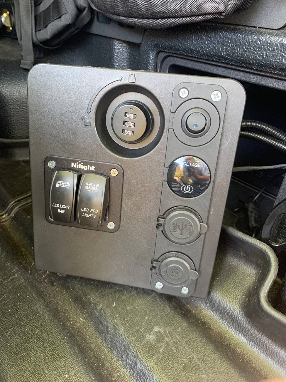

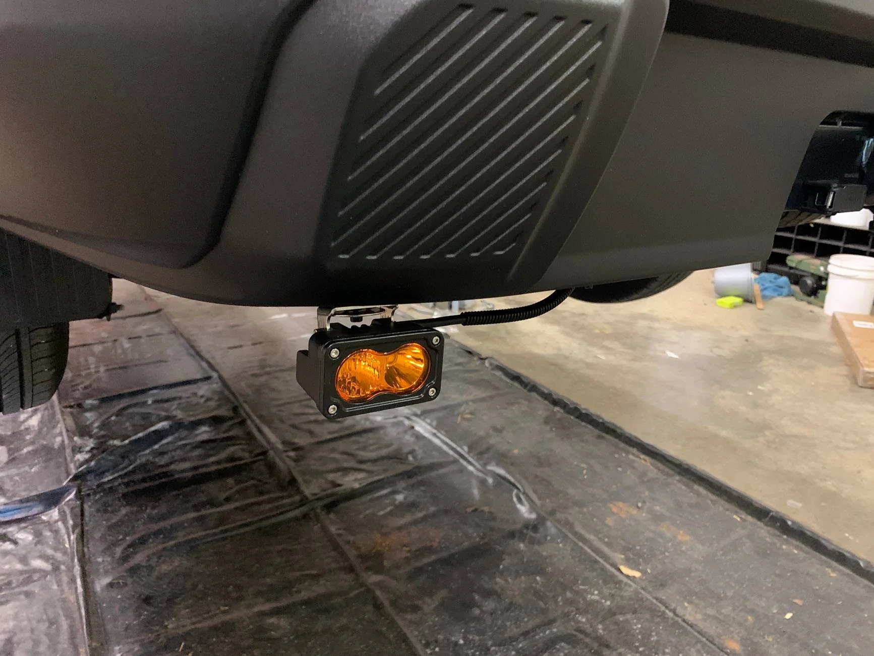

For the purpose of illuminating to the rear of my Maverick, especially for when hooking up my PWC trailer at night, I added a 3” LED pod hanging below each corner of the bumper. They are secured using OEM screws found at those locations. I have a switch mounted on the bed cubby door or can use a remote I keep in the center console to turn them off and on.
Thank you!

This is what it looks like below bumper
nice! And, it doesn’t take away too much ground clearance like a cube/ ditch light style light would.

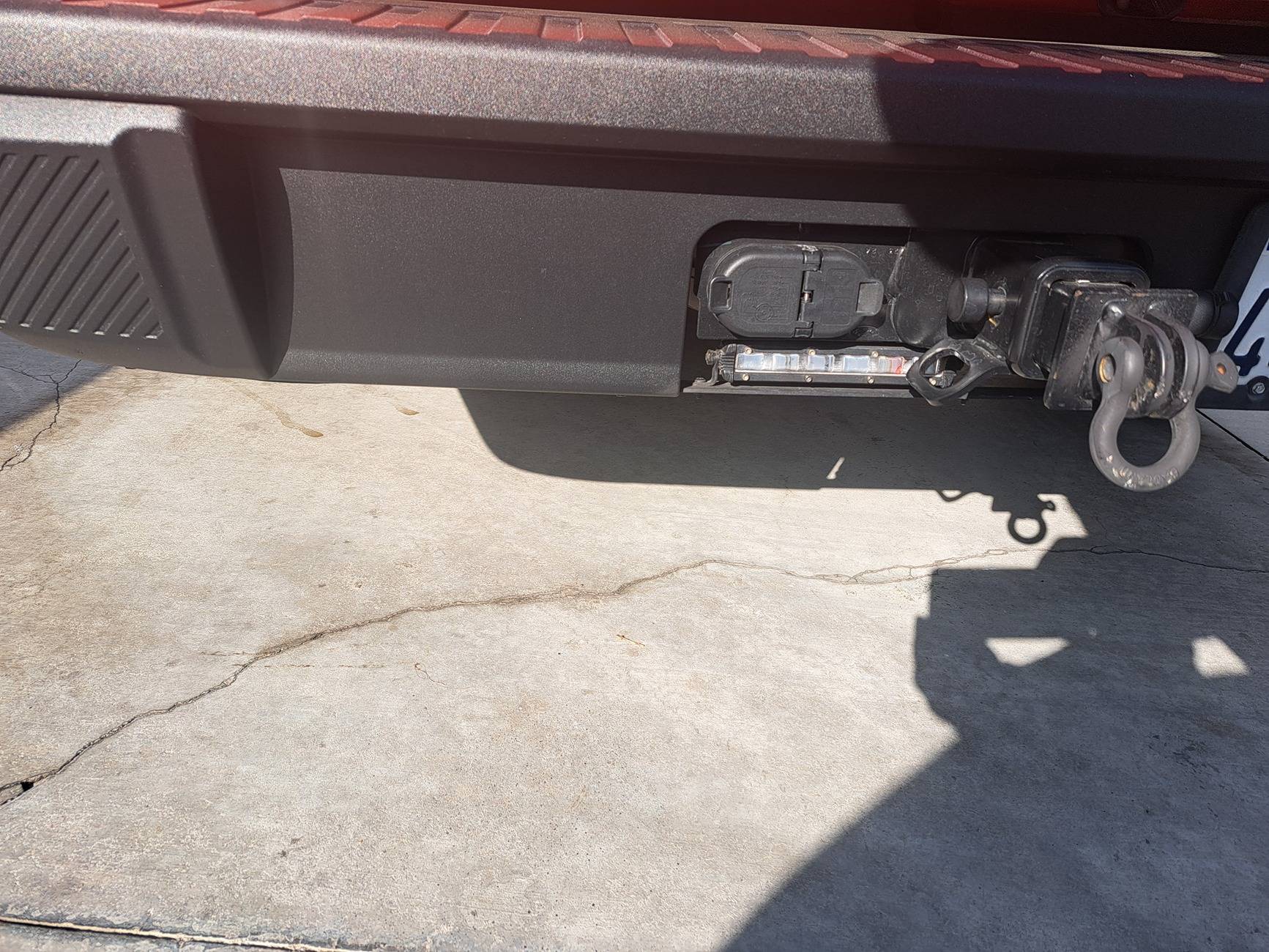

Nice clean install on the blue truck. If you don't.
Want to go to Is cutting the bumper andont want the pepboys bracket look. Here is a less than one hour installed. Very bright flood in the camera view.
Ford Maverick Rear Light Brackets 20250104_100009
Ford Maverick Rear Light Brackets 20250104_095735
DrEvil
Stephen
Jan 3, 2025
136
163
24 awd turbo maverick
14 in of 1.5 by 1x8 flat stock . Used 7 in 10$ light bar. Drilled 2 holes to use existing rear number mount screws .2 holes for light bar. Painted flat stock black. 30 min. Used wire tap to trailer wiring reverse wire. 1 wire 18 inches to existing ground screw. 15 minutes. Tremendous difference in light mounted low in camera view compared to high mounted reverse lights.
