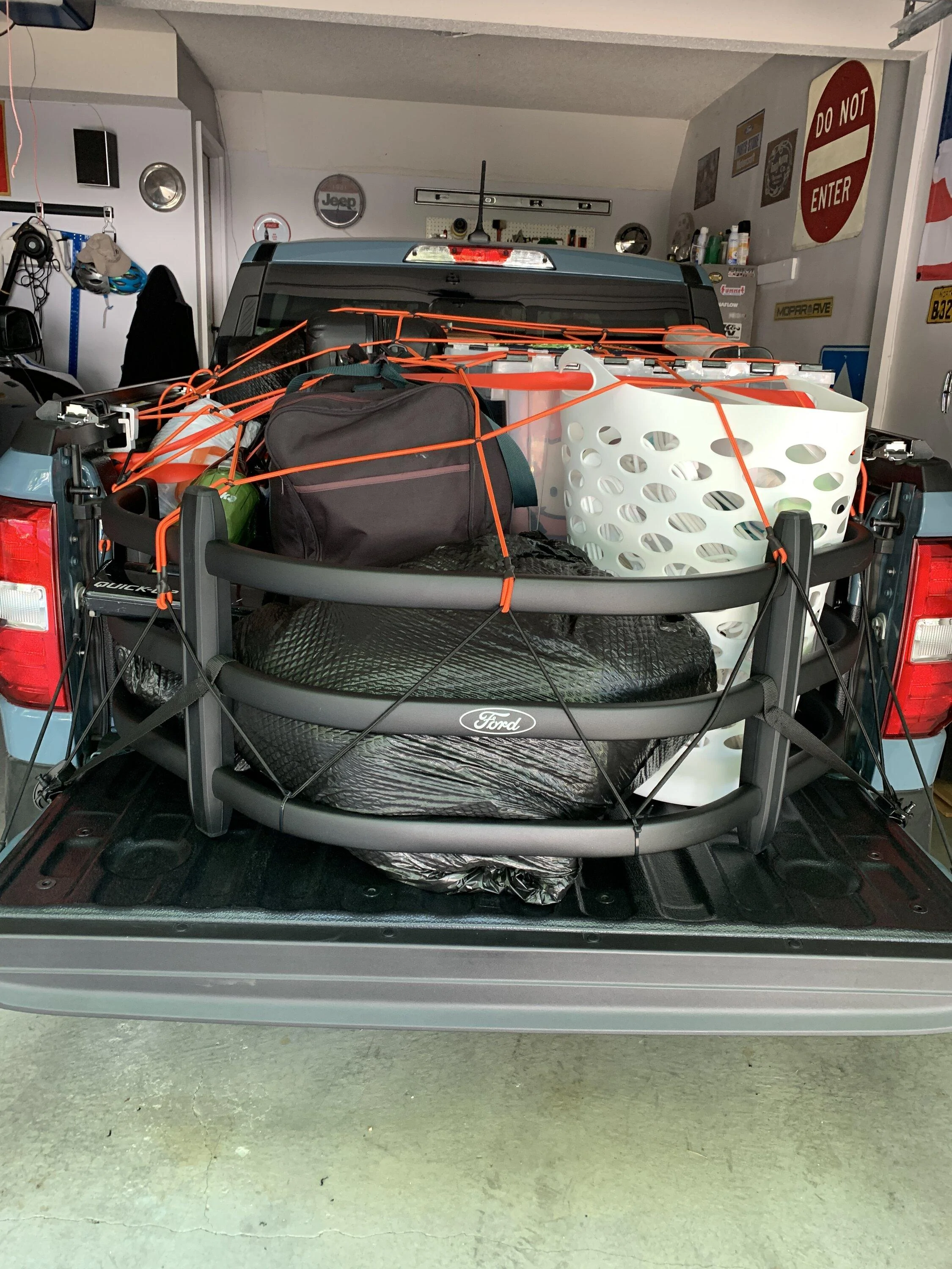

The large metal plate/bracket (with the "R") is for the Ranger. It's not used for the Maverick. The holes in the other bracket should line up with the 3 holes in your Maverick.
Have you tried removing the plastic uprights on the extender, and squeezing it together? I purchased the OE Ranger one for cheap on Marketplace. It fit once I squeezed it together.
Ford Maverick Realtruck provides completely useless bed extender IMG_7229

so the holes in the bracket do line up but what are the bolts supposed to go into? on the Ford version of this there is that piece on the back that I would hold in there that has threaded holes in it. the bed of the truck just has holes, not threaded holes.

Contact Lund and see if you can get the backing plates thru them, if not try going thru Ford dealer parts department.
You could install the mounts using a washer and nut. Yes it is tight working in there, but it can be done.
I installed the Ford hard trifold on my maverick, one of the drain tube adapters was crushed. I called the manufacturer and was told I had to go thru Ford parts. Went to the dealer and they ordered the adapter for me.
This really isn't insurmountable...again worst case you get 6 washers and 6 nuts to fit the screws. The plates IMO just make it "easier" for the average DIY to complete installation.
I have not because if I might end up just trying to sell this I don't want to unpack all of that stuff. right now it's essentially a new open box item.
