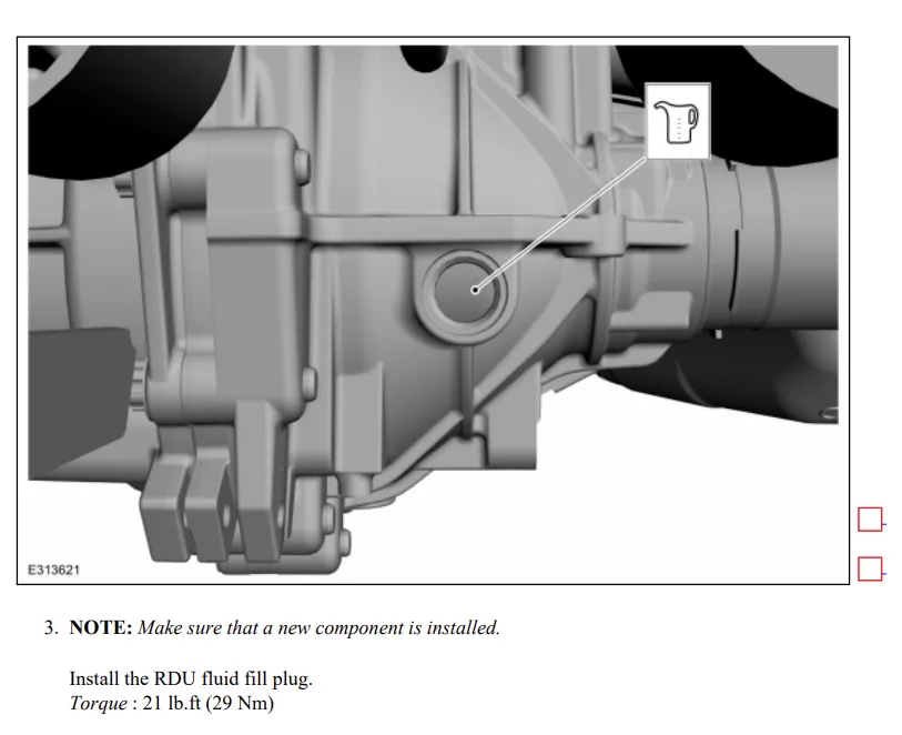

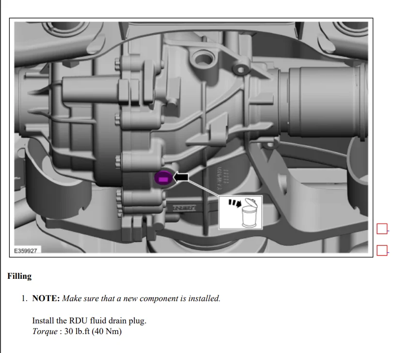

As stated, I am changing my RDU oil soon. Does anyone know the torque specs for the drain and fill plugs?

That was very helpful. Thank you. But after googling it and getting nothing, I posted here and got the specs from bbhaag above.
