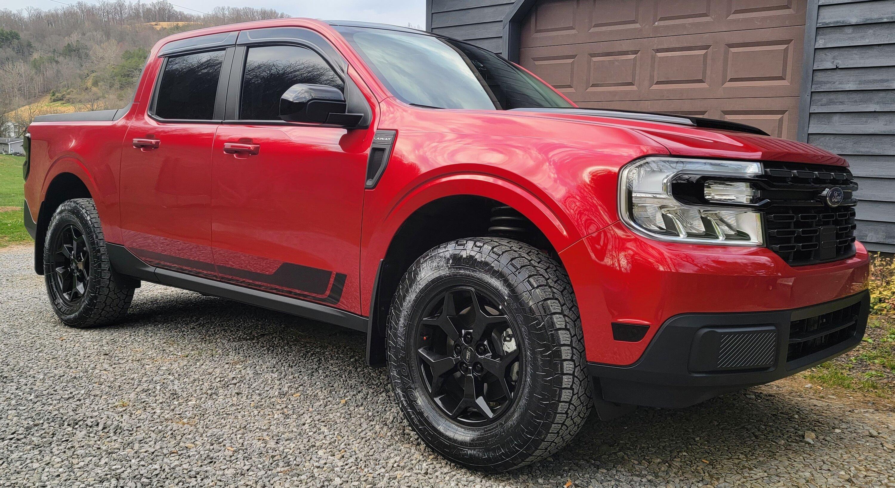

I think this years BAP would look great on our FE's. If my hood graphics ever go bad, Im doing the hood scoop like yours
I work at a ford dealer and with my employee discount I only have like $750 total in the hood scoop, cab spoiler, tailgate spoiler and the silver bar across the front combined and that includes all four bought painted and installed. I looked up just the hood decal MSRP and it's $800 and I don't think that includes installation.

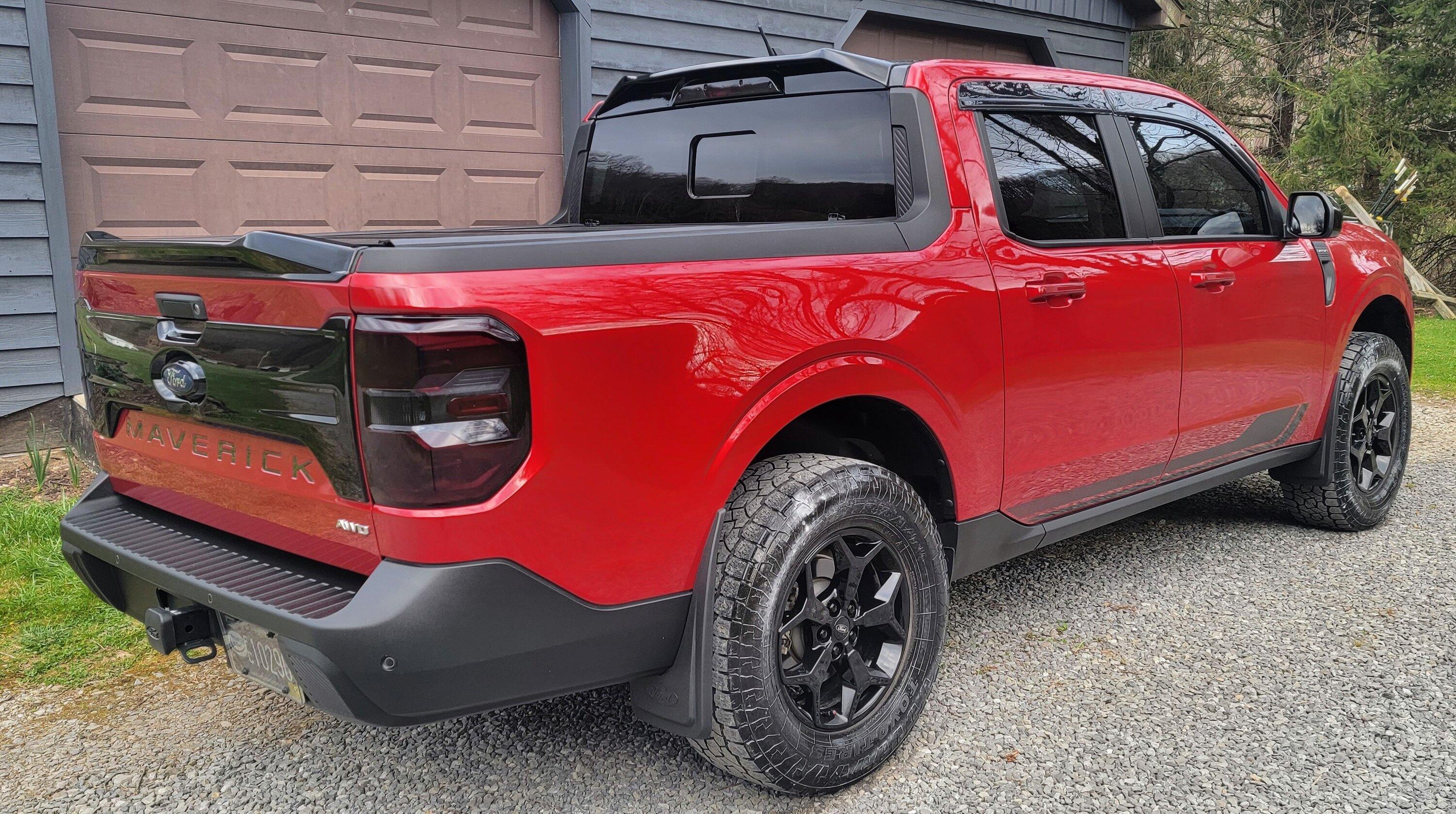

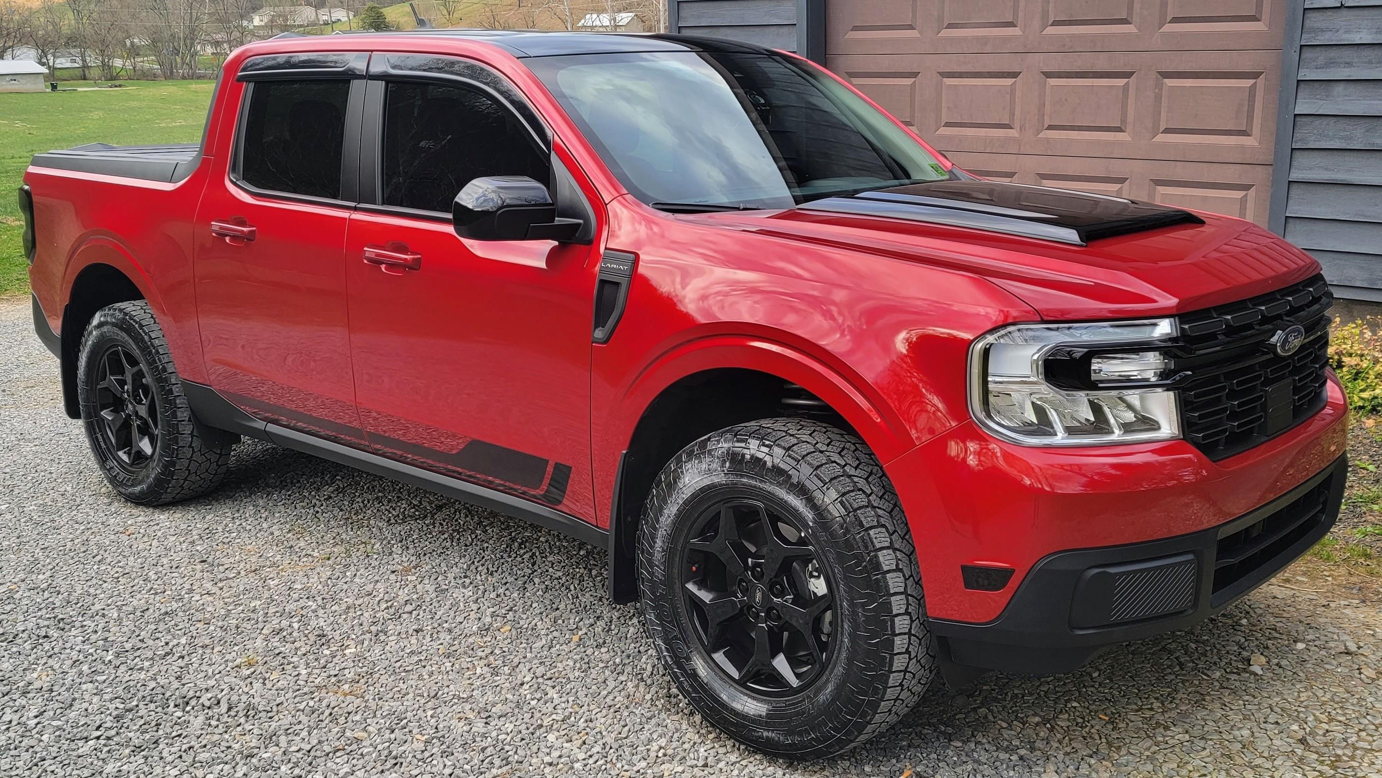

Build List
• Steeda Strut Tower Brace
• Turbosmart eBOV
• AFE Momentum GT CAI
• Eibach Pro-Lift Springs
• Eibach Pro-Camber kit
• Toyo Open Country AT3 255/70r17 Tires
• Air Design Hood Scoop professionally painted Gloss Black
• Air Design Cab Spoiler professionally painted Gloss Black
• Air Design Tailgate Spoiler professionally painted Gloss Black
• Air Design Tailgate Appliqué professionally painted Gloss Black
• Grill/Headlight Bar professionally painted Gloss Black
• LasFit Red LED taillight bulbs
• LasFit White LED Reverse bulbs
• LasFit White LED Cargo Bulbs
• LasFit Red LED 3rd Brake Light Bulb
• VHT Smoked Taillights
• VHT Smoked Bumper Marker Lights
• VHT Smoked 3rd Brake Light
• Ford Accessories HALOGEN/LED TAILGATE LIGHT BAR
• Ford Accessories INTEGRATED TETHER SYSTEM (FITS) PACKAGE
• Ford Accessories Tailgate Assist
• Ford Accessories Putco Black Platinum Tailgate Lettering
• Ford Accessories PUTCO BLACK PLATINUM 4PC DOOR SILL PLATES KIT
• Ford Accessories LUND SMOKE LOW PROFILE SIDE WINDOW DEFLECTORS
• Ford Accessories CARGO MANAGEMENT SYSTEM KIT - INCLUDES CLEAT TIE DOWN KIT
• Ford Accessories BED DIVIDER KIT
• Ford Accessories FRONT CONSOLE VAULT IN-VEHICLE SAFE
• Ford Accessories LUMEN TOUCHLINK
• CAPACITIVE TOUCH LED LAMPS BED LIGHT
• Ford Accessories Tough Bed Spray-In Bedliner
• Ford Performance M14 x 1.5 Black Lug Nuts
• Ford Accessories Hitch Cover
• Ford Accessories ST Aluminum Pedal Covers
• Ford Accessories McGard Tailgate Lock
• Ford Accessories Molded Splash Guards Front & Rear Pair
• Rough Country Hard Low-Profile Bed Cover
• Husky Liners WeatherBeater Floor Liners
• Gloss Black Tailgate Emblem Cover
• Uniden R4 Radar/Laser Detector
• UPR Oil Separator/Catch Can Kit
• Redline Tuning Hood QuickLIFT Elite System
• SCT X4 Programmer w/ 5 Star Custom Tune
• CravenSpeed Stubby Antenna
• 20% Window Tint
• 7 Year Ceramic Coat Professionally Applied on Entire Vehicle
• 7 Year Ceramic Coat Professionally Applied on Wheels

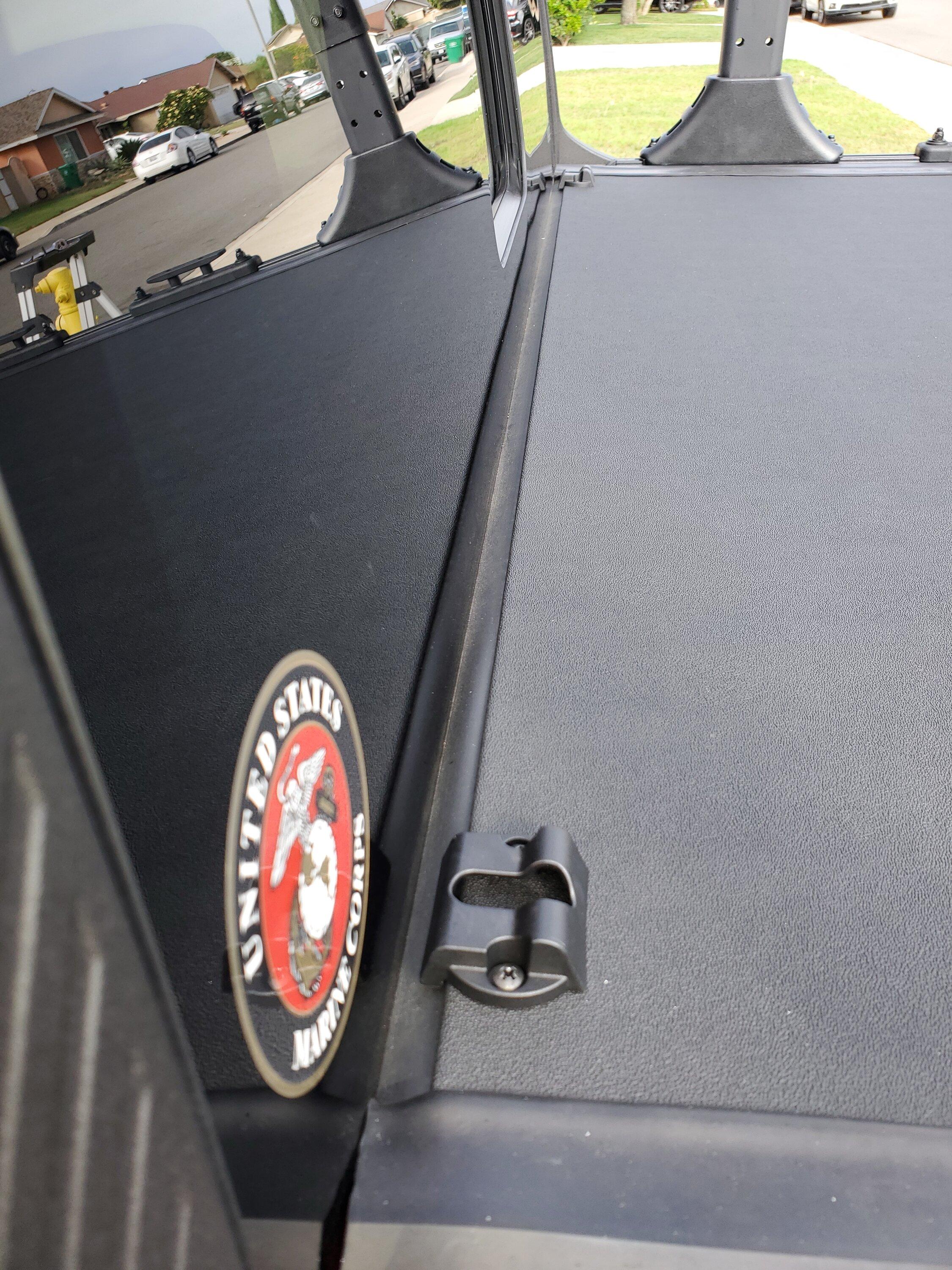

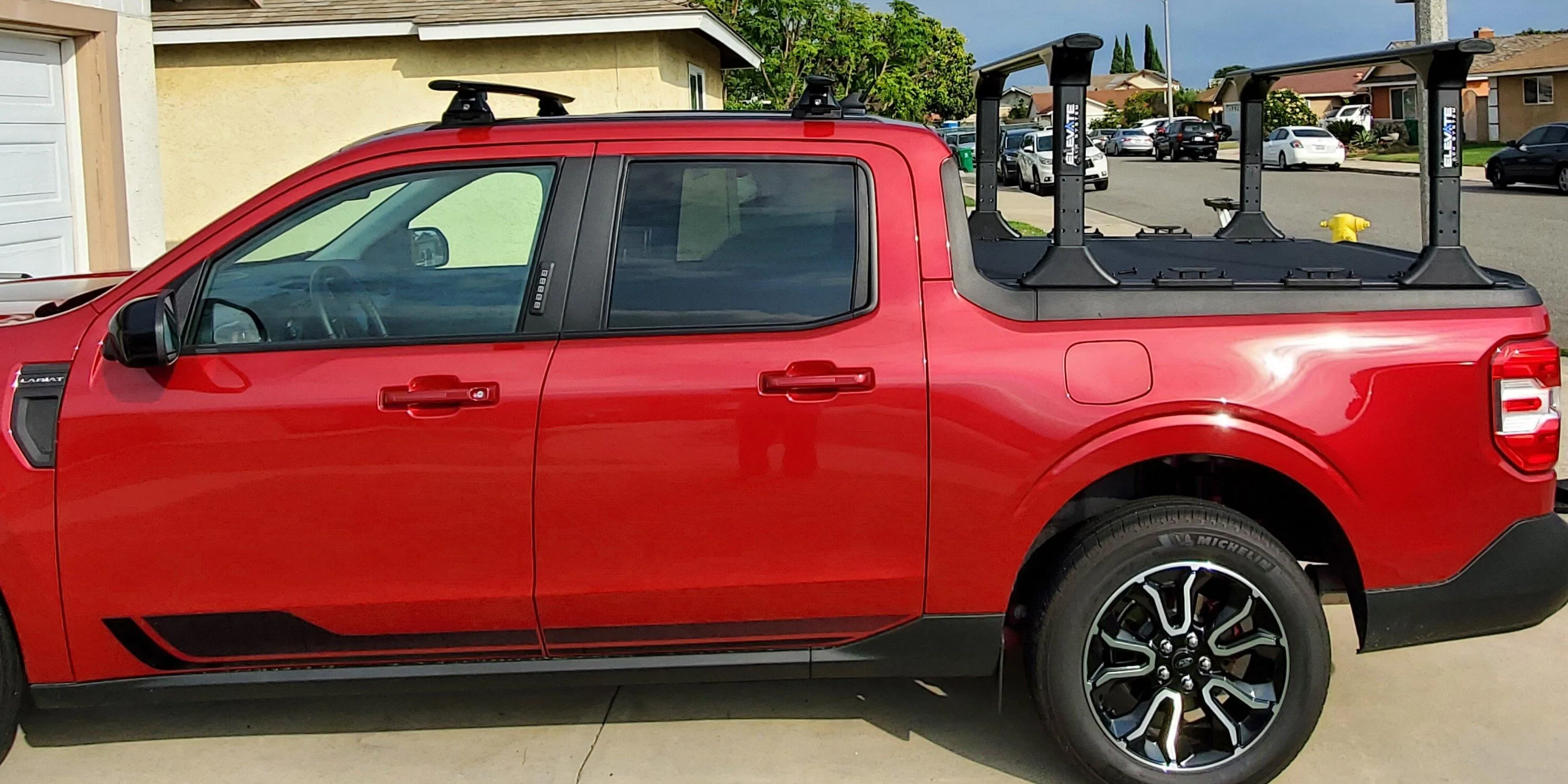

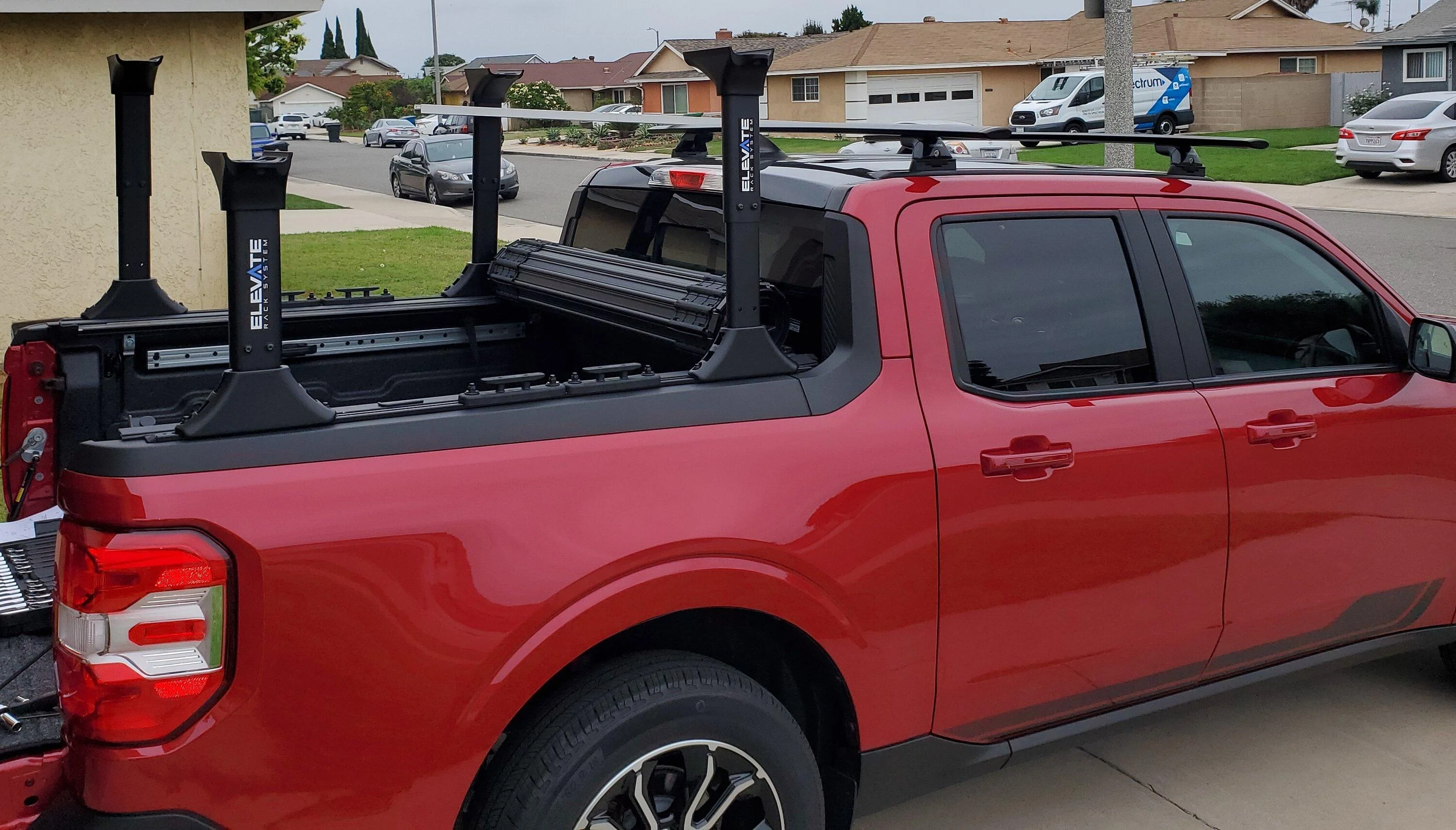

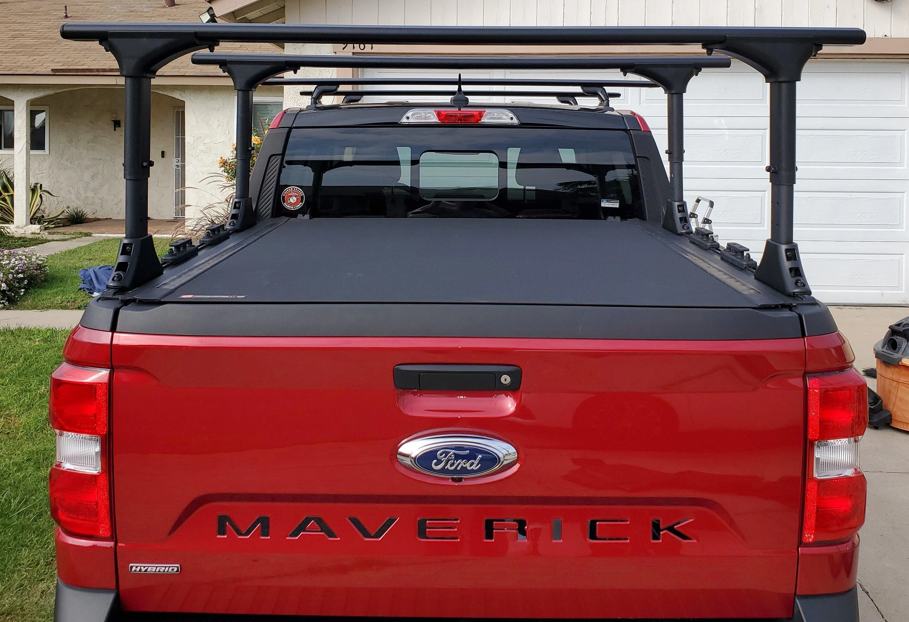

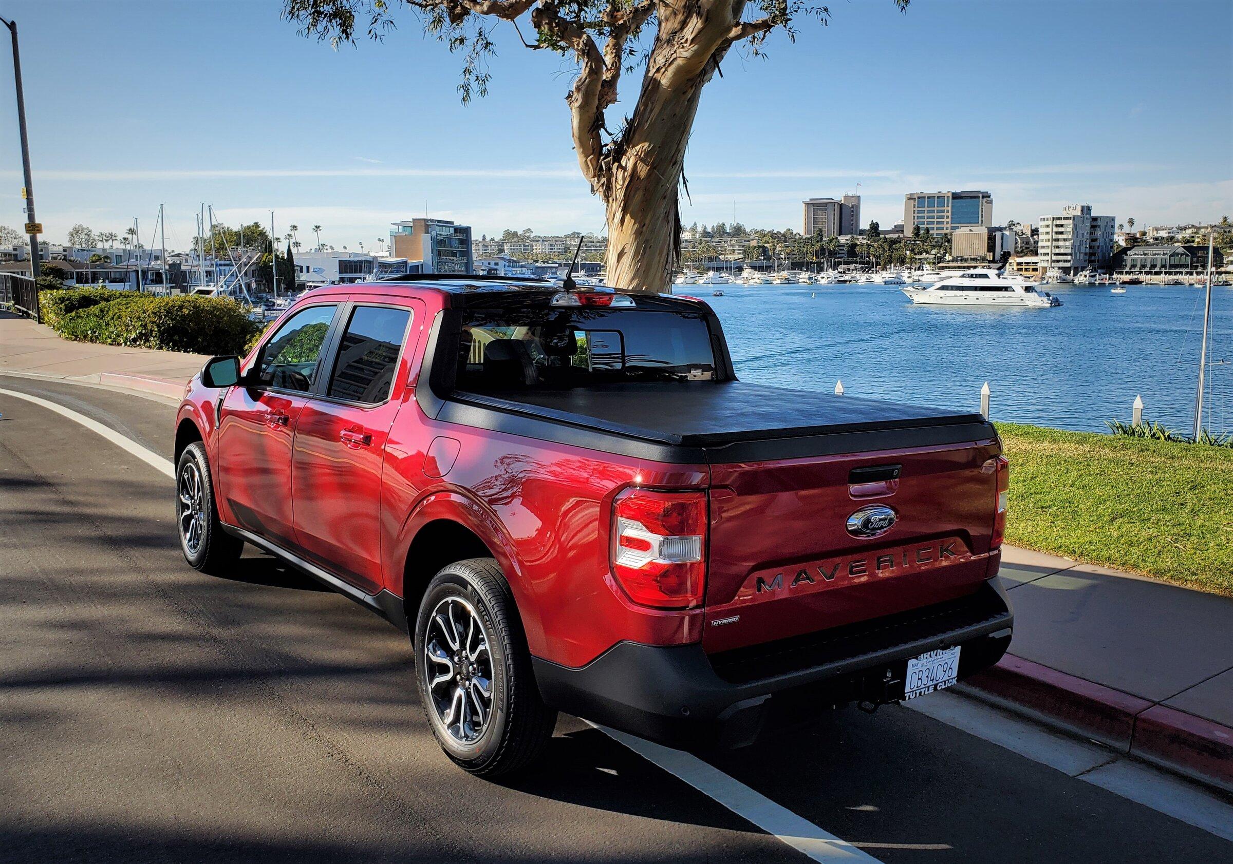

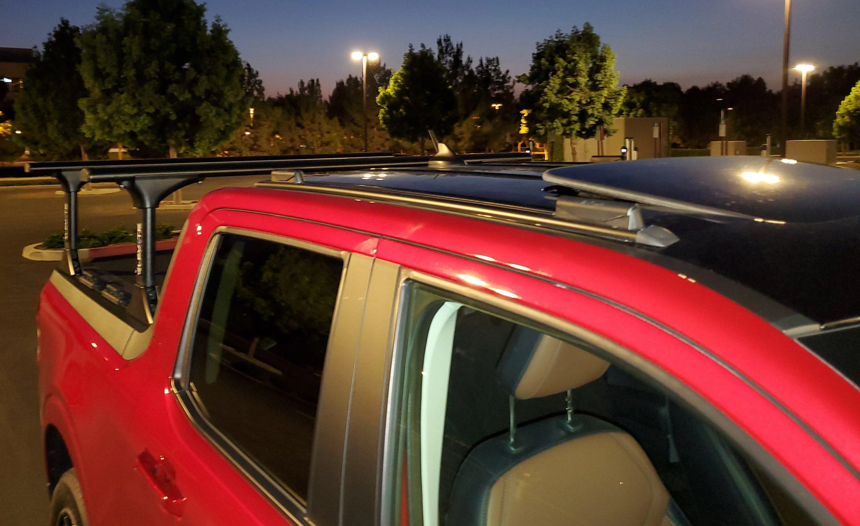

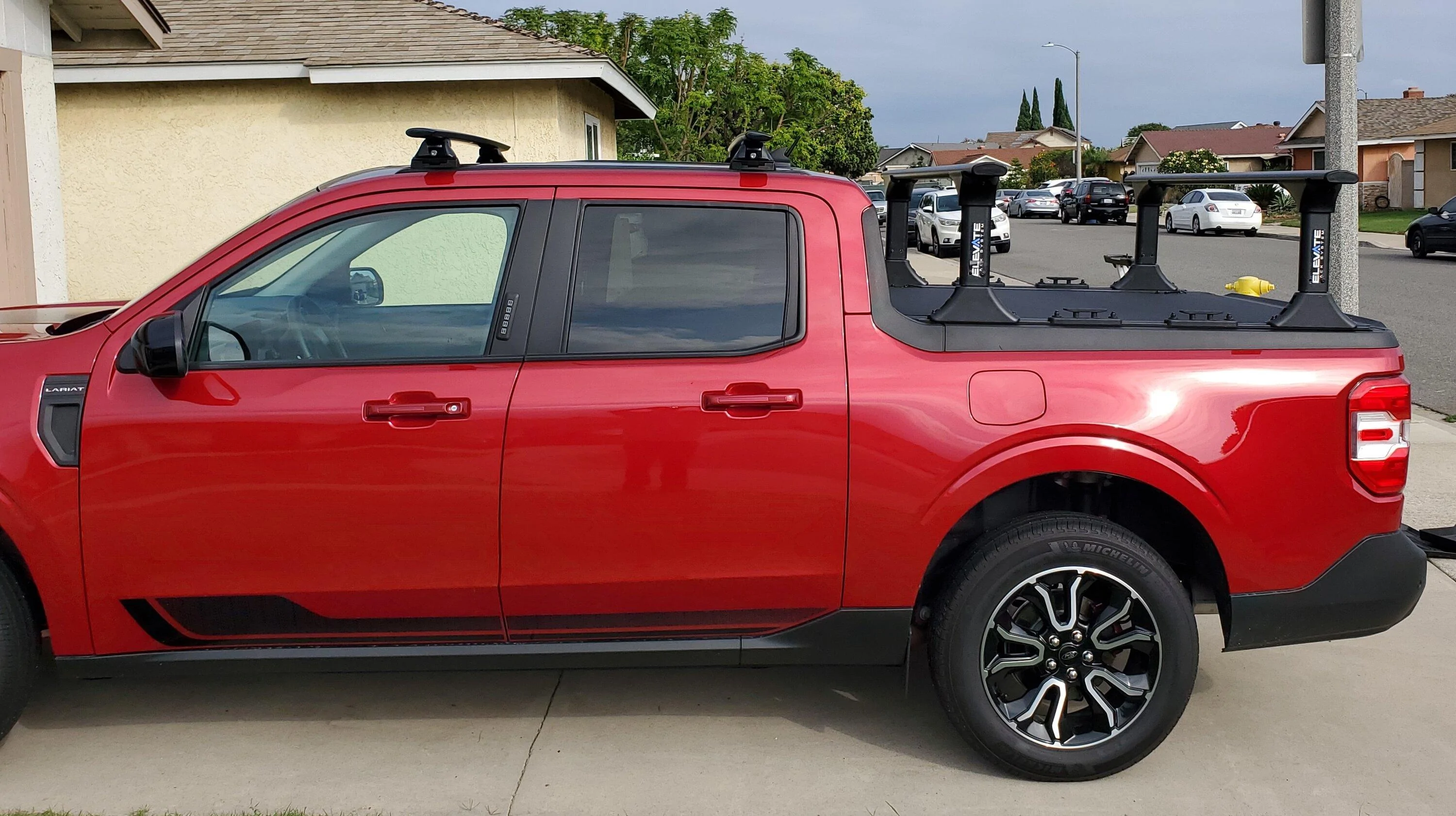

I finally completed the next phase of my Mav mods!
I originally wanted the Yakima Overhaul HD w/ HD crossbars combined with the BAK X4S. In the end I choose the "Elevate Rack System" b/c I felt it was the most workable solution with best price, availability and relatively easily modified. Bonus is the discount that RealTruck offers us.

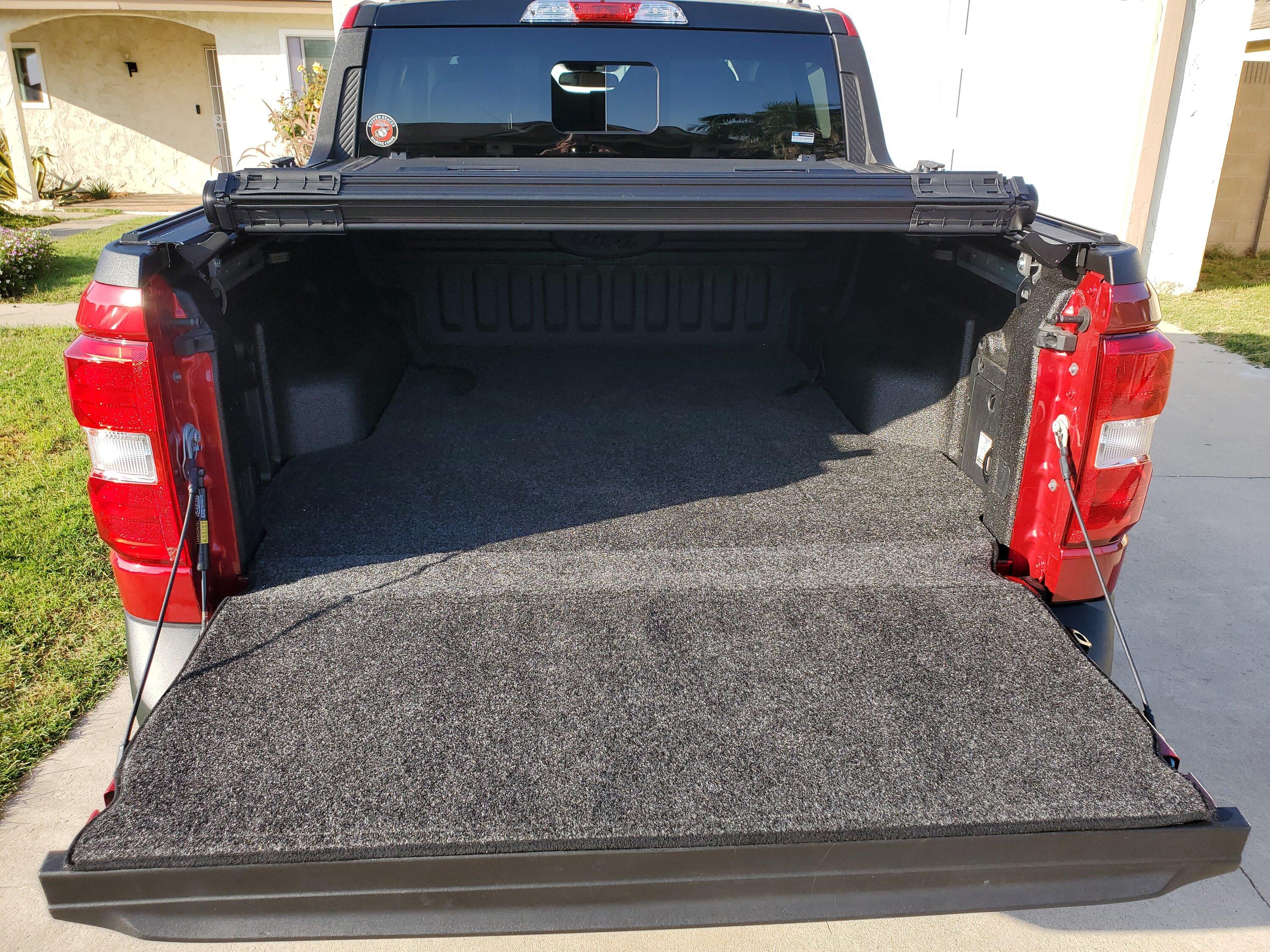

I began the install this past weekend. To Start the BAK X4S & TS Rails installation is very straight forward and easy. The only modification needed was to trim the rubber seal against the back window. My modification may have been due to the Bedrug so do the full install to verify if trimming is needed.

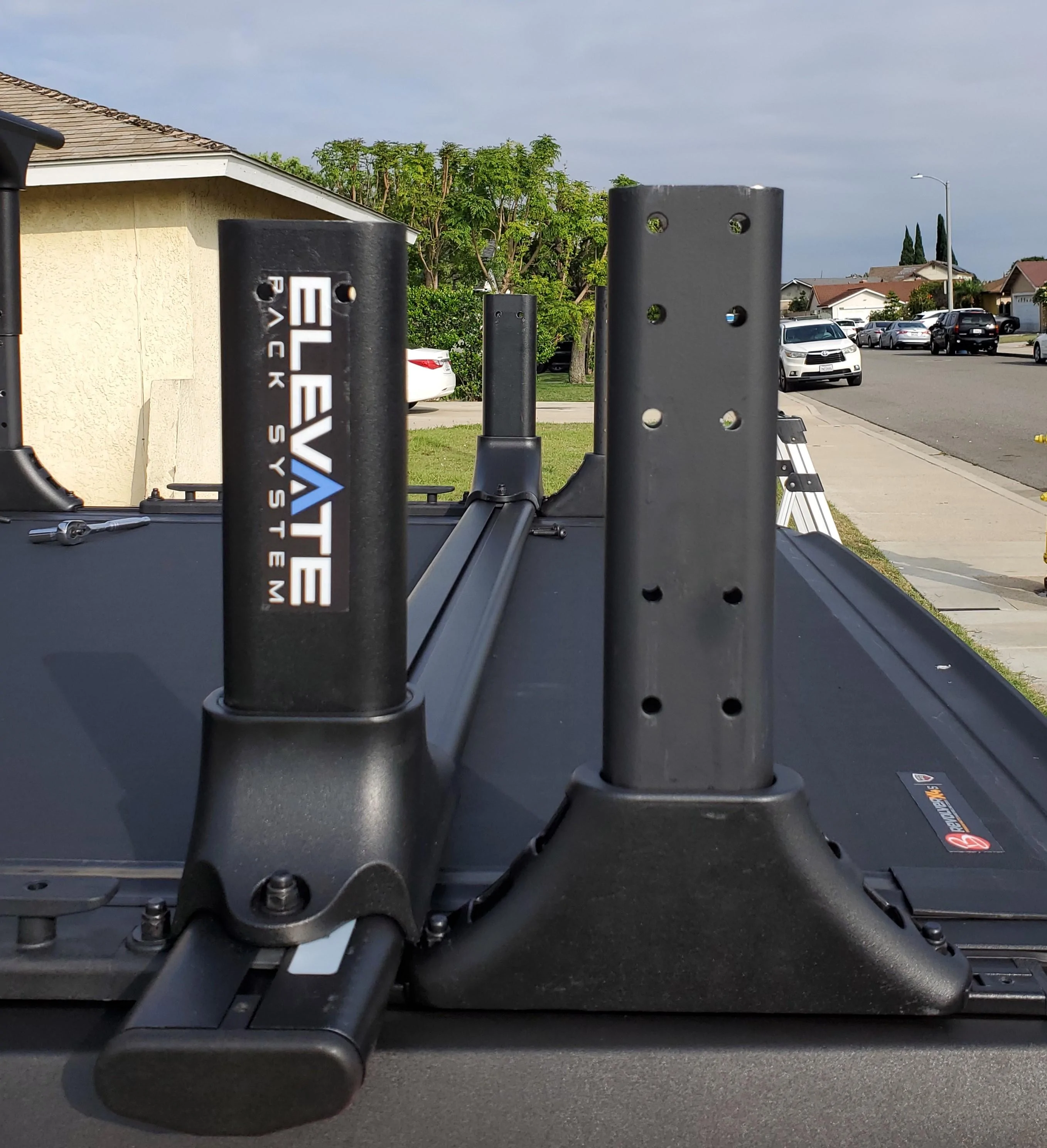

The majority of my time spent was on the Elevate CS Racks. To be fair the rack install itself was very easy, my time was on modifications! As we all know the Mav is a small truck and IMHO this rack is made for the larger ones, but can be modified to work; at least for my needs. Bottom line, I wanted the Low / High settings to both be lowered. Additionally, I wanted multiple between settings to align with my Yakima Roof Racks for my kayak among other things.
Pic #1 Shows trimmed window seal
#2 Bedrug, BAK, TS rails
#3 CS Racks original low & high no crossbars
#4 Modified racks - 1-1/2" cut from both ends, re-drilled holes (don't use the original top holes).
#5 New High mount set points.
#6 New Low mount set points.
#7 Now it's aligned w/ the roof & doesn't block the brake lights.
#8 Aligned w/ Roof Racks.
I'm really pleased with the final results and the only thing that I would change is increase the end cuts from 1-1/2inches to 2 inches.

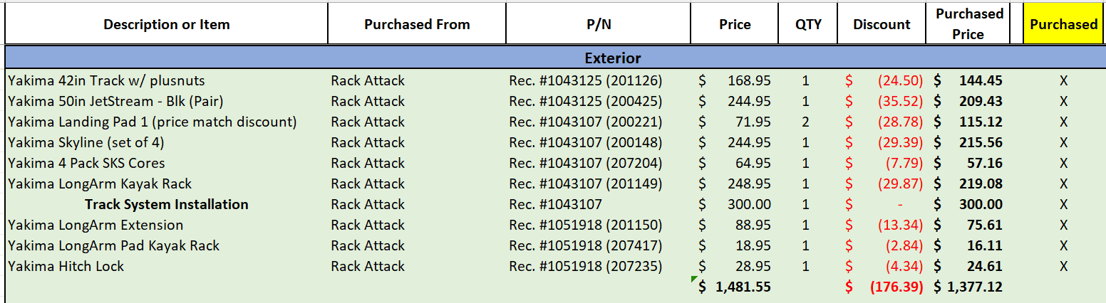

What was the total cost of all the racks and the cover? I'd love to do something like this so I can haul extension ladders while having a tonneau cover.
glpuckett
Gary
Jul 29, 2021
151
262
ID
2022 Maverick FE Rapid Red 2.5L Hybrid

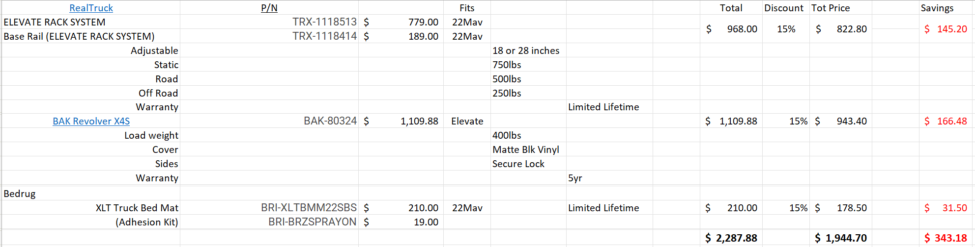

Noah, here are my spreadsheets of the cost and discounts. Remember this was from well over a year ago, so I'm sure prices have changed.
Ford Maverick RAPID RED Maverick Photos Thread 1705521467371
Ford Maverick RAPID RED Maverick Photos Thread 1705522055741
Qanzilla
Noah
Sep 7, 2023
Massachusetts
Rav 4, corolla
Thank you so much for this info! I'm considering getting the elevate rack which seems to be the cheapest rack that is compatible with tonneau covers. However I was concerned about putting a longer ladder on just that rack. The short length of the bed doesn't seem like enough to hold a long extension ladder. A roof rack would help, but they all seem pretty expensive!
