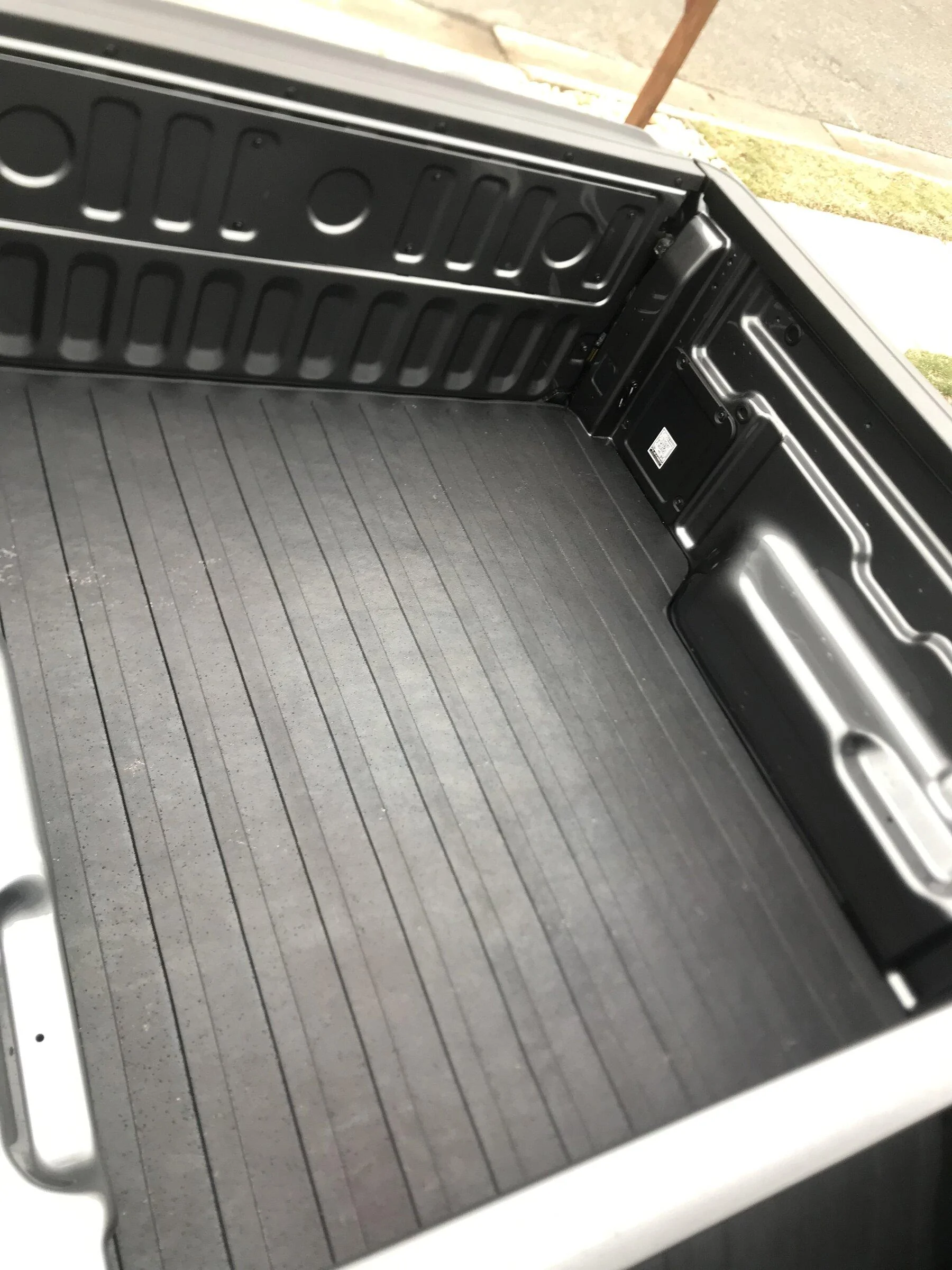

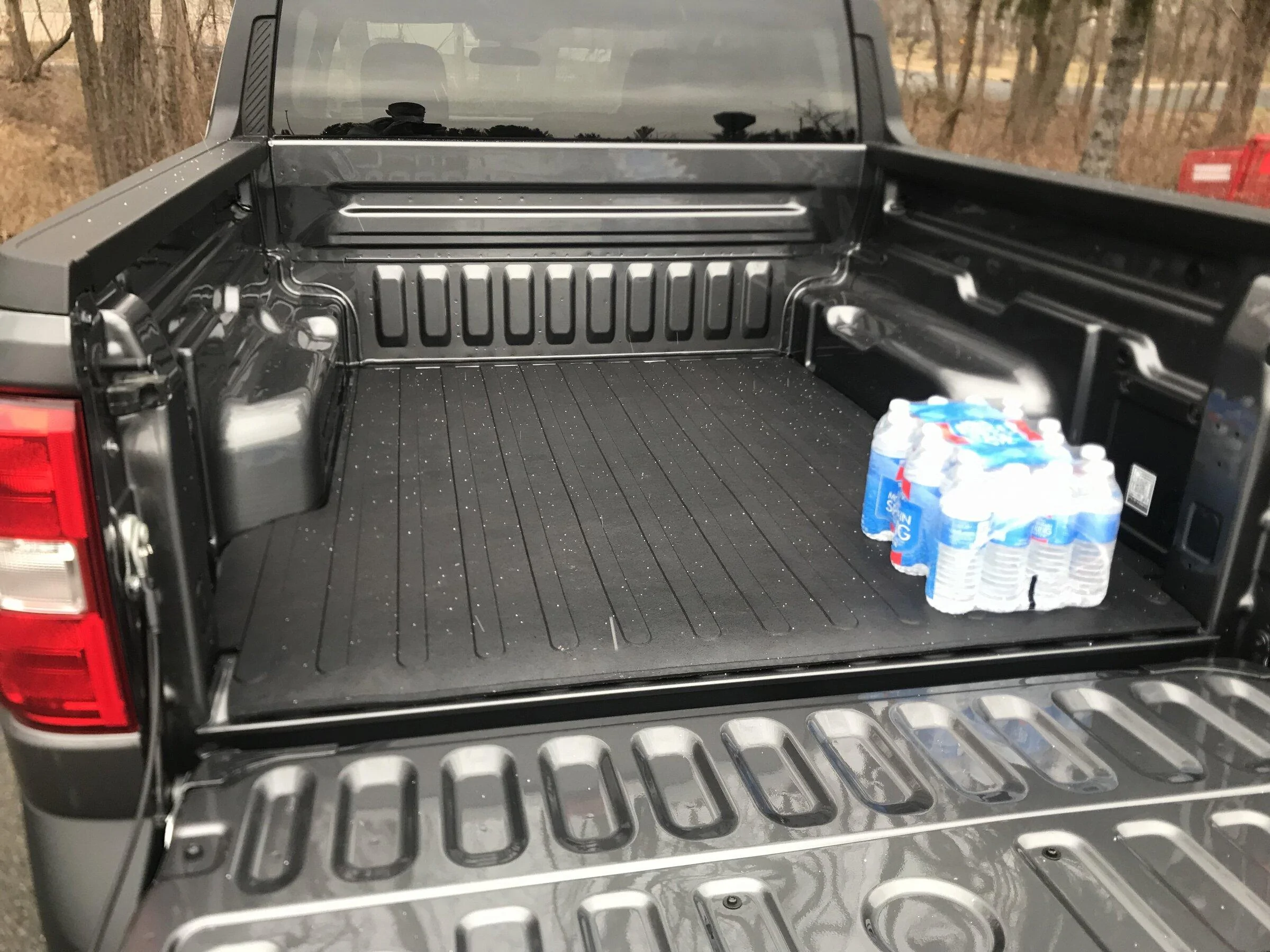

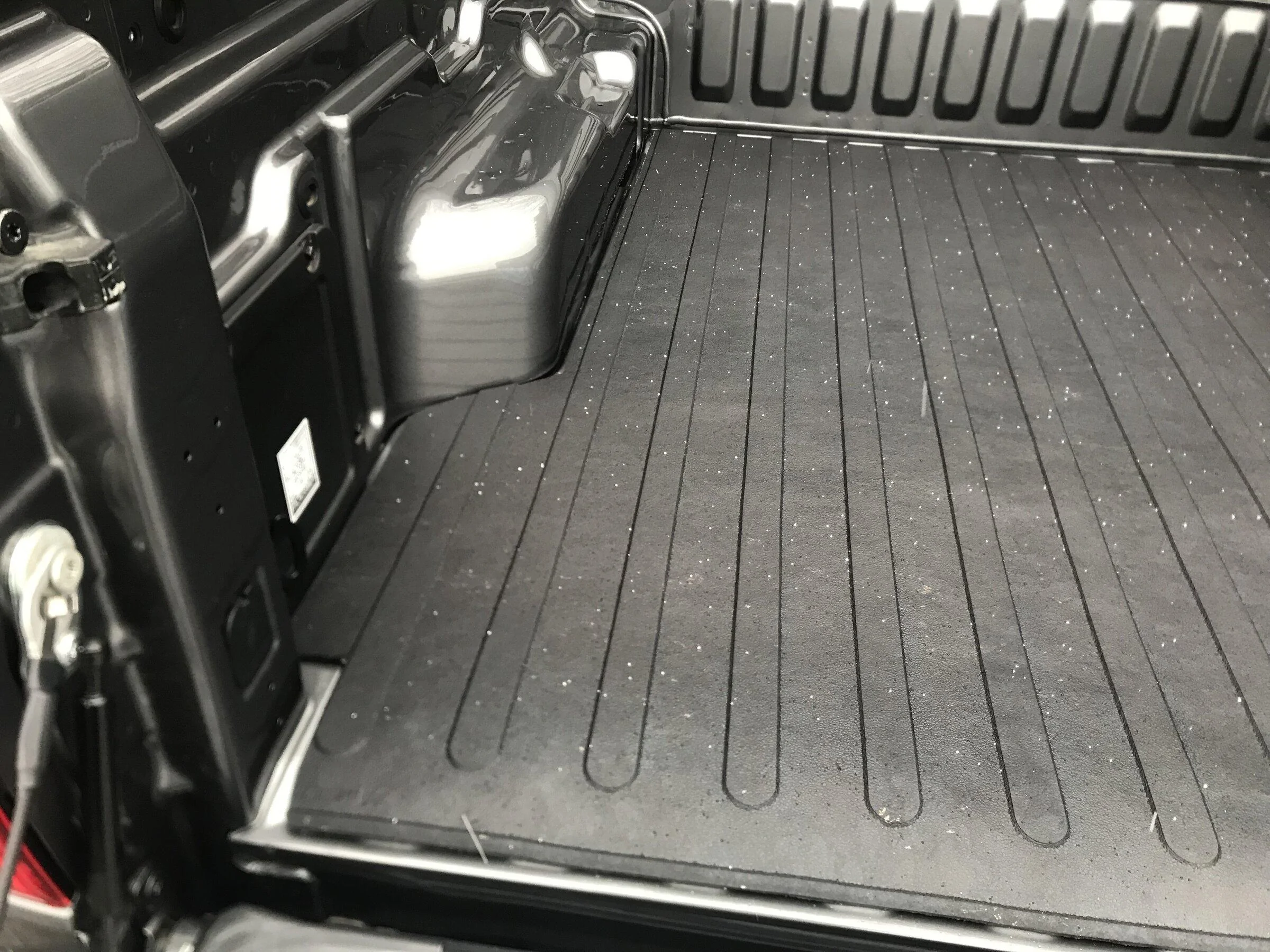

My dealer told me the Maverick rubber mat won’t be available for a while — possibly months from now — so I bought a Westin 3/8” rubber mat for a new Ranger on Amazon and made it work. Cost was about $100.
You’ll need a measuring tape and new blades on a utility knife. The whole project was 40 minutes and it’s perfectly trimmed to size. I hope this helps anyone out there wanting a rubber mat but can’t wait for Ford or aftermarket options. If you take this on yourself, make sure the blade is new; the mat has threads inside like a tire, so sharpness is key.
