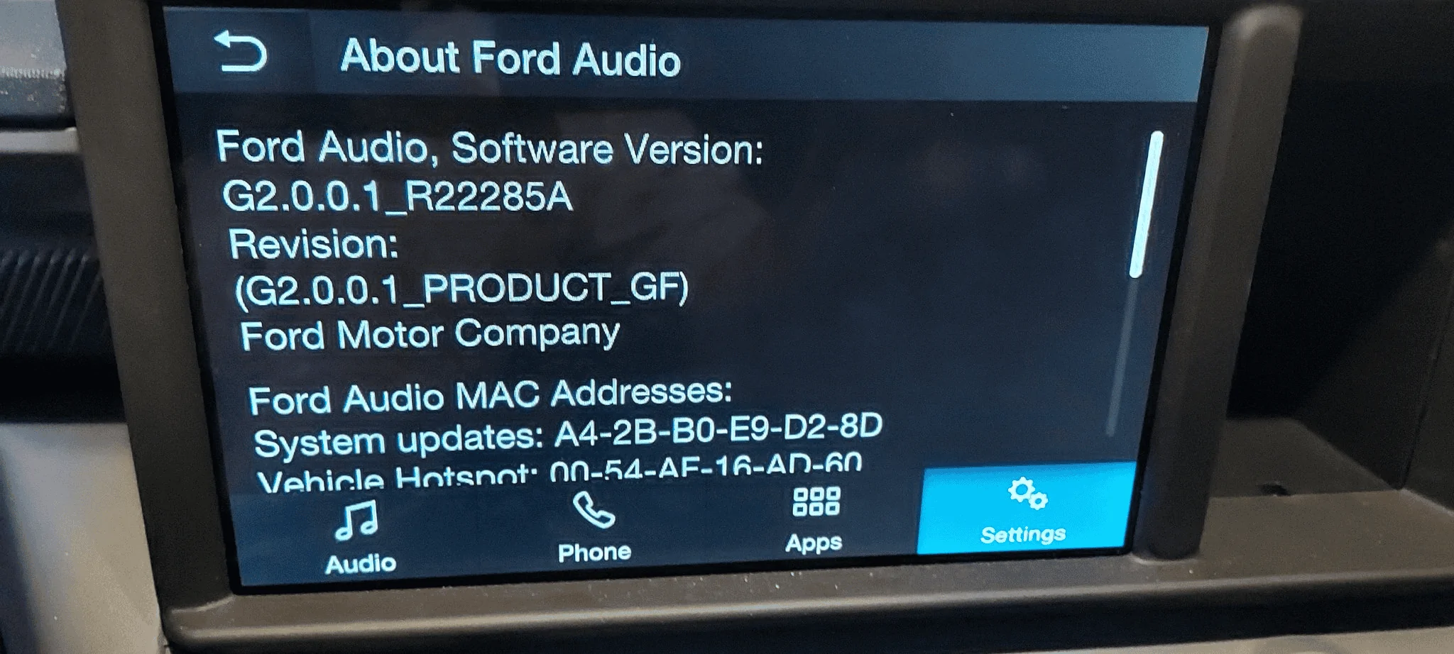

That's what mine says but when I goto 'Scan for Updates' it gives me a status bar. It did go to 100%. and I thought Maybe try to see what changed. The same version number and says installing. Maybe give it 30 minutes..
This is what it says after update.
Thanks, grabbing the update now. Finally, there's a new update lol
