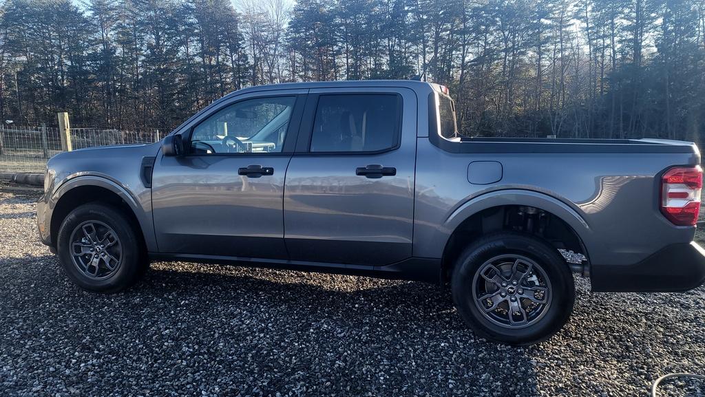

Ford Maverick Questions on Bronco Sport wheels install for Maverick 20220208_163351
