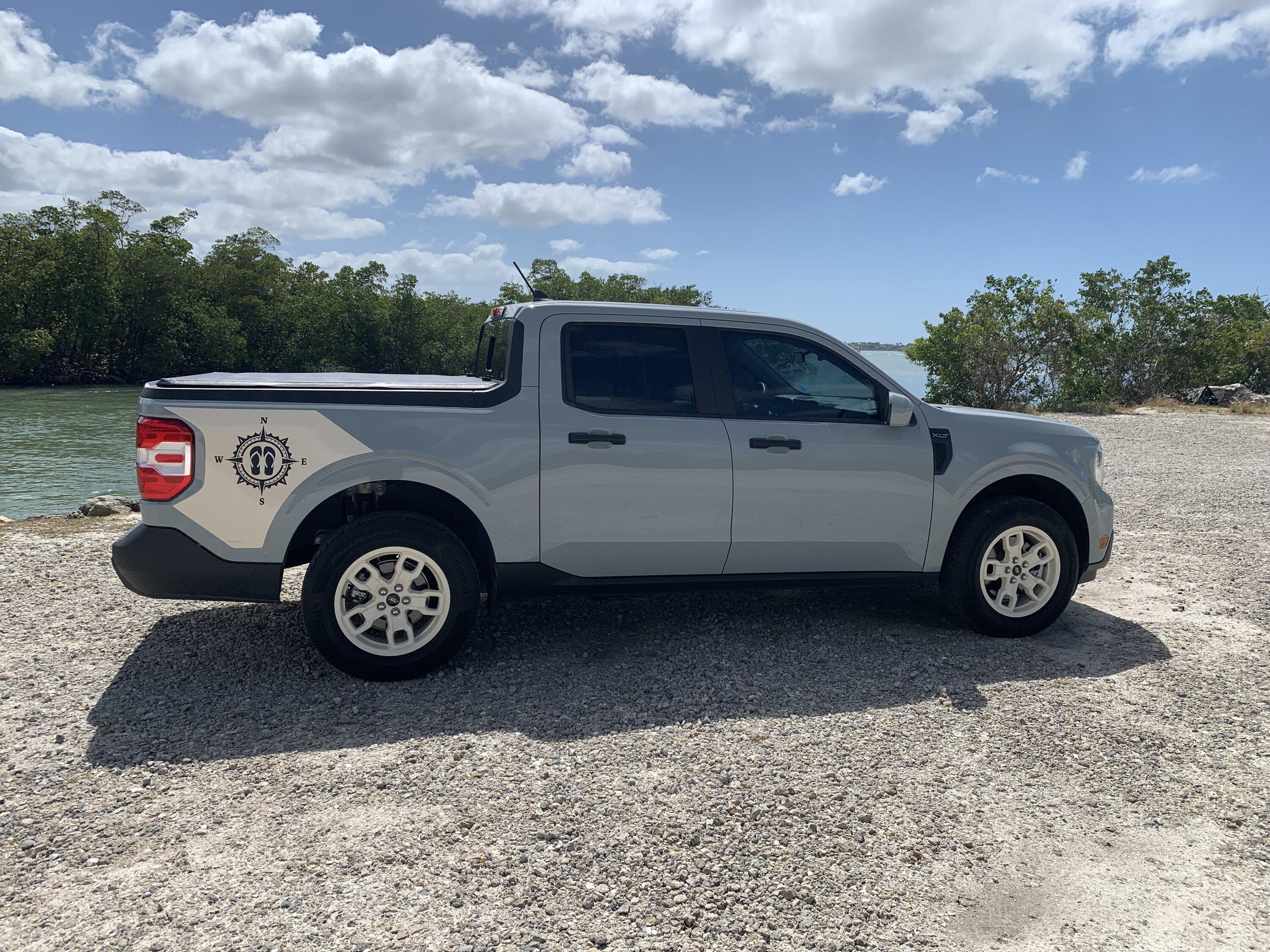

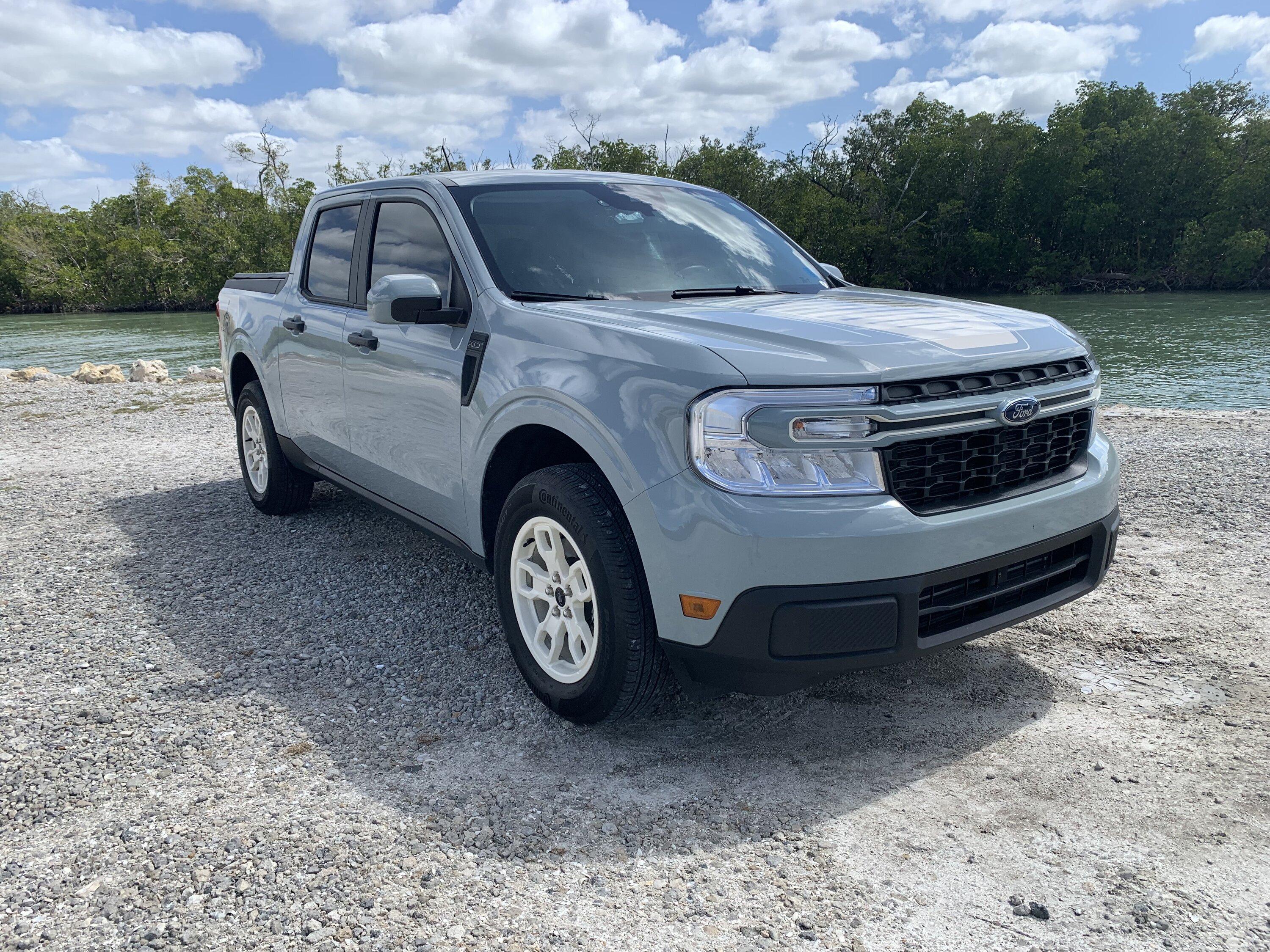

My Bronco Sport Big Bend wheels bolted right up to my XLT. Used the Maverick stock lugnuts and they are fine. I did provide new TPMS sensors since I will run winter tires on the old rims.
