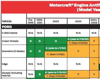

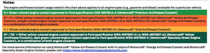

Incase you are interested in what can and should not be mixed, or used, per Ford anyway.
www.fcsdchemicalsandlubricants.com
https://www.fcsdchemicalsandlubricants.com/quickref/coolantsEN.pdf
