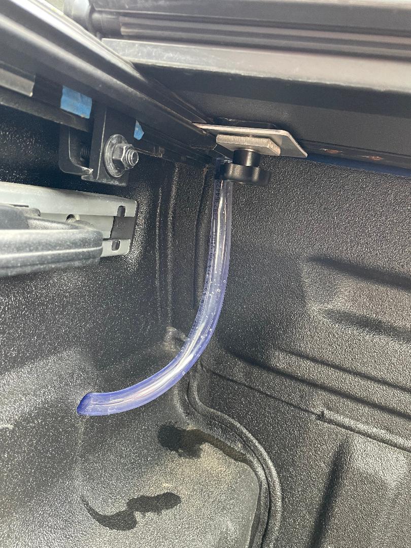

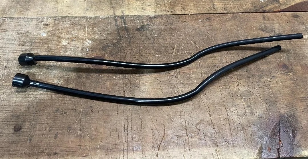

If you have an older MX4 tonneau cover, and it came with the necked-down drain tubes, you might want to look at them. Realized I was getting more leakage than normal, popped one off and the funnel was full of fumunga (dirt), completely blocked. Looks like they've changed to a full-diameter drain tube, off to Menards for some 5/8" ID x 3/4" OD tubing. It's a tight fit in the bedside hole with the grommet removed, at least with the SIBL.
HRG
Ford Maverick PSA- older BakFlip MX4 drain tubes MX4 drain tubes original
Ford Maverick PSA- older BakFlip MX4 drain tubes new drain tubes
