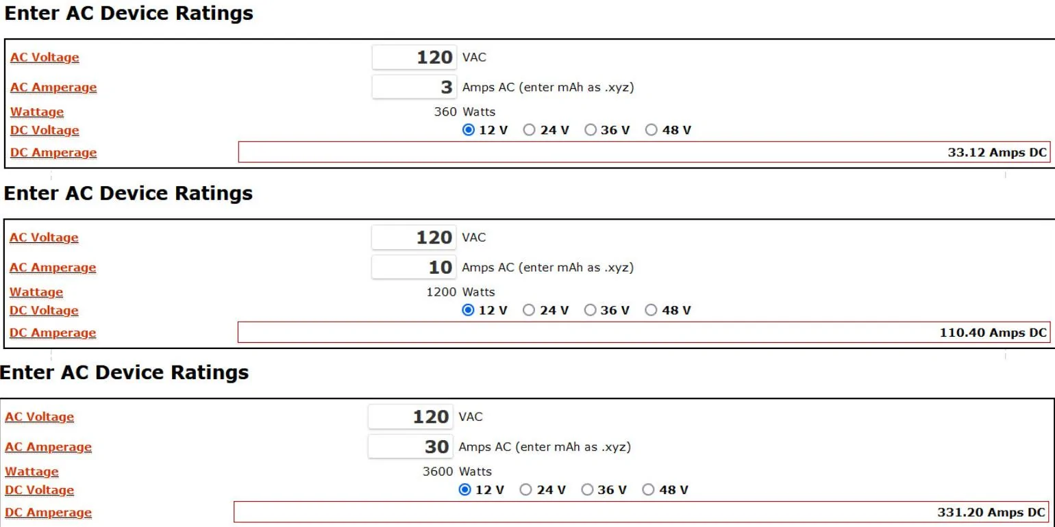

After reading through many threads on this subject here I haven't found a clear answer for my question.
What I would like to know if I can use a 4000 Power Inverter that plugs into the round power source in the front center council of cab?

Yes a typo. Well, no use carrying one around anymore than. Thank you very much.

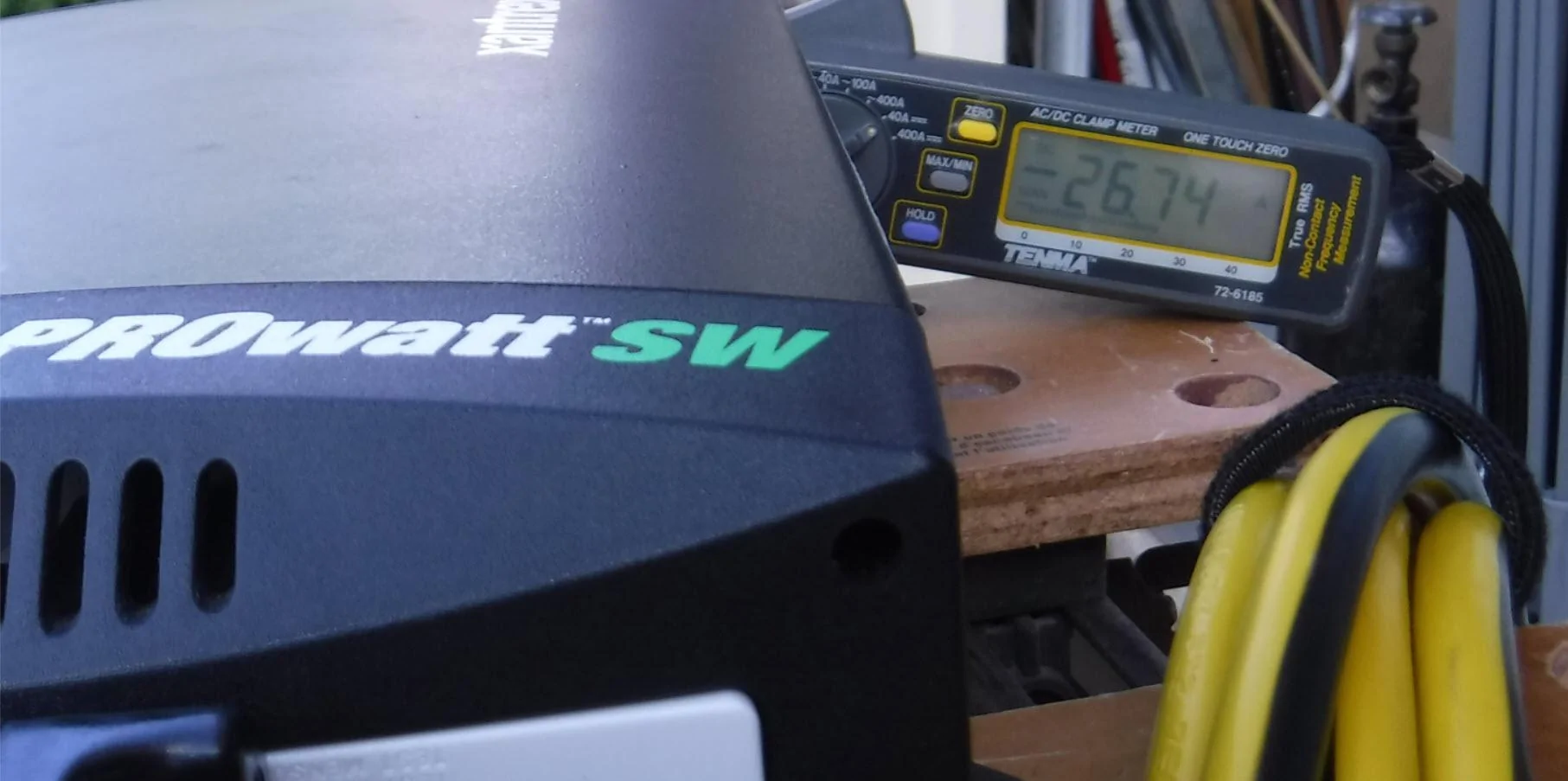

A 400W inverter will run from a 15A 12V socket. Just be careful to plug less than 150W appliances into it. Higher loads will inconvenience you with a blown 15A fuse.

You can use the 400 watt inverter if you connect directly to the battery.
Nice I will work on a way to get that accomplished so I can use a drill or small electrical tool when at the ranch.
Thank You!!!
