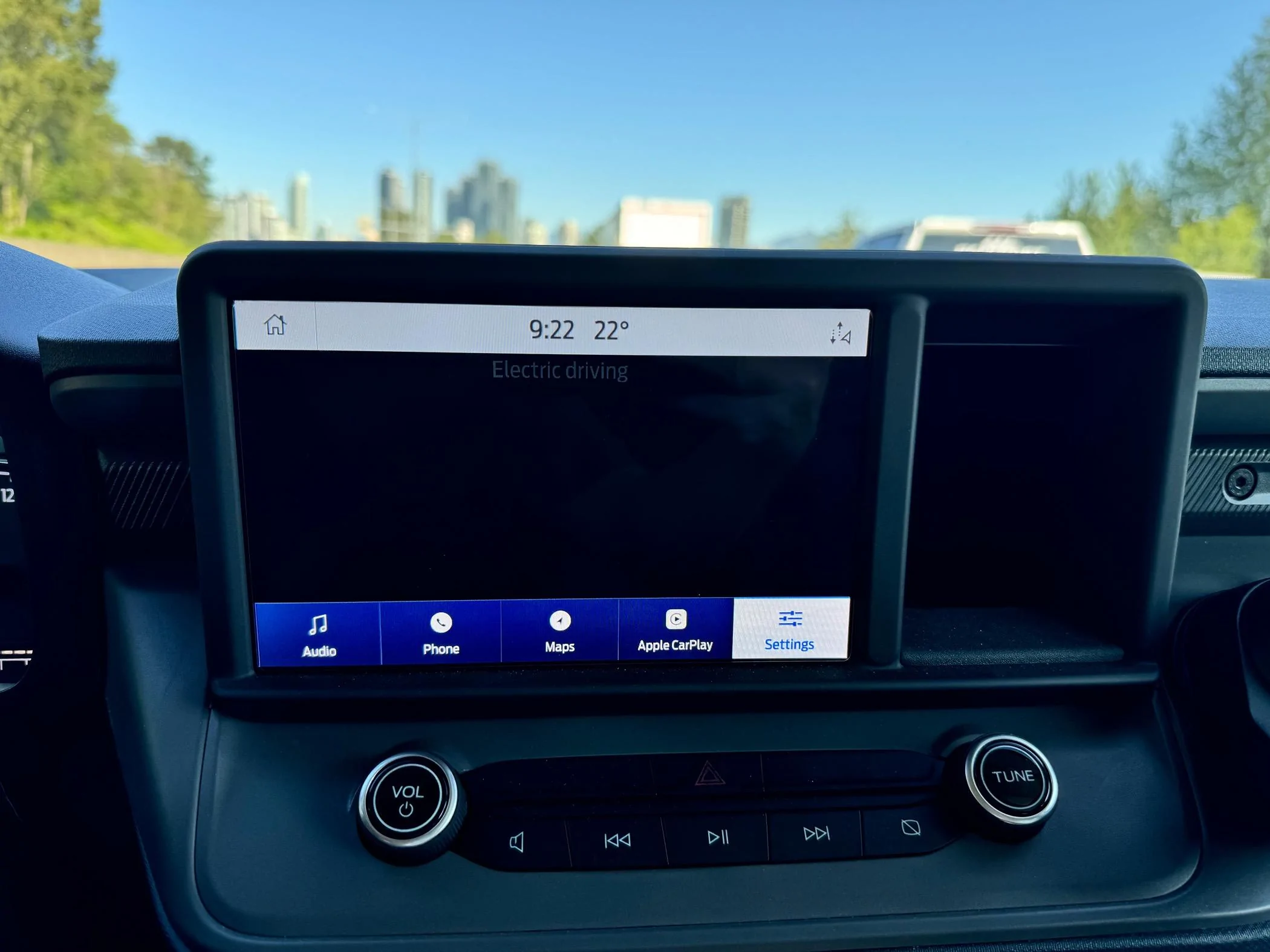

Anyone have this happen where the power flow app doesn't show the truck graphic just the text?
I don't know when it quit, maybe after the last recall/update or maybe something I did in Forscan. I've been trying to search my USB while moving. I changed everything back to stock but it still doesn't show the truck graphic.

It seems to me that a recall has caused this issue. I see one setting in the APIM for power flow type but thats it and I doubt you ever changed it with forscan. I think this blank screen issue is specifically happening on lariat hybrids after recalls. Check this link out. F150 powerboats lost this same power flow screen after getting recalls done.

@ryan2366 also lost this screen and he has a lariat hybrid maverick as well. Here is a picture. I believe that this screen is blank due to ford's updates/recalls. :cautious:

I still get the information very subdued telling me if I’m idling, electric driving, etc. the graphic for my blue (not grey) truck has disappeared replaced with the black screen.
I just had my 3 recall updates done on June 13.
Wish I could change the truck to grey if it comes back. Minor annoyance though.

Dealer did some kind of reste on the apim and it works again.

fixed, dealer did an update on APIM
