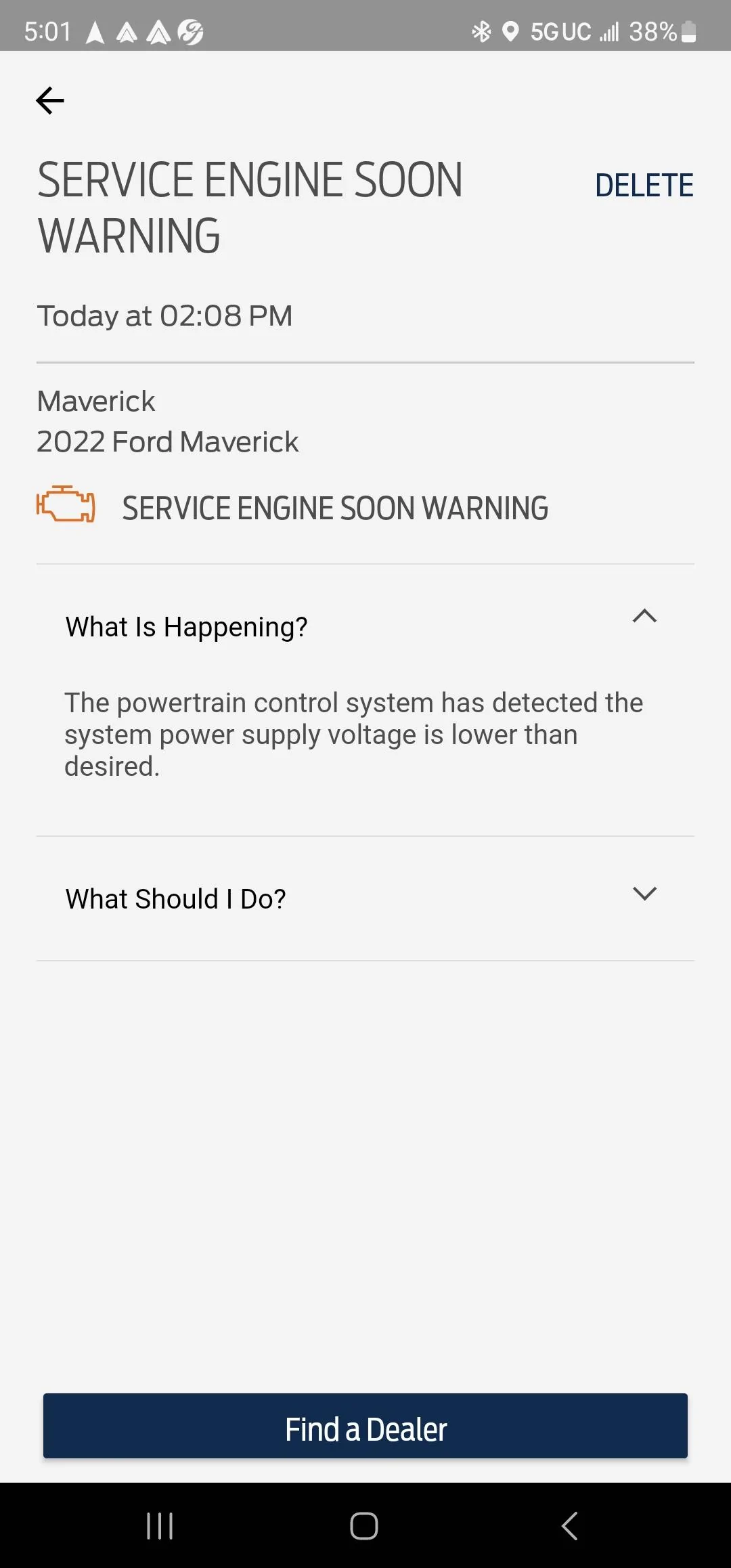

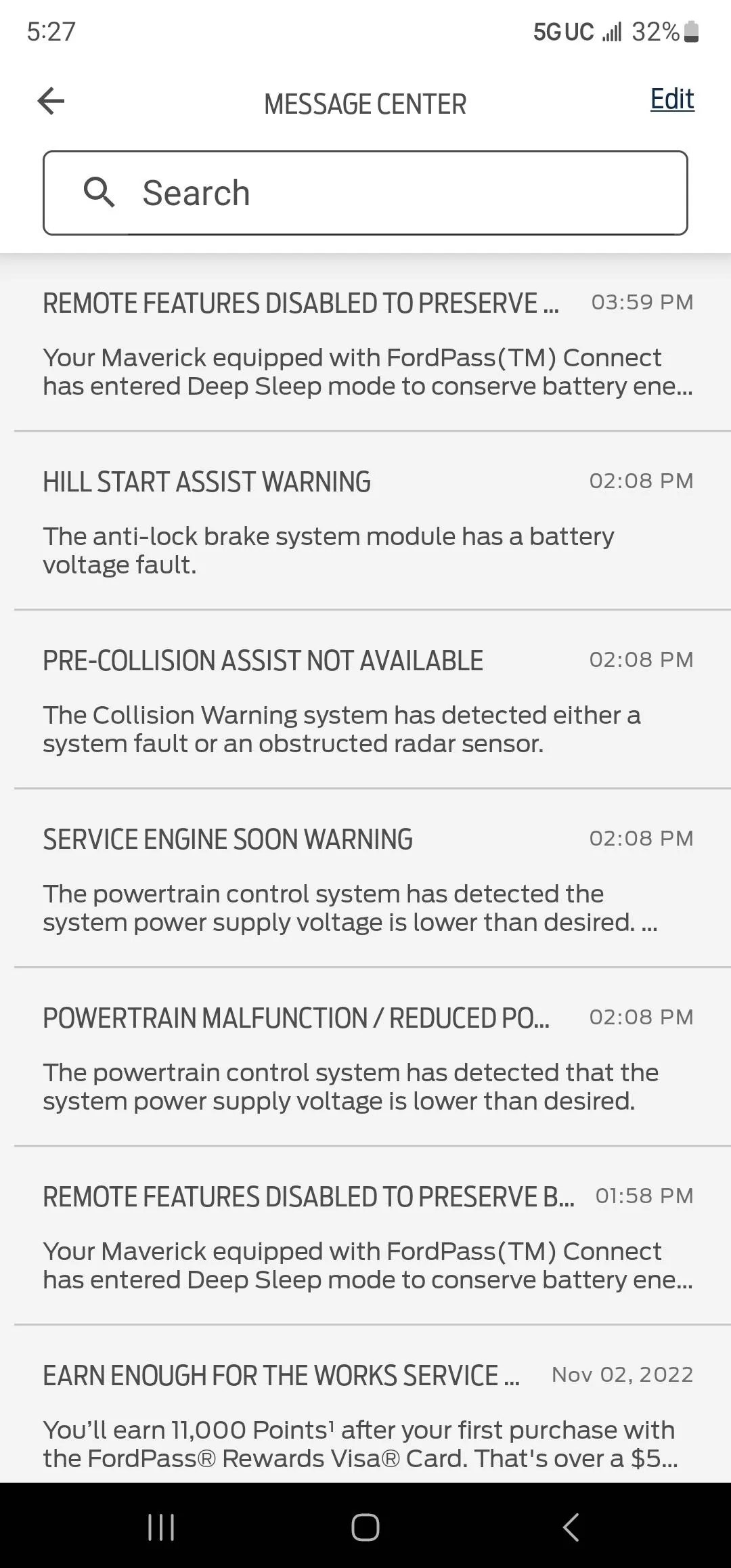

I get all of these warnings after starting my HYBRID Mav after the SEMA show. It was on display there with some added accessories that are absolutely great that i will post later.
But my concern is that the engine light is also lit on the dash and all of these warnings.
Would it be because the 12V battery is low?
Should i just drive it for a long time on the freeway to charge it back?
Help os mich appreciated!

A weak battery can set off all kinds of warning lights on todays vehicles…. Charge up the battery.
Rivers90
Ben
Jul 17, 2021
821
1,050
XLT Tremor, Miata
When it was on display too much power may have been used with the engine not running and the battery was run down over a couple days.
Charging the battery may fix it.
Put the battery on a charger or drive the truck for an hour with it in tow / Hall mode.
There is a chance the battery was ran too low to recover and then you would need a new 12v battery. But just try charging it first.
