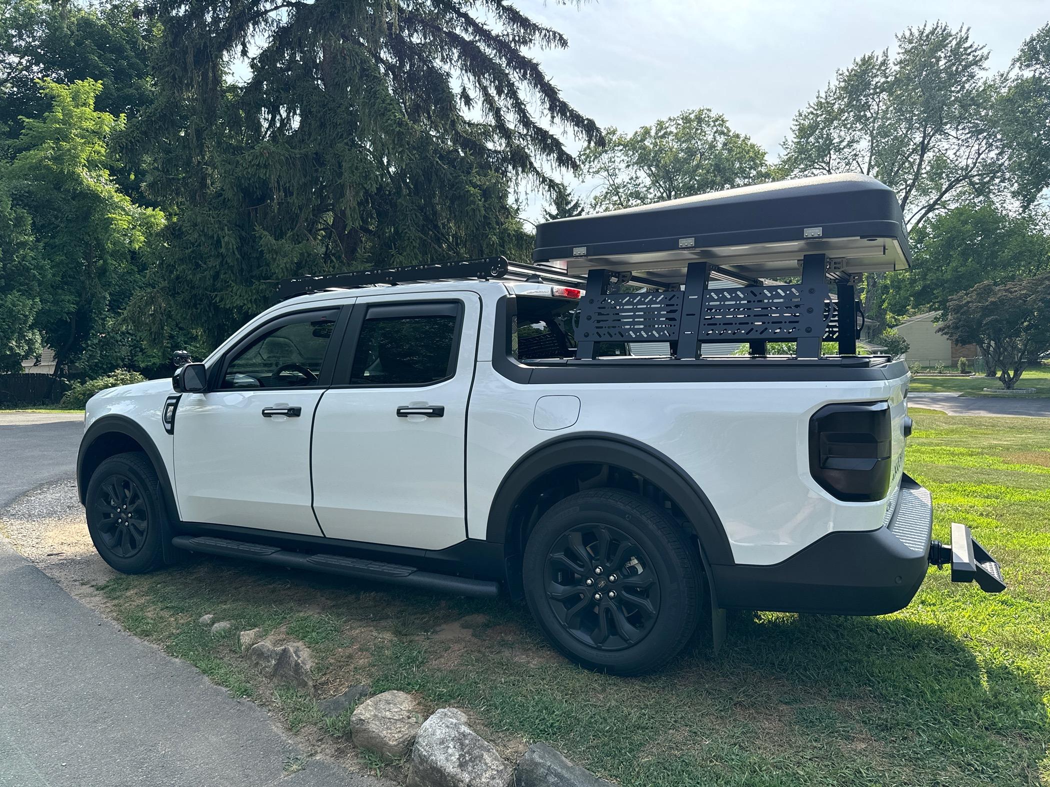

I noticed you have the Mabett side market lights. After I installed my own side/turn indicator lights using components, not a kit, I noticed more "noises". Turned out, when I installed my side lights, I moved the black noise cushion and didn't shove it completely back into place. Check your noise cushion in the fender to see if it is in the original place. That cuts down on the regen etc. sounds that gets into the cabin.
all of my installations of aftermarket parts were done by myself, a professional installer so the noise is coming from the hybrid car and not my upgrades.
And
This is the response that makes the most sense. I did move that foam around a bit and didn’t know how to seat it back because didn’t know what its purpose was for. All the other sounds everybody is describing I easily ruled out before making this post.

RE: Seat the noise cushion = Gently pull it upwards. It seats just about where the fender emblem is.
As I wrote, I noticed increased hybrid sounds after I did my install [I am not a pro installer] so that was my clue b/c I pushed the insulation out of the way when I drilled the 3/4" hole for the LED light
Obviously, do that on both driver and passenger sides. Let us know if that helps.
