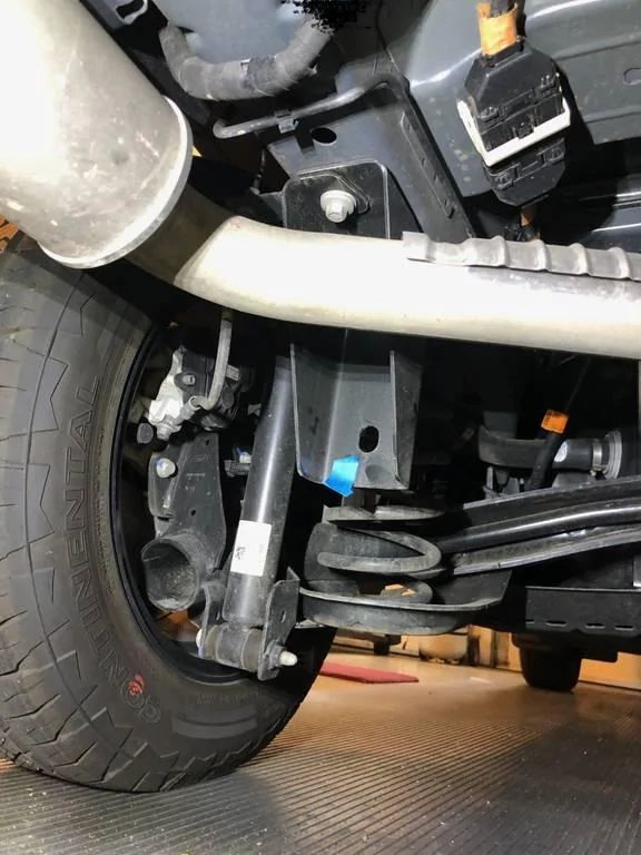

was not designed for tie-downs or recovery hooks. Recovery tie-down provisions are designed into the frame rails in the form of oval holes.
A proper 'tie down' attachment would not place the threads of the attachment in shear, it would place the bolt in shear. So I would agree this bracket may serve another purpose. I would find another load point

I saw a video where a Tuner, had the underside of the hybrid uncovered, he was going over the fine points of the build, his take on the hangydown bracket was to divert the exhaust system away from the gas tank in the event of a rear end collision, hence the saw tooth bracket behind the spare tire all designed to absorbed the impact.

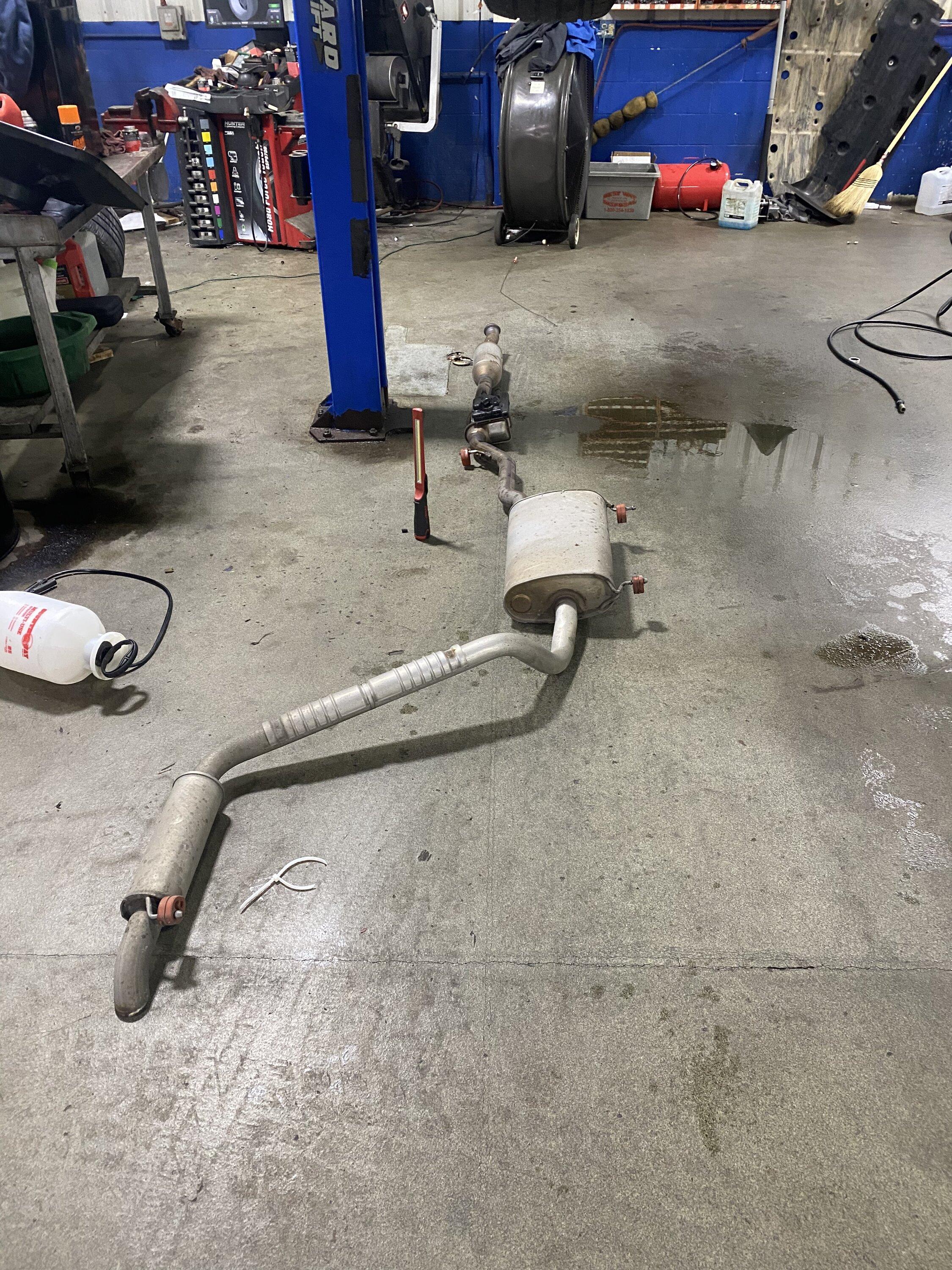

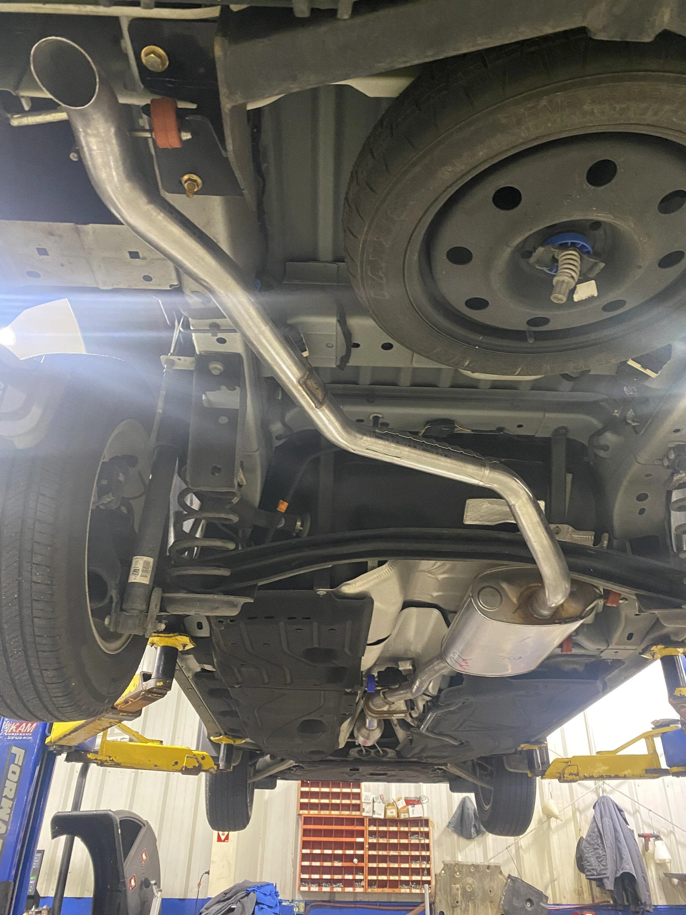

Ah... but there's also TWO different tail pipe designs. Two different styles of resonator / silencer used. This changed late in 2022 IIRC.
A few more posts can confirm this hypothesis: for whatever reason, the bracket is only present in the older style of tailpipe?
Early Maverick Tailpipes have that fat part at the end, and two heat shields near the "bracket" and wires.
Ford Maverick Please Check for Hybrid Under-Bed Tie Down Brackets 1687377203839
Later model Mavericks don't have the fat part at the end, one heat shield instead of two and have a "patch" style resonator / silencer.
Ford Maverick Please Check for Hybrid Under-Bed Tie Down Brackets 1687377344423

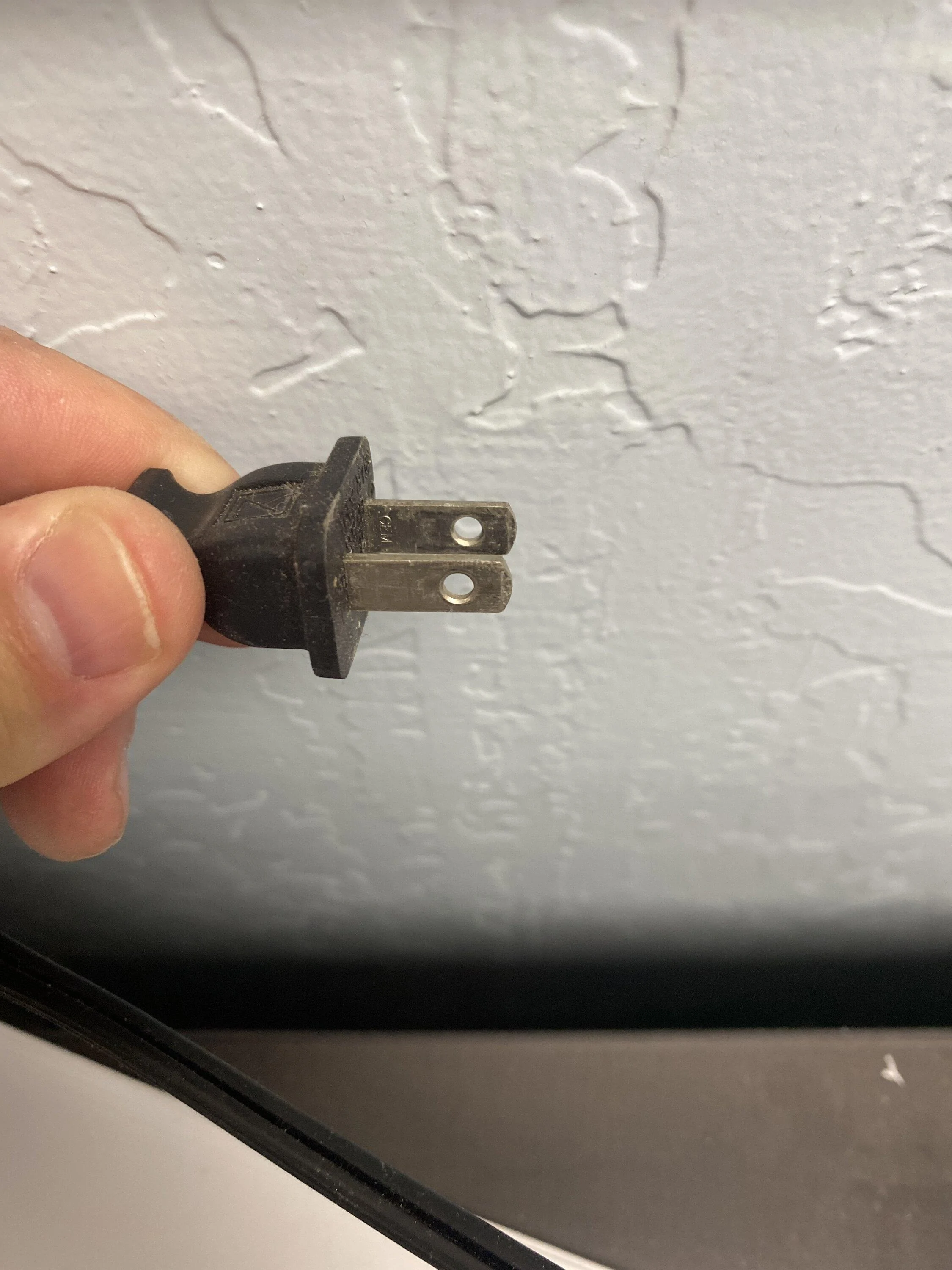

Like this: Do you know why plugs have holes? Has nothing to due with rules, codes, or safety. It's all so a machine can properly hold the pins in the mold during manufacturing. 💡
Ford Maverick Please Check for Hybrid Under-Bed Tie Down Brackets imag

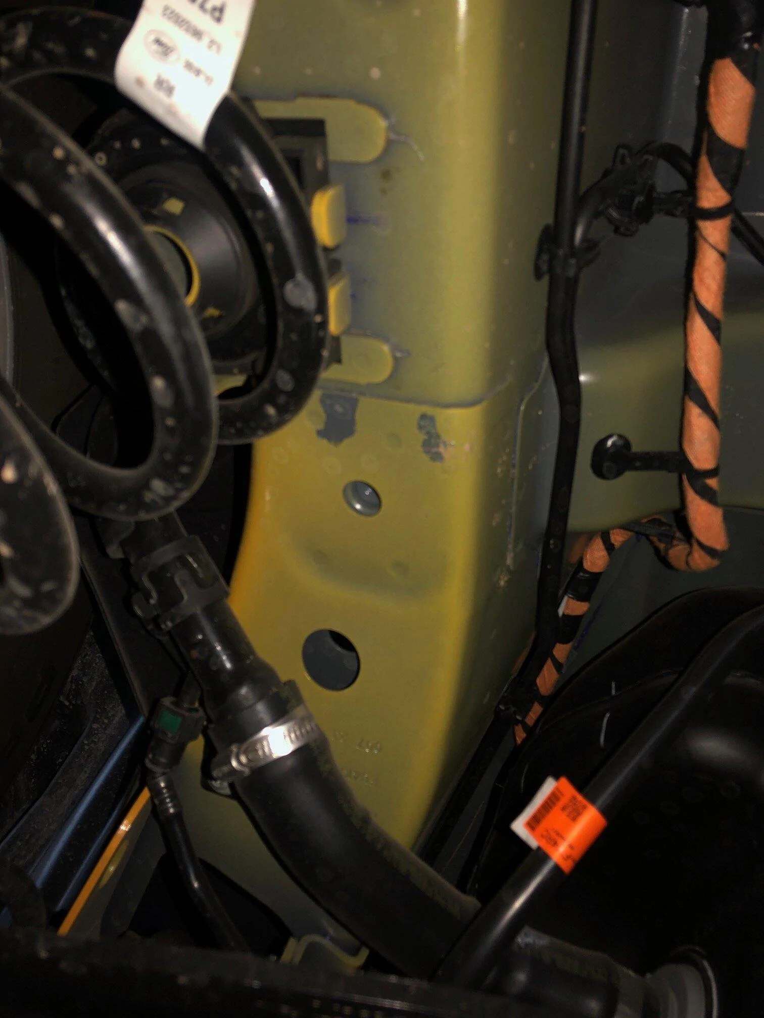

Nothing on either side of my 2023 XLT Hybrid.
Ford Maverick Please Check for Hybrid Under-Bed Tie Down Brackets Left rear mount hol
