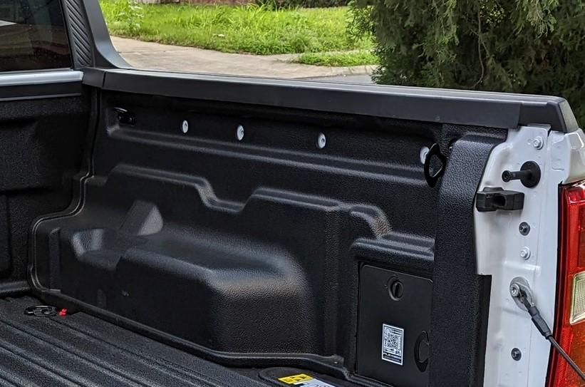

The four threaded holes on each side of the bed are M8 1.25
Ford Maverick Thread size for tie down points in the Maverick Flex bed? Bed Threads

These fit perfectly in the four holes on each side, and the four holes toward the cab.
M8 x 25mm Hex Head Screw Bolt, Fully Threaded, Stainless Steel 18-8, Plain Finish, Quantity 25 https://a.co/d/dvIEBBu
I originally got the black coated ones, but they starts to rust after the first rain storm. Chinese stainless steel!
