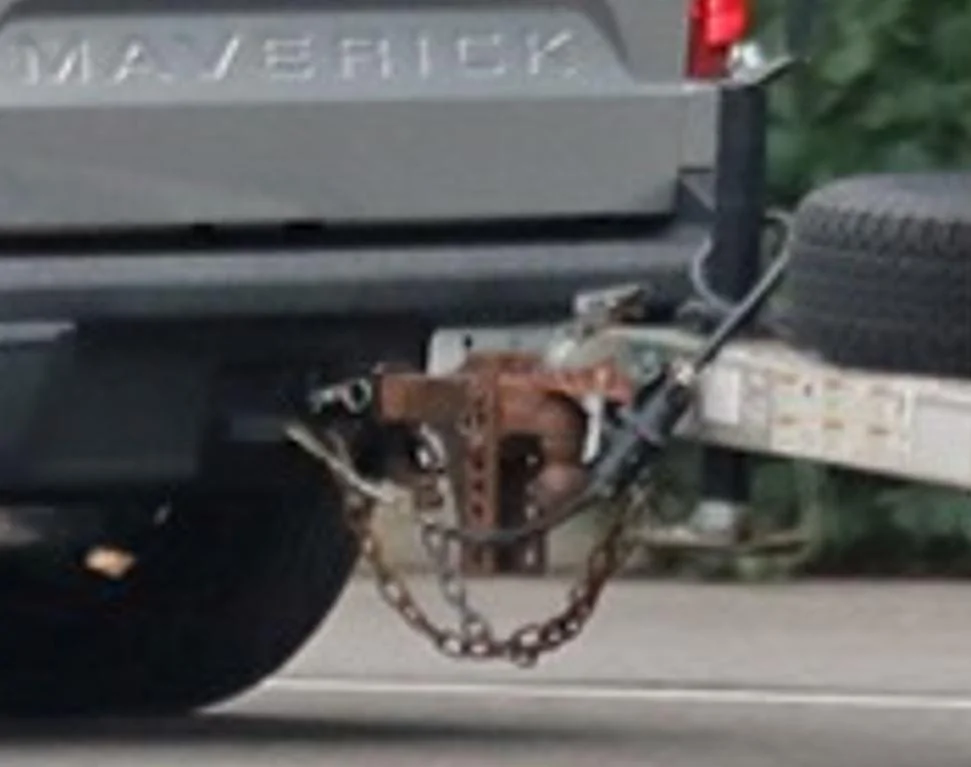

I'm seeing what is probably a 4-pin to 7-round RV adapter.

That's what I was seeing as well. Wouldn't that mean they are bypassing the trailer brake of the trailer? I'm far from a towing guru so not super knowledgeable on what that impacts on the trailer side.

Correct, but if the trailer, as-loaded, did not exceed 2000#, not many people would be using electric brakes on the trailer anyway. U-Haul doesn't put their surge-brake system on trailers until you get to the tandem axle 6x12 units.

You would think they could afford a hitch that wasn't rusted out :LOL:
Who cares, its just surface rust on thick ass metal. For testing. I got a Hi-lift jack that sits exposed in my comanches bed. It was rusted out when i got it out of a jailbirds storage unit in 2009. I use it atleast once a week and its handle twice a week.
