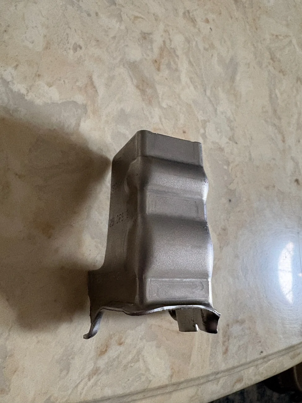

@DS_Ohio you nailed it, here is a picture of the bolts they use and of course the round part is what’s left after the install and they head is broke off after they torque them.
That's diabolical! I'm having the dealer, install my perimeter security system for less than $70. It's on order now.

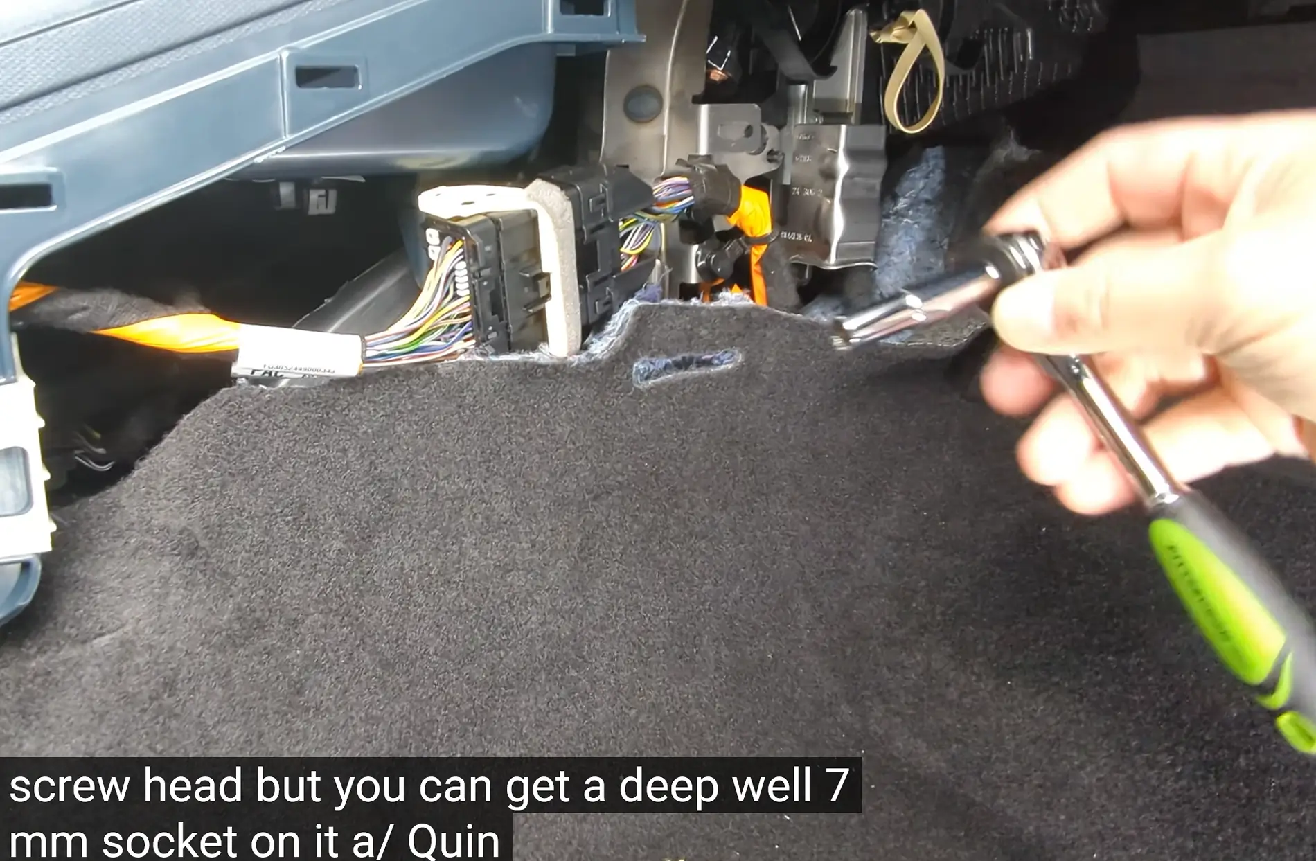

Do you have any tips on how to remove the security screw?
