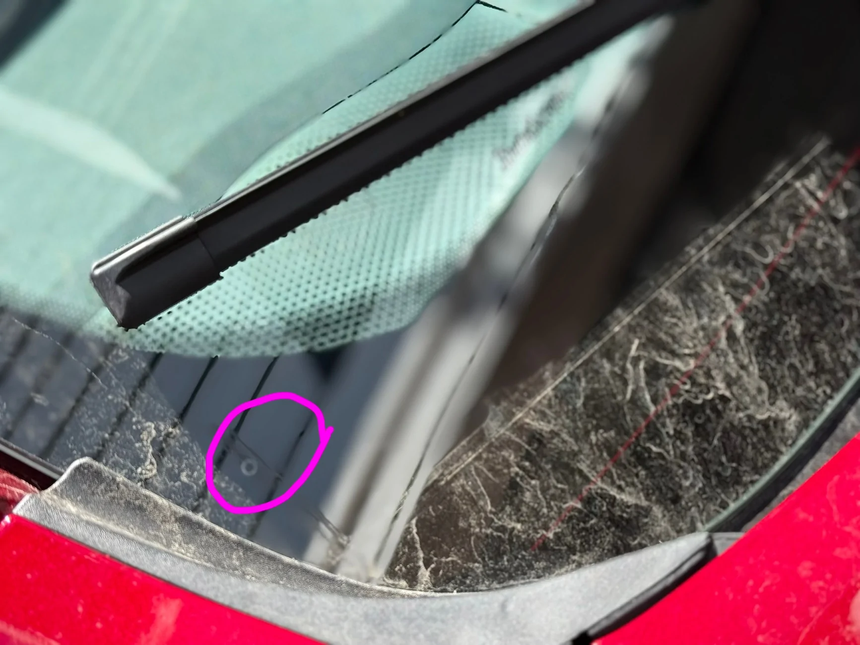

This is my third Maverick and unless I’m losing my mind I don’t recall this being an issue. This is a 2025 lariat hybrid. The passenger side wiper blade will no longer return to its usual home position when you are done using the wiper function it no longer does that little drop to the off position if that makes sense.
I read the wiper should be at the dot on the glass which I circled in pink. Mine is definitely above.
Just curious if anyone else has this issue or if there is a no one DIY fix without time at the dealer. I believe in letting them fix anything that’s wrong since it’s under warranty, but it does take a lot of time for something that might be really simple.

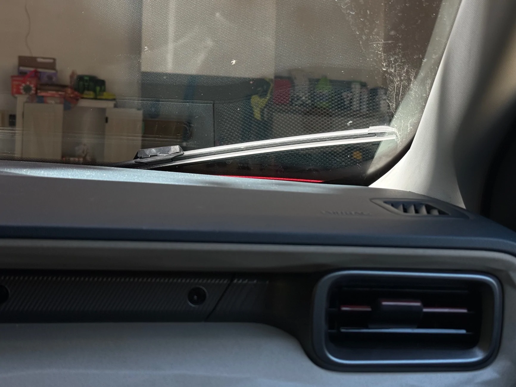

first picture is the dot on the windshield and the other picture is how it looks from inside of the cabin
Updated post with video of issue. Note it doesn’t return to home/rest after use, after the final “courtesy wipe”

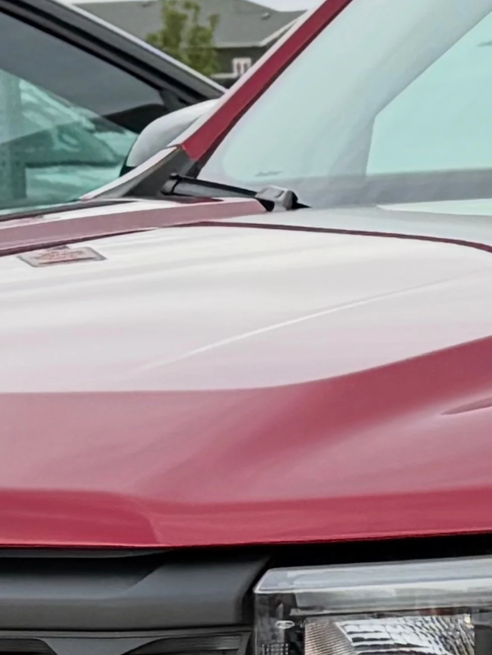

I took a picture of truck the day I purchased this Maverick and went back to look at — when you zoom in you can clearly see the wiper is in a normal position. now I’m curious what is causing it? I did just complete the software recall updates for the trailer and the parking module- or whatever it was.
Ford Maverick Passenger Wiper Not Returning to Home/Rest Position IMG_9447

In the video I don't see your driver side wiper moving slightly down into the park position either or maybe it just doesn't show that on the video? When going into park my driver side moves down just a little and the passenger quite a bit more.
Exactly. That is the issue.
