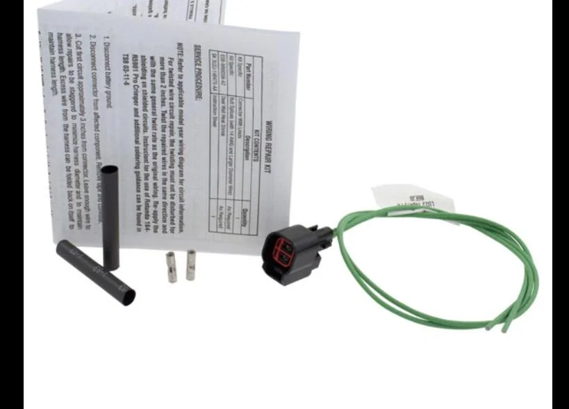

My ABS sensor on my driver's front wheel has rubbed through when the truck was lowered on coilovers and the part is not on a connector/pigtail but rather a length of wire tied into the main harness. 5900$ harness FYI. So im in search of a length of the abs sensor to splice into my harness.
Note: later years apparently Ford decided to make the abs sensor normal with a m/f connector between the main harness and the sensor. So specifically looking for 2022 Models maybe 23 is the same but have not confirmed yet.

How far up from the sensor is it rubbed thru?
These pigtails generally come with 6"-8" of wire from the connector.
This is what I used for fixing my wheel speed sensor wire. I'd say I can't believe they were dumb enough to leave the last 6-8" of the wire closest to the wheel with just black tape "protecting" it, but unfortunately I can. 2022 EcoBoost. Couple thousand miles, including a couple hundred on forest service roads driving like an ass, and no issues.
I didn't use the metal bits. I used some of the heat shrink connectors I had and the black tubing to protect the connection.
WPT-1626 is the part number.
@Racerx410 I actually have an extra one that USPS lost and then delivered after I requested a replacement from rockauto. If you want it for free, feel free to send me your address and I will send it out today or tomorrow.
It rubbed through in a section around the knuckle area. The wheel definetly rubbed it at some point probably when I had wheel spacers on if i had to guess.
That is greatly appreciated, I sent you a message.
