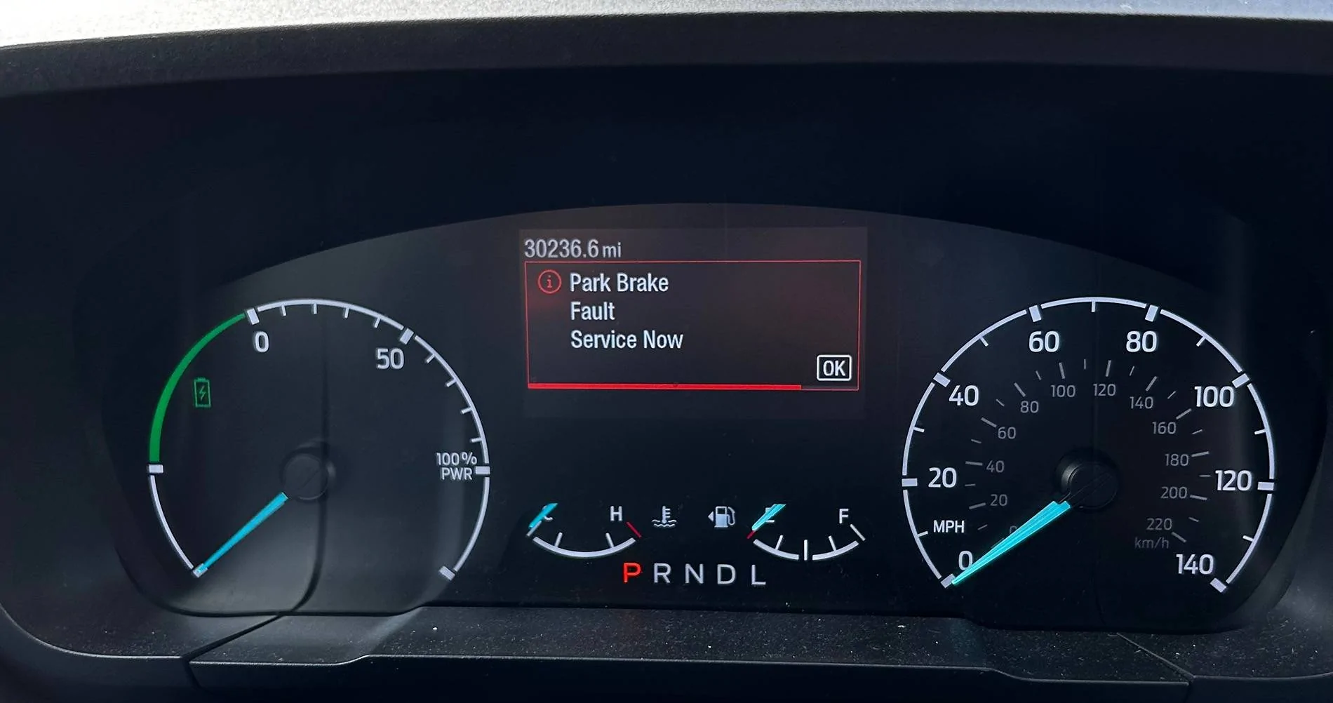

Does anyone have a fix for this problem? I can’t get into a ford dealer for 3 weeks.

Maybe. Telling us what the parking brake fault that you are experiencing is might get you closer to resolution.

Ask and ye shall receive…
Does this stoopid alarm whenever I open the door, start it up, shut it down, walk by it during the day…
I believe this issue to be the start of my dead battery fault.

Apparently, a common problem with lots of existing threads on the issue. Scroll down for similar threads or do a forum thread title search for Parking Brake Fault
As for suspected battery issues, put a battery tender on the truck overnight and see if that helps. If so, use it periodically to keep the 12v battery topped off. Or don't, and eventually end up replacing the battery, if low charge is a problem.

I had this issue and it turned out to be a broken wire in the body floor harness. car was down for the repair for a couple of days as the wire was rerouted/repaired. They weren't able to access the actual break in the wire without completely tearing out the whole interior so a separate wire was run parallel to the harness from the brake to the control unit. That was 2 years ago and I haven't had a problem since.

So I actually had this same message pop up recently. Now I'm dealing w/ a corroded high-voltage cable w/ a bad terminal connection too. I'm not saying its the same problem w/ you, but just something to ask your local dealership about.

Just an update to all who commented.
Ford did not count the wire as a part that was covered under the premium warrant I purchased the Maverick. So I got stuck with the whole bill, but Ford did take 600 off of the full bill.
